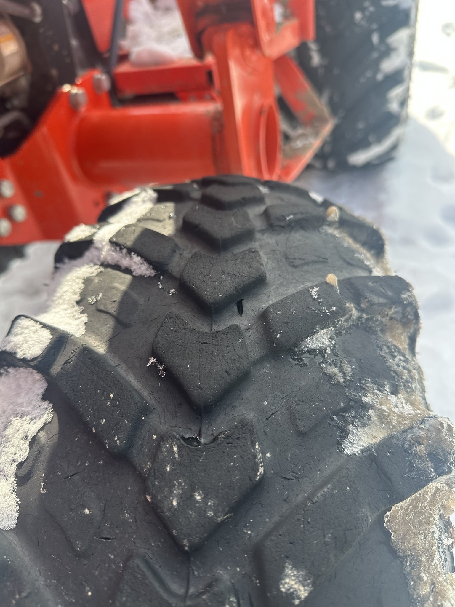

Here they are ... front and back. There are many examples on this forum of siped R4s but this is the direction I went in. Traction on snow and ice seems to be good.

Those tires on mcmxi's ride, looks more like R14's than R4's!
They look awesome!
