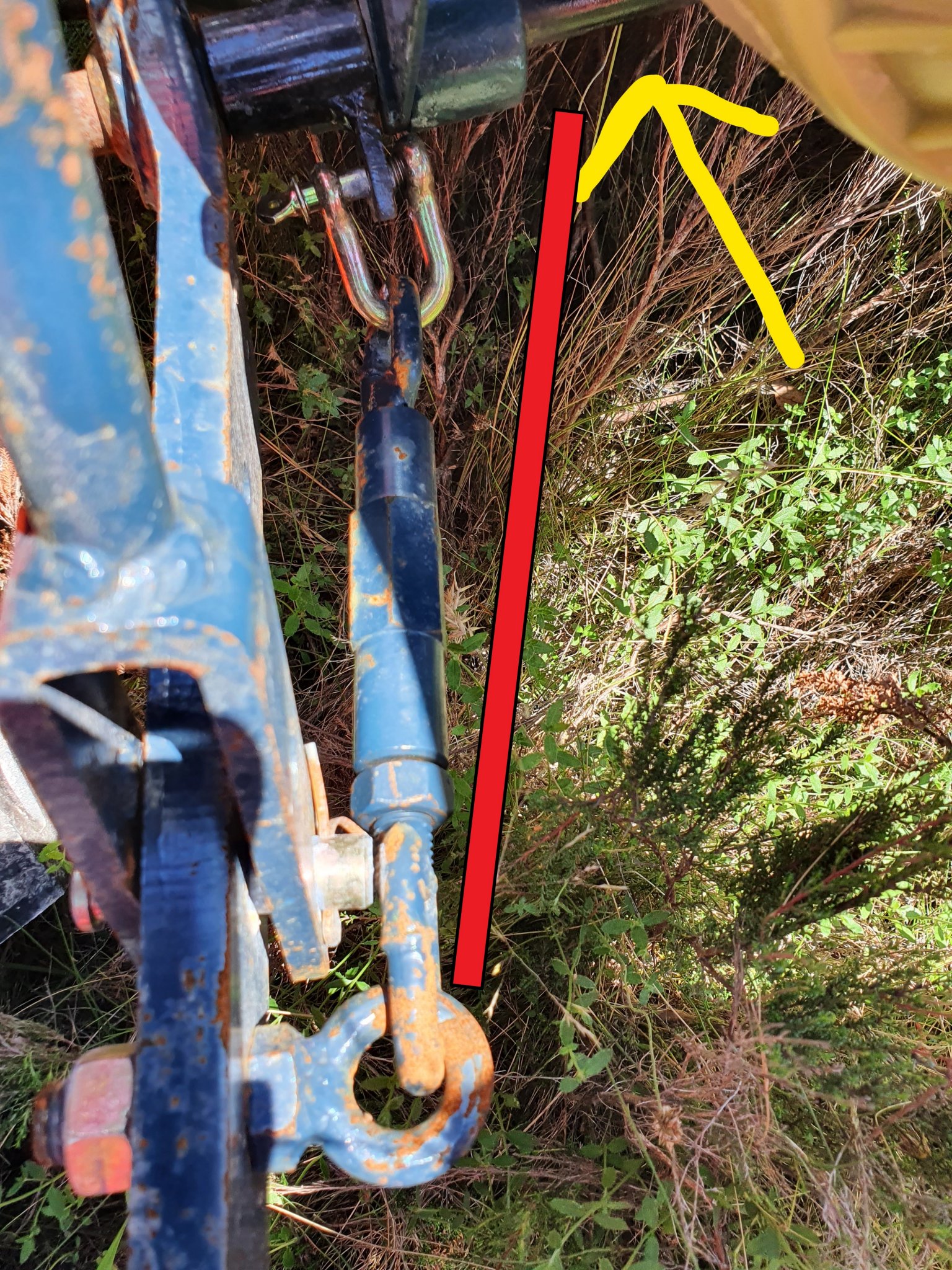

Hey guys,
Sorry about the pics below not being perfect. I'm currently separated from my tractor by a flooded bridge so I'm hoping they're good enough for the advice sought!
I'm a newby and my tractor is a remanufactured Kubota B7001 (grey import into Australia, I believe it's an Asian market model number and almost identical to the B7100). I'm pretty sure the adjustable / turnbuckle limiting arms on for the lower 3 Point arms were attached in the wrong spot when I got it. They were attached right next to the ball joints mounting the lower arms to the tractor, hence even on their tightest (shortest) setting they were loose, the implements moved sideways and the lower arms rubbed on the rear tyres. The close up pic of the left side setup shows how it came and the yellow arrow is where I moved the collar that the limiting arms attach to. I also flipped the collars over so the D shackle mounts to the outer edge of them and now the limiting arms sit about where the red line is I've drawn on the photo. It has enough adjustment and controls the movement so there is no more rubbing.
The bit that seems wrong however, is that in the previous setup, the collars the limiting arms mount to were also spacers between the ball joints on the lower arms and the tractor mounts, so it held the lower 3 Pt arms in a pretty fixed position on the tractor end. Now with the collars in between the 2 tractor mounts / tractor eyelets, the ball joints on the tractor end of the 3 Pt arms are free to move about 4cm (1 1/2") left or right. In fact if one moved inwards, the whole rod that mounts the assembly to the tractor could move across the same distance so the opposite side could move outwards twice as far (about 8cm or 3"). I used the flail mower for a few hours like that and didn't have any problems (nothing seemed to move), but it just seems like it is missing some spacers?

Hey guys,
View attachment 76570 View attachment 76571

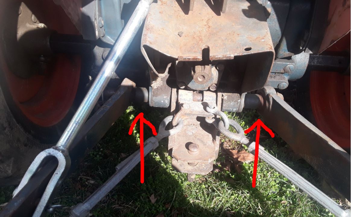

Can't say if you are missing parts but I believe the collars should be inside the ears on the tractor where you moved them. Here is a B7200 for comparison.

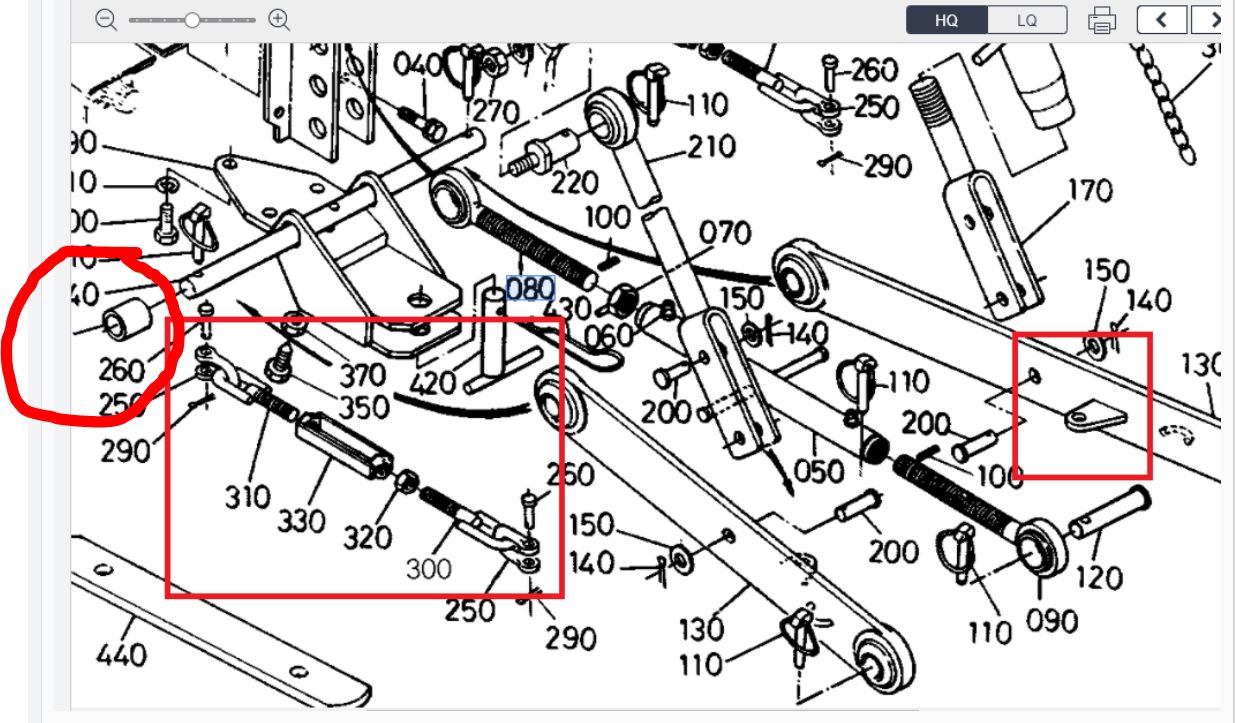

Interesting. I looked at the parts diagrams for both the B7100 and B7200, Neither match what I have on my B7200 (pictured above). I purchased the tractor with about 400 hours on the clock and as far as I know it was 100% stock. In the parts diagram below the turnbuckles are shown on the outside of the lift arms but the attaching ears are shown on the inside. There is no sign of the piece with two ears used in the center on mine. Something seems to be amiss here. Any explanations for the discrepancy?

Yes - the OEM turnbuckles were replaced when teh threads wore out. But you will find many pictures of B7200 and B8200 tractors with this exact hitch setup and the OEM turnbuckles. The B7300 parts diagram shows something very similar - turnbuckles iclearly nside lift arms.

You have aftermarket lift arms, and the stabilizers have been relocated outboard of the lift arms.

If you set it up like this pic that The Old Hokie put up it will work for you.
You'll just need to make a couple sleeves to replace the one's that are on the outside holding the turn buckle bracket now.
Thanks. Looks like you are also running without the spacers I suspect I'm missing (I suspect they should be where the red arrows point on the copy of your pic below. It looks like the ball joints on the lift arms could move left and right and if so that the rod they're all threaded onto could move?

The B7200 parts diagram you posted appears to show the spacer (circled in the copy below - although that diagram isn't clear if it sits inboard or outboard of the lift arms) and they also appear to be there as part no 130 on the B7300 diagram above (inboard of the lift arms).
Where did you access the parts diagram? They're much clearer than the pdf versions I've found for the B7100.

Thanks. I think I can now confirm that I fumbled my way through relocating the turn buckle brackets correctly and I now need to cut a couple of bits of pipe as replacement spacers for Part No 130 from that B7300 parts diagram.
The lift arms cannot move sideway because the are pulled inward by the turnbuckles. The cross pin could move inside the arms and supports put it would have no effect on the arms. No spacers needed.
Plus the diagram does not match whats on my tractor. The parts diagrams are all online at Kubota.
