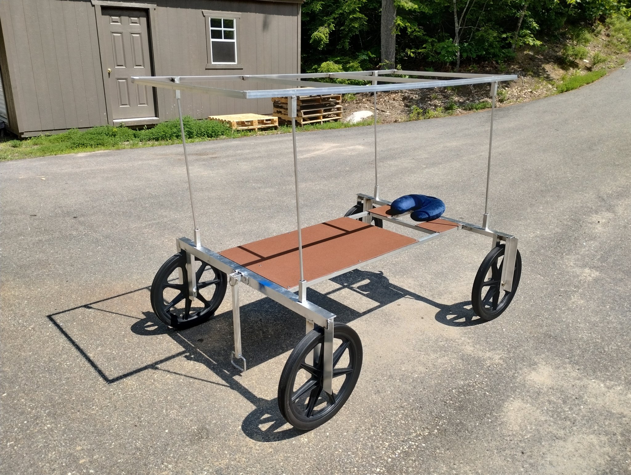

The other friday project was a weeding cart for a lady who brought me a photo of one made from wood. It looks like a massage on wheels. You lay on it. Weed. Pull yourself along with your hands...a nice lady and no water vapor talk.

The aluminum cart I used a Millermatic 210 with a spoolgun. .030 wire . It really penetrates and makes fabrication quick. 12 hrs start to finish to complete the cart.

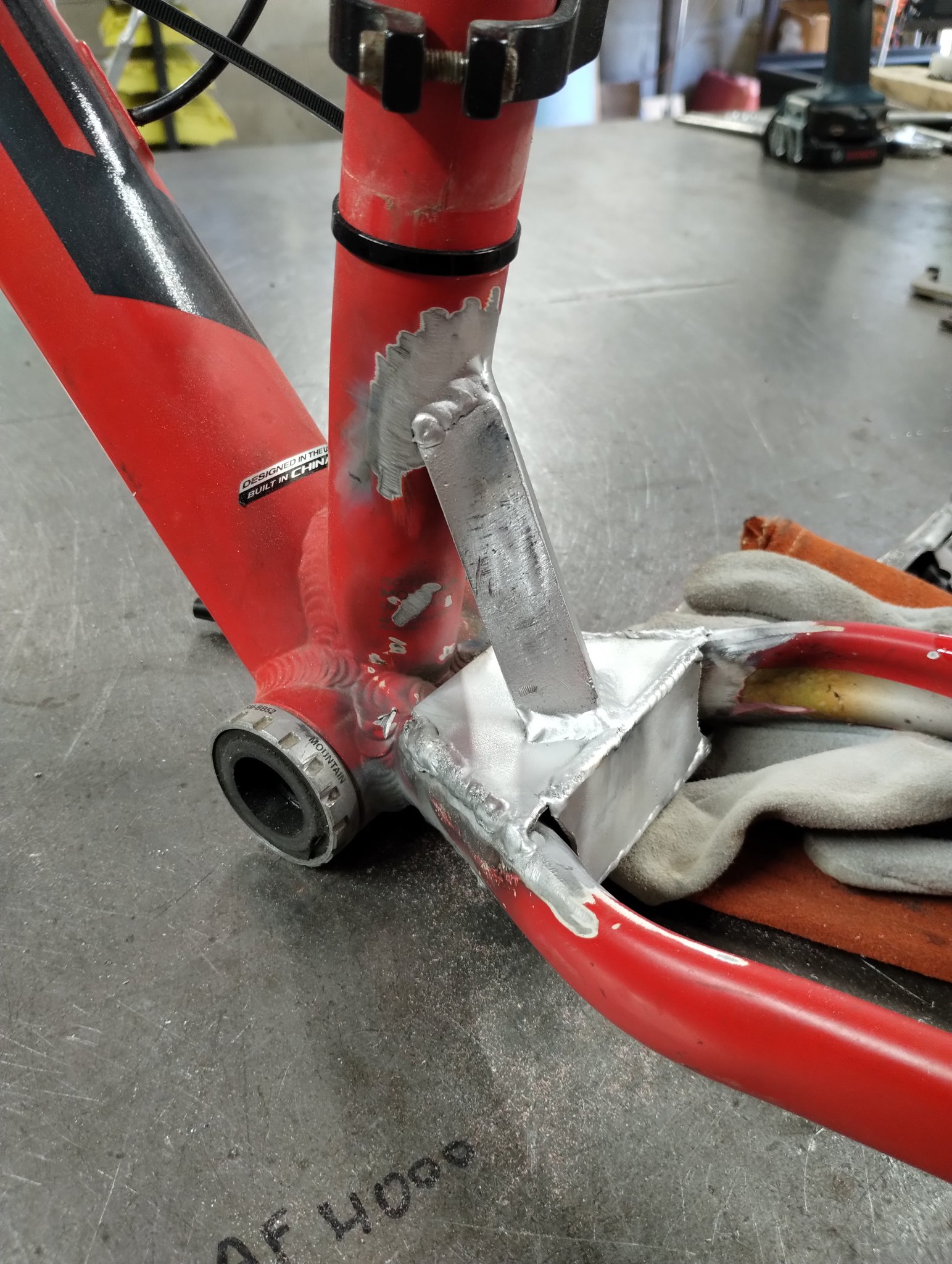

The bike frame I used a Miller syncrowave 180 with foot peddle control. The bike tube is about 1/6" thick. Prep the broken joint, clean it grind off the powercoating, align the break, tack several places, alignment is good. Weld both outsides then both insides. Then the bracing.
