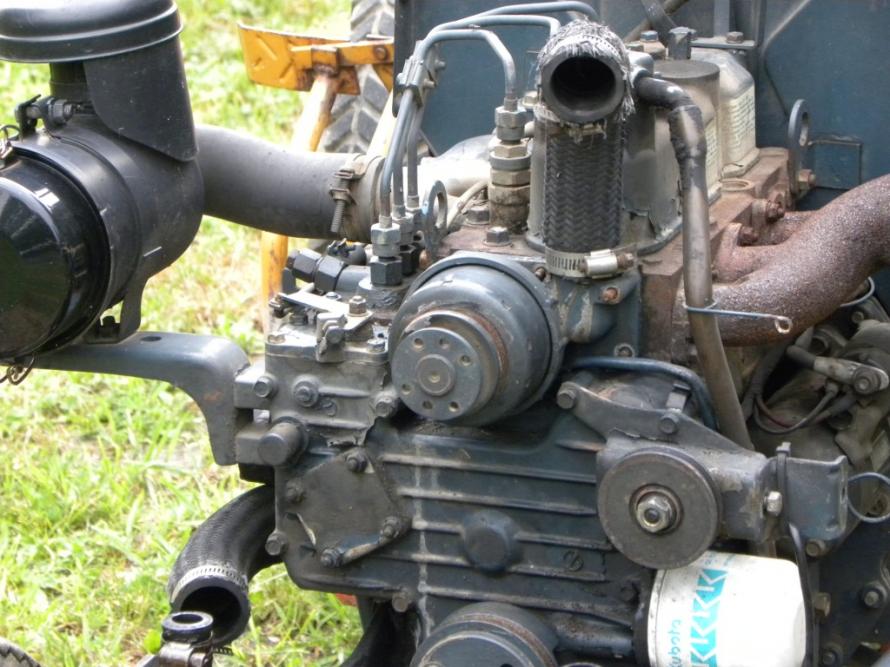

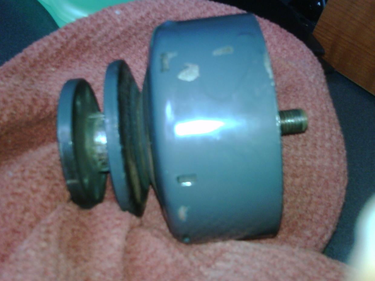

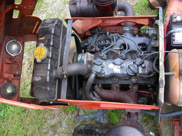

Here are some photos of what a Dynamo from a B7100 from the late 70's early 80's should look like.
The first photo is looking at the engine with the radiator off. The 2nd and 4th photo are the Dynamo. Notice the upper radiator hose in the 2nd photo. This is why it is confused as a water pump. The old B7100D has no water pump.
In the 3rd photo, looking from the top, find the Dynamo sort of hidden under the upper radiator hose. As mentioned above you need to check the Dynamo output with your meter set on AC voltage.
