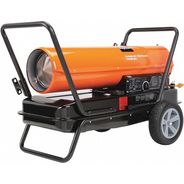

We have block heaters on all our bigger trucks, but last winter it just stayed -10 with the windchill for days on end! We have two big torpedo heaters to help out. Put them into the engine compartments for 10-15 mins to help out.

A motor feels no wind chill. Look it up, wind chill is the feels like temp, invented by weathermen, to help you rationalize your way out of stepping outside, on a windy day...:D:D
Maybe not the right word, but it seems like the airflow past the engine would carry away any heat it generated, and that would ordinarily heat air in the engine compartment and any adjacent fuel lines.

Wind chilll will suck the heat out of an engine rapidly.shut off a vehicle with the nose into a -35 with a 15 mile/hour wind it doesent take long.
The old hino i used to drive needed to be tarped up when it was cold and windy. The heater couldnt do enough without a windbreak.
