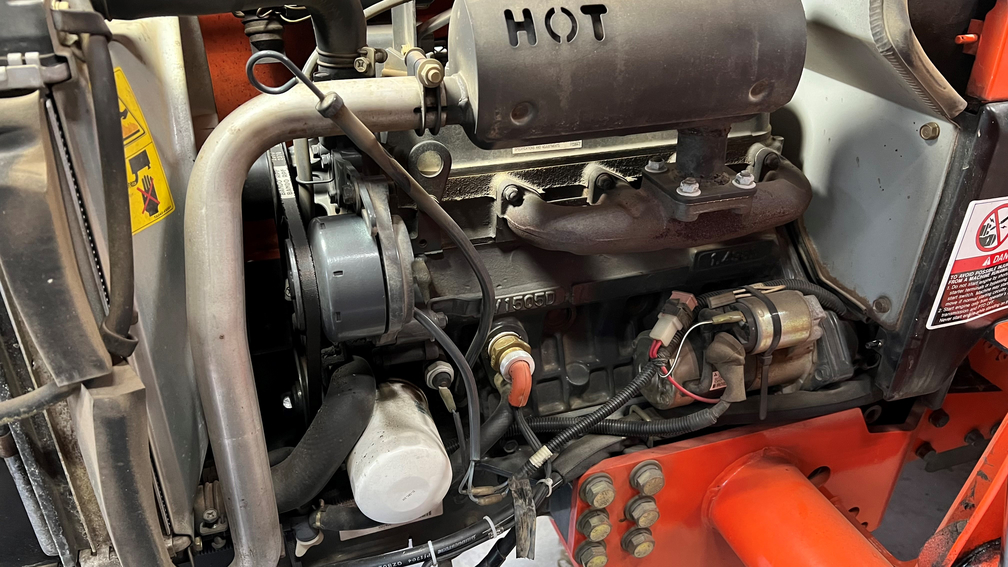

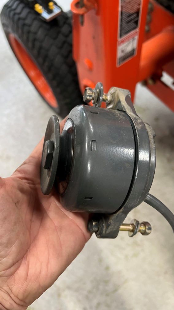

I recently did an upgrade to a 40A alternator because I added a small winch to my tractor. The dynamo I pulled is fully functional. It's out of a 2006 B3030 ~425 hrs, if it's compatible, you can have it for short money. If interested send me a PM.
