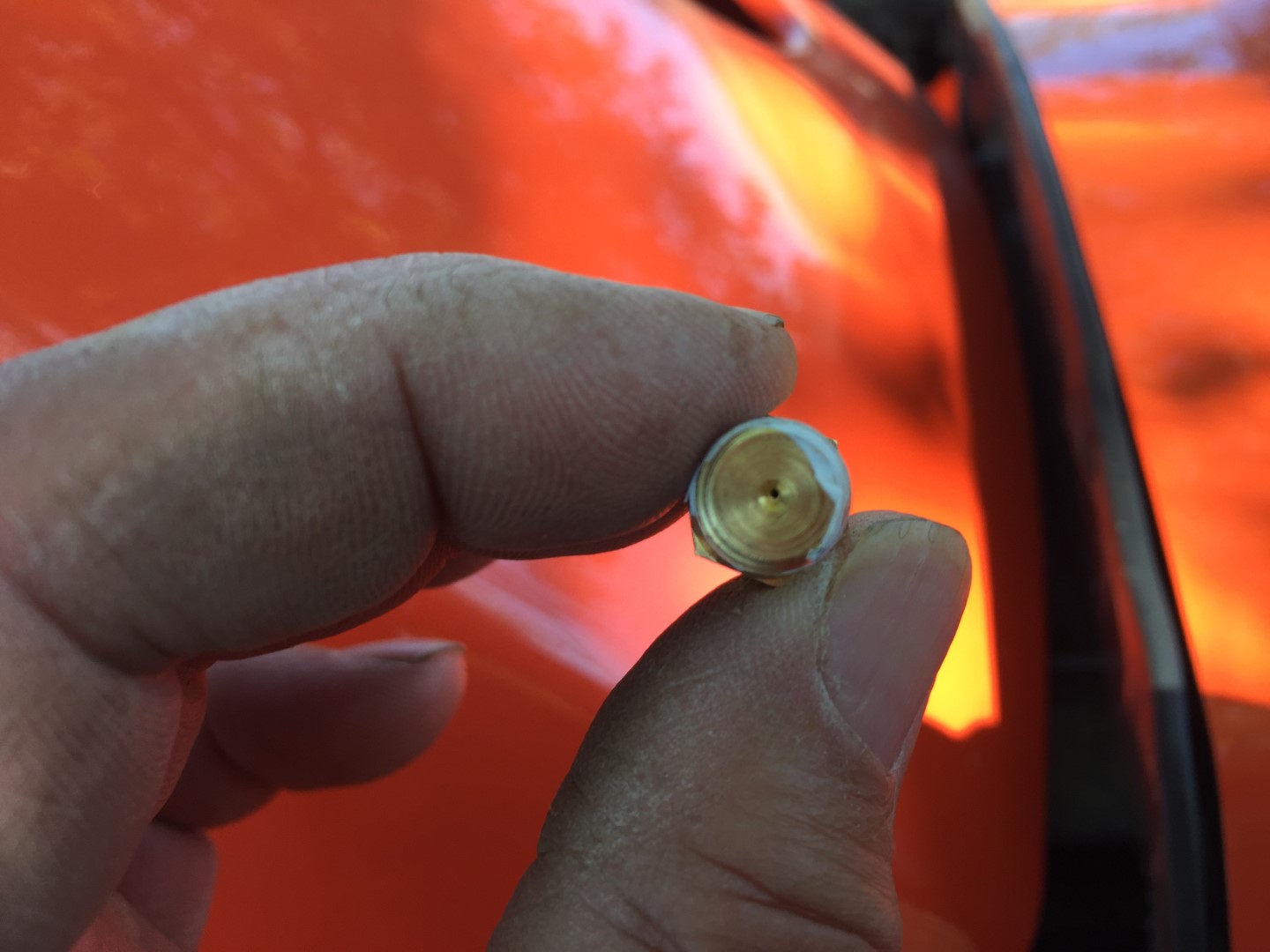

If filter cost is a big concern or not, the best thing you can do for air filters is put on an Air Filter Restriction gauge if your tractor/engine does not have one. You'll find a lot of the major filter manufactures recommend using one. You'll change air filters when they need to be changed due to restriction not by hours or visual etc.. This will show when your filter is becoming plugged. It may be 100hrs. or 300hrs. depending on conditions. Best money you can spend for the engine air filter system to see how it is performing. :)
And some, if not all Kubota air boxes have a 1/8” brass insert for them to thread into.

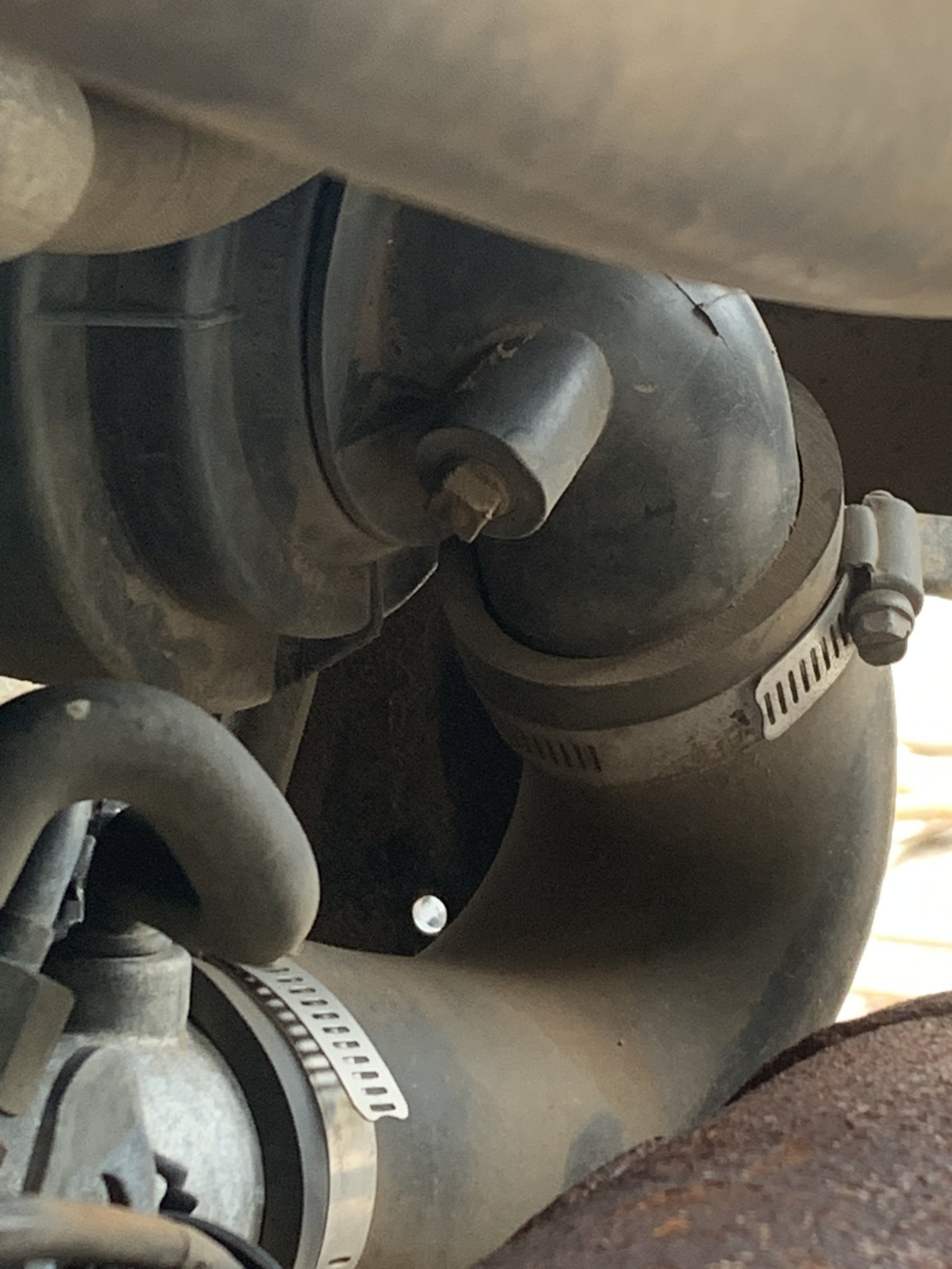

Mine doesn't. I know where they are installed on trucks but wonder where they would go on my L4701.

Same with brushing your teeth. Just get new ones when the old ones fall out:).
Just shown in the last reply they are usually formed into the elbow off the air filter housing.

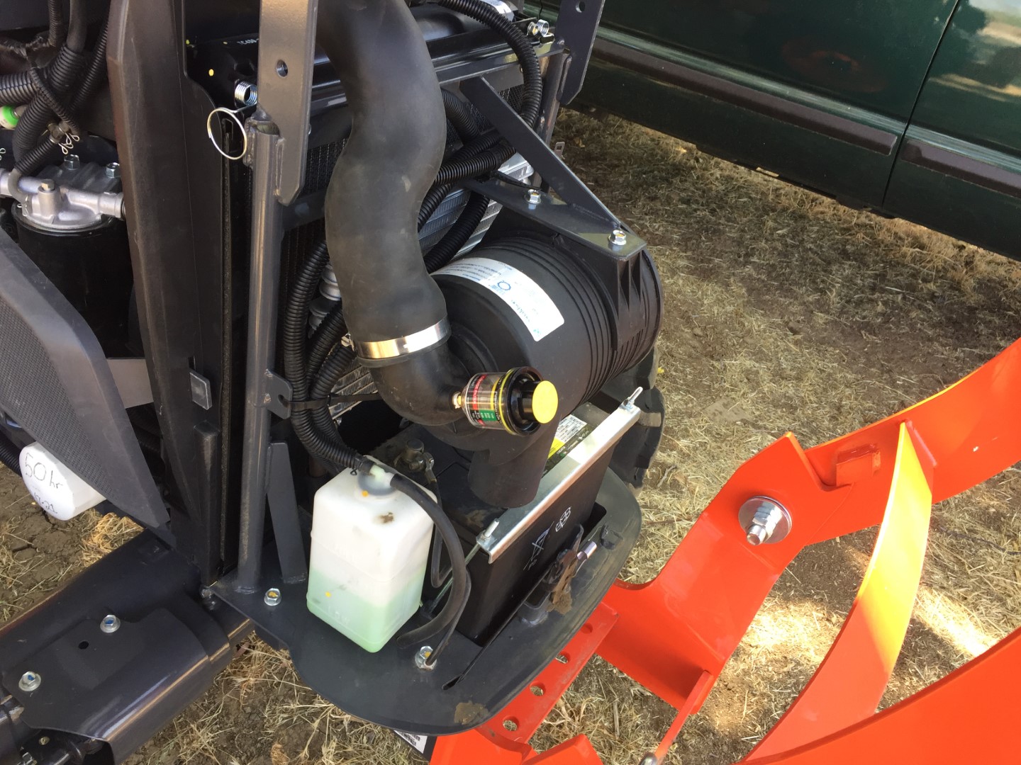

From two mowers at work, grasshopper 325d and toro 590.
Air Filter Restriction gauge . Got one of these and installed it in my L4701. https://www.amazon.com/The-Filter-P...ilter+restriction+gauge&qid=1624149075&sr=8-4
Reason why I went with it was it comes with the 1/8" fitting and is slightly shorter than some of the other brands.
Shorter was better because it just (by a hair) misses the bracket under the right headlight and that is after you make sure the elbow (highlighted by ruger1980 in post #29) is rotated forward a little.
