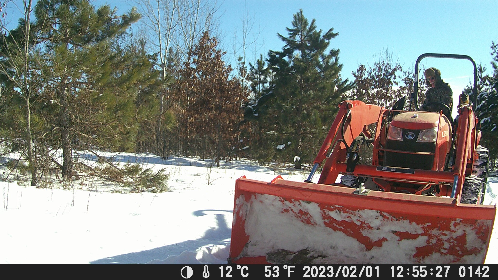

I purchase a L2501 hst late 2019, have 56 acres of hills, grapple, 6 foot light duty Land pride rotary cutter, too small of a box blade :oops: and open cab.
In all honesty I have not needed or wished for more HP but I tend to take things a bit slower than many others. I enjoy the seat time. I also have not wanted a cab, again I enjoy the sun and fresh air. The closest to wanting a cab is when mowing my trails when it is super dry, the dust can be annoying. It rains enough here in central Wi I can time the trail mowing right after a rain.
To be fair my thoughts on HP might be different if I was running a chipper and what I was chipping.
Good luck on what ever you decide and congrats to your new home and land!
I figured the thread could use a picture! The day was 15 degrees F unlike what the trail camera says. A gorgeous day to be on the tractor! :)
