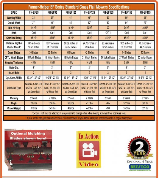

Andy, when I bought my flail mower from Betstco they had a chart on their site that stated the HP requirements for their different models. And at the bottom of the chart it stated that for gear driven tractors you use the rated PTO HP to match up to the flails HP requirement. For hydrostatic driven tractors you use the engine HP.
But now that chart seems to have disappeared. There's info on other websites that state both ways, also. But Betstco seems to have removed that "clause" from their HP requirements. Hopefully someone else will comment on the HP requirements for the flails.
You can always slow down. But it's still a balancing act. Faster with a narrower cut vs slower with a wider cut. If your grass isn't tall/heavy but instead somewhat well maintained you'd most likely be happier with the 53 inch width. I'm disappointed I can't find that reference to the different HP requirements. I'll look in my paperwork that came with my mower to see if its in there or not.

Here's that old chart with the note on the HP requirements. See the * at the bottom of the chart in the dark orange horizontal line.
But unless this chart is still cleverly hidden on their website, they've since removed it. I found it by searching images of flail hp requirements.

Andy, you won't have any trouble spinning the 53". I can easily over rev mine unless I'm in deep/thick grass.
