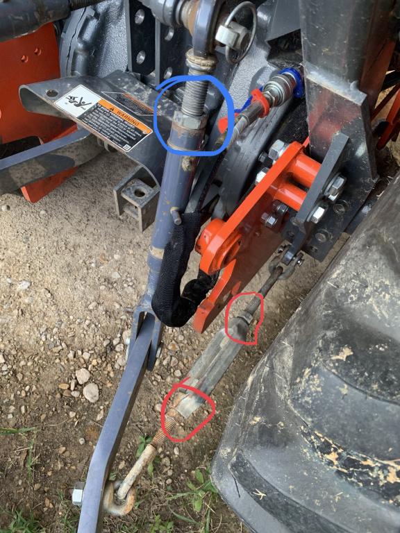

I removed my backhoe on the L2501 for the first time today. Simple enough. However, I was disappointed to see that when I plugged in the return line back into the tractor and started to install the 3 point arms, it is very much going to be in contact with the 3 Point parts. Has anyone had that issue? A 90 degree or 45 degree coupler seems to be the answer. However, I am not sure if that would cause any issues that don't come to mind at the moment.
I plan to go by the dealer tomorrow and see what they say and get a 90 degree coupler from them if that is what is needed, but figured many of you must have had this issue. I searched a little but didn't find anything relating to my problem.

Yeah, that looks very much like mine. I was tired and did not put the 3 Point arms on and see how it might work.
Thanks for confirming it not being as close with the implement on. I thought maybe it would be a bit better as the lift arm would be a bit higher, so that's good to know. I will give it a good look-see tomorrow. Perhaps it will work fine as is.

I’ve only had the backhoe for about 2 months now but been on and off quite a bit. It hasn’t really concerned me with the hose that close.

I see what your saying but when I hook up implements I***8217;m always doing it on the ground. I get the tractor as close as I can while sitting in the seat, put the loader bucket in the ground and use the hydraulics to push or pull tractor into position. All my swaps are done without getting on and off the tractor.

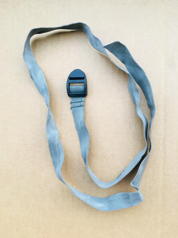

Zip ties work but if you change between backhoe and 3 pt equipment often you have to cut the ties loose, replace them, etc. Plus, depending on the ties used.....the narrow ones can start to cut into the hydraulic lines with very little vibration over time. That's something to think about or watch out for. Here's a couple of pics of my little strap that's easy to put on and just as easy to remove. It's a little long for what I need (not sure what it's from) so I think I'll sew up a shorter one with a couple of those D rings on one end. If you gents would want one I could do the same for you for the price of materials and shipping. Regards, David

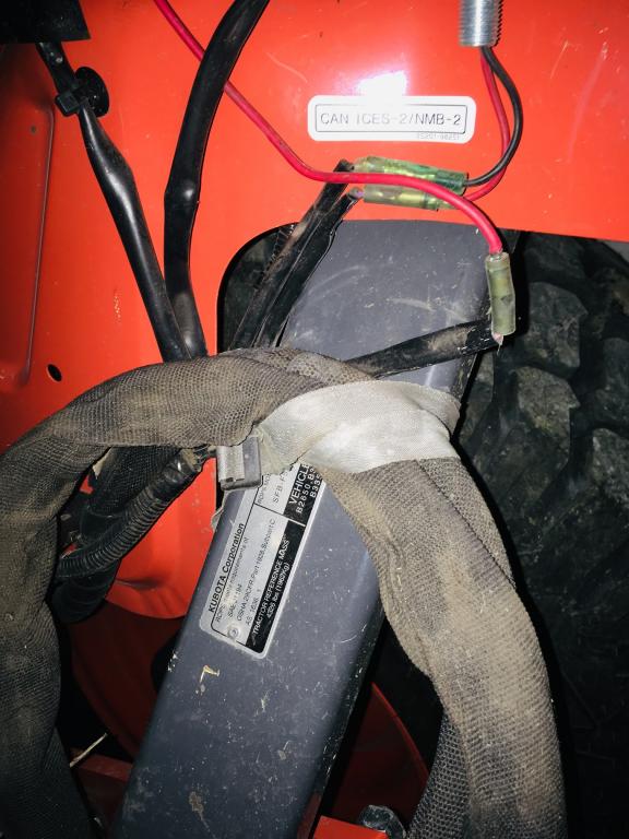

My B2650 with BH77 backhoe has the hose held up out of the way with a clip Kubota mounted for the job on the rops right side just above the hydraulic connector to the tractor. I loop it around the rops upright and through the clip when BH is off and it's well out of the way for 3pt operations. With the BH connected I un-loop it from the rops bar and clip and it settles under the BH floor nicely. Photos to follow.

This is how I use the clip when BH is off. This pic has the BH still attached as I'm not removing it just for a photo, just routed the hose to demonstrate.
