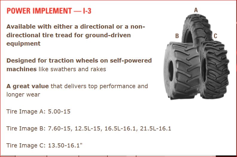

I'm just east of where your moving.
The L will do fine, it's not anywhere too heavy, I have Both a B and an L and they both put the same foot print down.
If your really concerned change over to these tires or go dual on what you already have:

Thanks much for the very good replies. I want to move to a B series Kubota since they will be at least 700 lbs lighter than my L3400. The B3350 has almost the same engine and PTO HP as my L3400. In addition, I may easily sell my L3400 with our house and property in California, avoiding the need to haul stuff 900 miles to Washington.
Good idea about tires -- R4s probably make more sense than turf tires. As to the flail mower, I think a 48 inch Rears mower would be more useful than my 60 inch mower for maintaining trails and chopping trimmings and berries. I use my 60 inch flail for all around stuff including mowing my pasture, but I would not use it for general mowing in Washington. A B2650 has plenty of PTO HP for the smaller flail mower and the other PTO stuff I'd use (tiller and finish mower), so it may be a better choice for me than the B3350. I'll follow the DPF technology for the next year or two to see if it improves by the time I decide to buy. Prefer as much HP as I can afford, but like many (but not all) people on this forum I want to avoid the current DPF technology.
