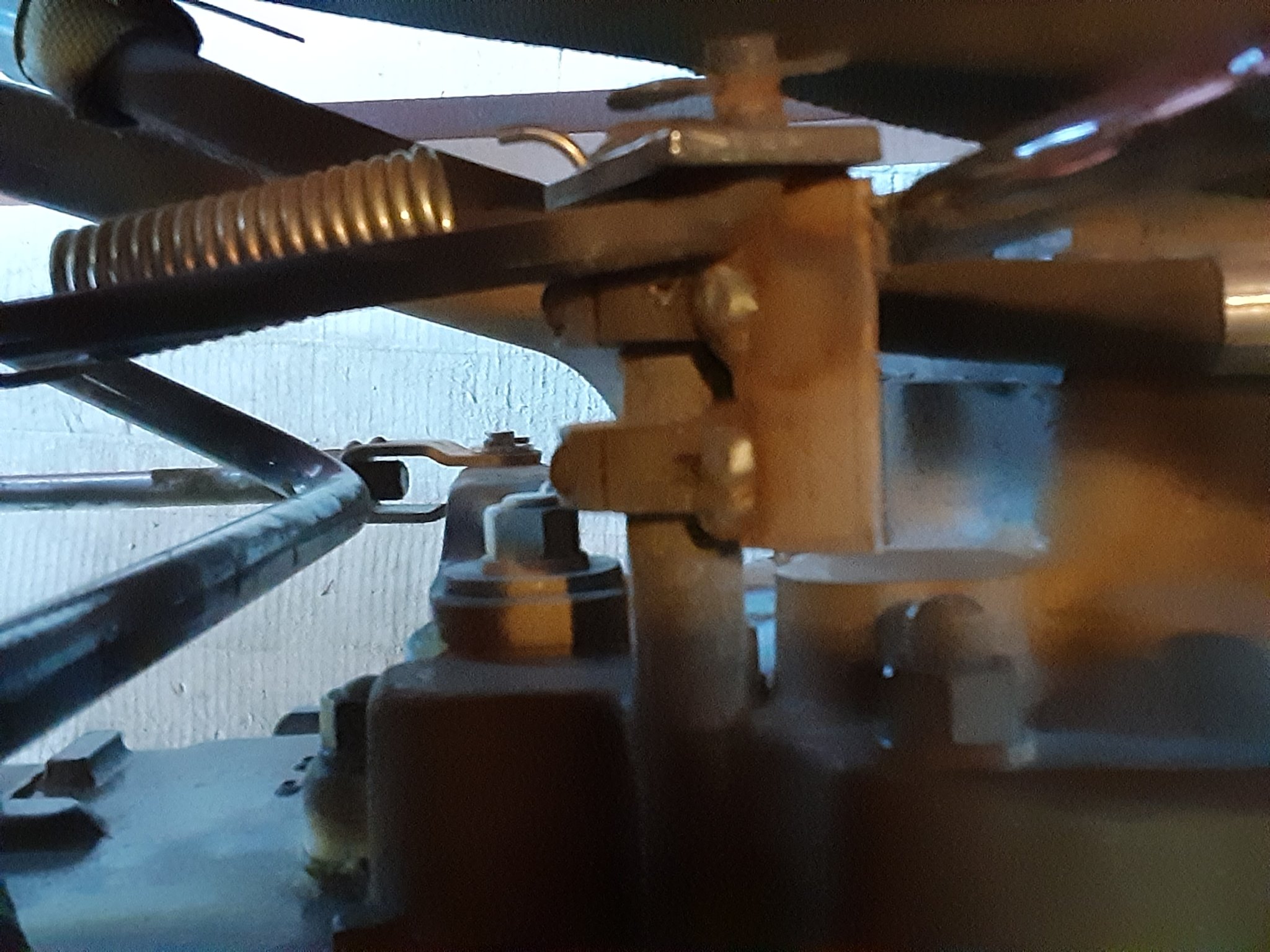

I am glad it helped you. I have the L2501 DT gear drive while most here have the HST. I also found using the foot throttle was better in backing rather than the hand throttle. But on the DT the dif lock is on the right side and you can't operate the throttle and dif lock at the same time. I figured out and made an adapter to the shaft where it comes out of the differential case to then put a cut off golf club handle on that. I can engage the dif with that using my right hand. It has worked quite well for me.
I had some pictures of it but didn't find them right off.

Well a short explanation, don't want to rob the thread,
The shaft coming out is close to 5/8" so I bought some split shaft collars. I welded 2 of them to a piece of 1/8 angle iron I think was 1"x1". Welded about 3/8 x 4" long bolt to that so the handle just slides on so it wouldn't be in the way for any kind of work on the tractor. With the split collars I position it on the shaft so the angle pushes against the existing foot pedal linkage and tighten them to keep it in position.

Wow, that's a lot better than just welding something directly to it. I really like the adjustability of it. Nice mod!
