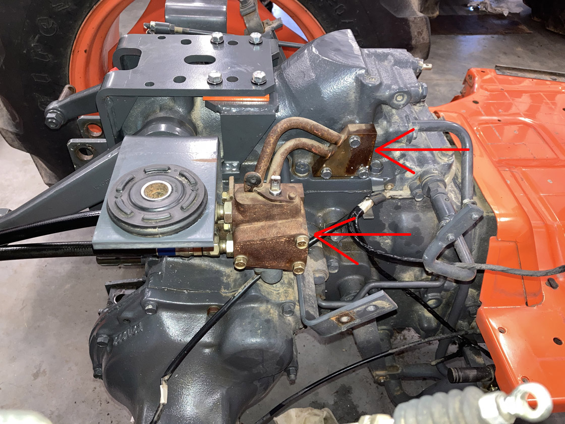

Salvage is your best bet since Kubota discontinued the part. Here is a pic of mine so you know what it looks like. It's two pieces that are fixed together by two pipes.

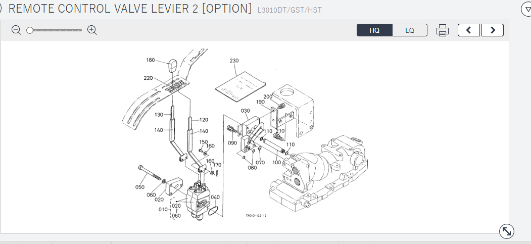

What is the part #?
It's more than one part number for the setup:
You will need to know how many valves you want, 1, 2, 3
There was kits available at one time, that included everything.
None of those kits are very likely to be available any longer.
Here are all the parts your looking at, it's about $2500 for all the parts.
