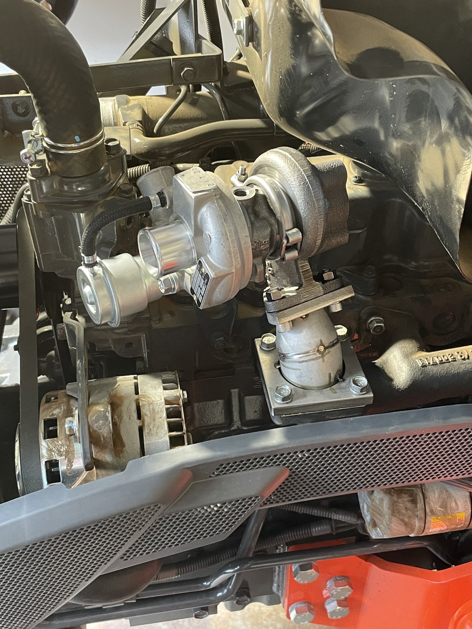

Still got my little turbo intercooled Tubota.
Its only been about a year, but to everyone who said it would blow up, looks like you were wrong.
Anyone who thinks a Kubota IDI diesel will blow up from a little boost must have never taken one apart.
Rdrcr
Vendor Member
May 7, 2021
742
901
WA
Yep, these little engines were made for boost;
Im expecting to have my turbo setup finished in the next couple weeks.

Looks like fun? Have you started your own thread to make following along, easier?
I will. Once I have everything completed, I’ll start a new L2501 turbo thread.

It looks like I never updated after I installed the boost gauge. I'm normally only making 5psi of boost. When I'm on the boost there's no smoke.
Rdrcr
Vendor Member
May 7, 2021
742
901
WA
What gauge are you using?
I bet you’re making more than 5psi under heavy load situations.
My ISSPro combo EGT/Boost gauge isn’t super accurate for PSI but, does a good job for EGT and I’m much more comfortable monitoring the EGT’s during heavy use with the Turbo.
