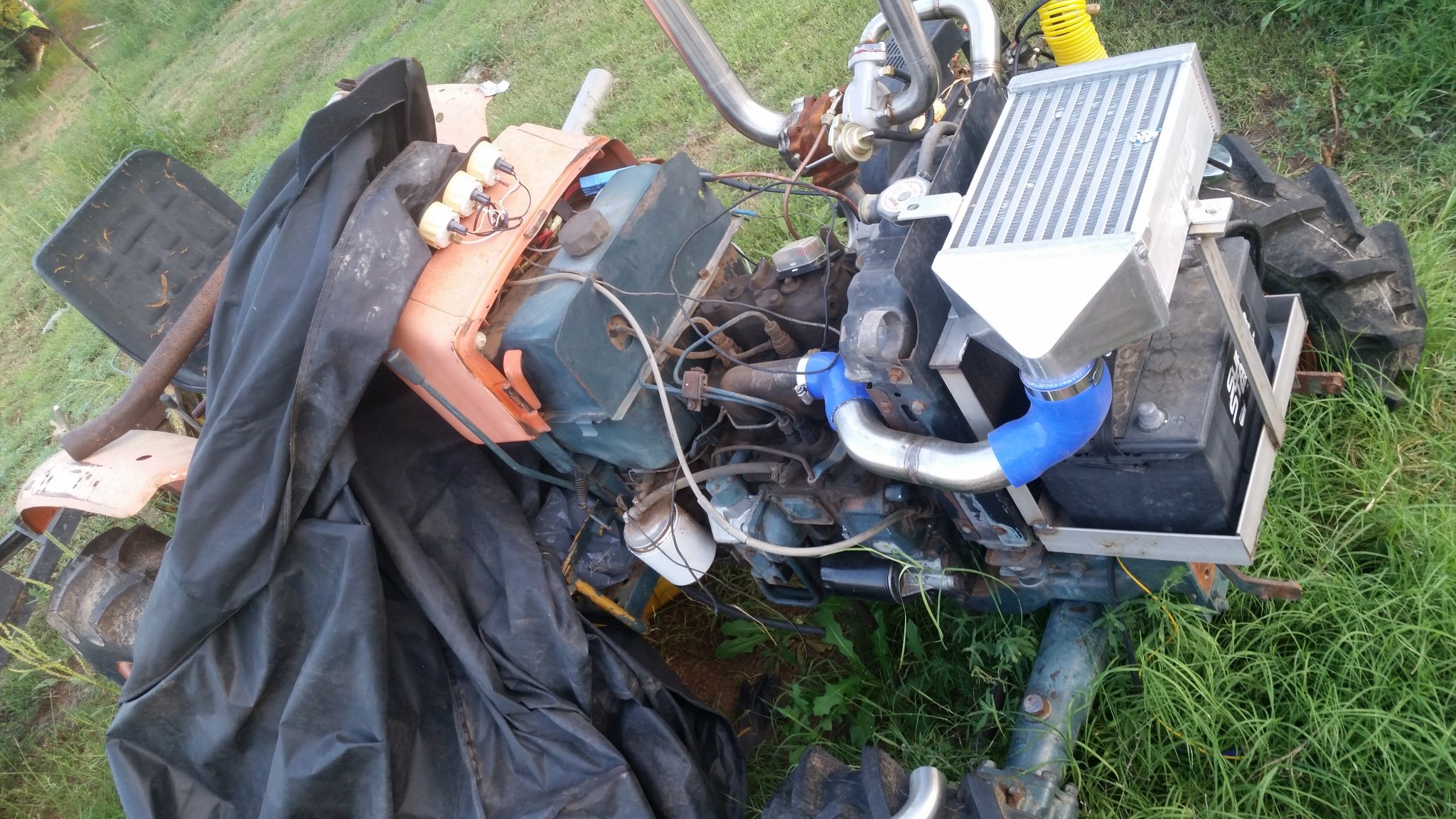

Took the turbo stuff used the tractor like normal, but now it's going back on.
I made a battery and intercooler bracket out of 304 stainless.
I ordered all the couplers I think I should need from frozenboost dot com because they usually ship next day and I'm so close to them I get it in a about 1 day.
The battery box was all rotted away so I took it apart with my plasma cutter and built it back with 304 stainless steel 1.5 inch 1/8 thick angle. And some flat bar to hold the intercooler.
Intercooler is going in horizontal.

I had to put my air filter up high because of all the dust here, oh and the intercooler is where the air filter is supposed to be.

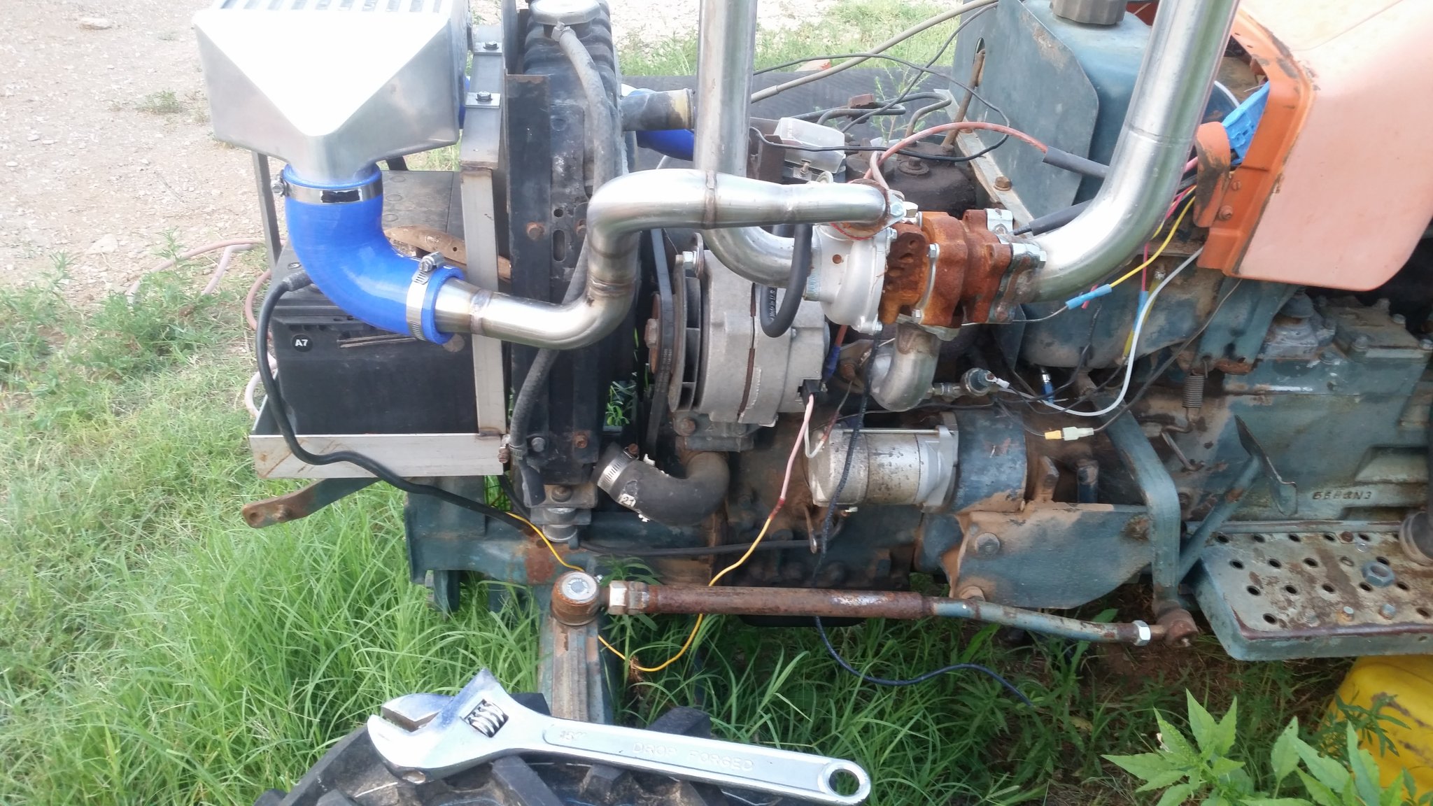

I got the intercooler to engine pipe done it was easy. I'm going to go with tig welded 1.5 inch 0.062'' wall 304 stainless for most of the intercooler pipes.
I will be chopping the hood, but my hood is held together with rust and bondo so no big loss there.
Need to update with pics.

I'm 1 flexible elbow, 1 cut and 1 weld away from being able to fire it up.
We'll the oil doesn't have a return yet, I will probably just jam a line in the dipstick hole.
As soon as that elbow comes in I can make that last fitment adjustment, welder up and the turbo pipes will be all done. The intercooler needs a fan too but that doesn't have to be done immediately.

I fired it up with a container under the oil return, it gets good oil flow a little too good, I may need to choke it down a bit.
