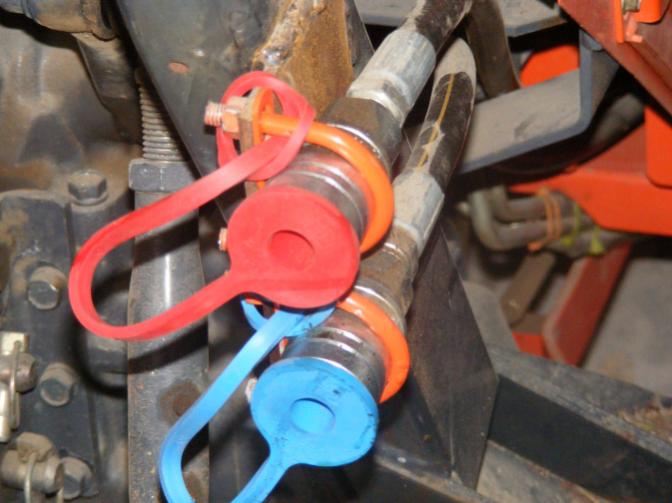

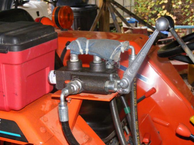

I did some research on the hydraulics and how they were plumbed and thought I could do it myself much cheaper. For under $300 I have working remotes set up the way I want them to be and even have the push in pull out rear couplers like my M series tractor has. Just thought I would post a few pics and throw the idea out there in case anybody else was thinking of doing the same thing.

Just in the interest of completeness it'd be nice if you could post a pic of your connections where you tapped into the hydraulic feed.

Bulldog, great job!
Are you going to fabricate a metal cover for the controls? You can rest your arm on it and also keep your arm off that hydro line when it heats up. I'm guessing the blue rag is a temp fix for that??
Anyway, you did great and it's good to see you make stuff like that.

Hi Traildust,
Your correct on the blue rag. It served as a heat shield for me. I left my friends shop that made all my lines for me with the tractor and as soon as I unloaded off the trailer it was hooked to the rake and off to the field. It's probably going to be a winter project for the perm. guard. I want to make one to serve as arm rest and to protect all the connections also.
Hi ETRon,
If you look at the second pic I posted you can see the line leaves the new valve and goes down to the back of the loader control and hooks in there. All that I did is used the factory line going to the loader as the input to the new valve and routed the output back to the loader. The top two lines covered by the custom blue heat shield go the the rear remote couplers.
It really was that simple to install. The valve and three hyd lines was all it took other than fabricating the mounts for the valve and the couplers. I will be more than happy to post some more pics if you want to see things up close.
If anybody needs to get a closer look at it just let me know and I'll get some better pics.
That's pretty slick, thanks for pointing it out to me!
