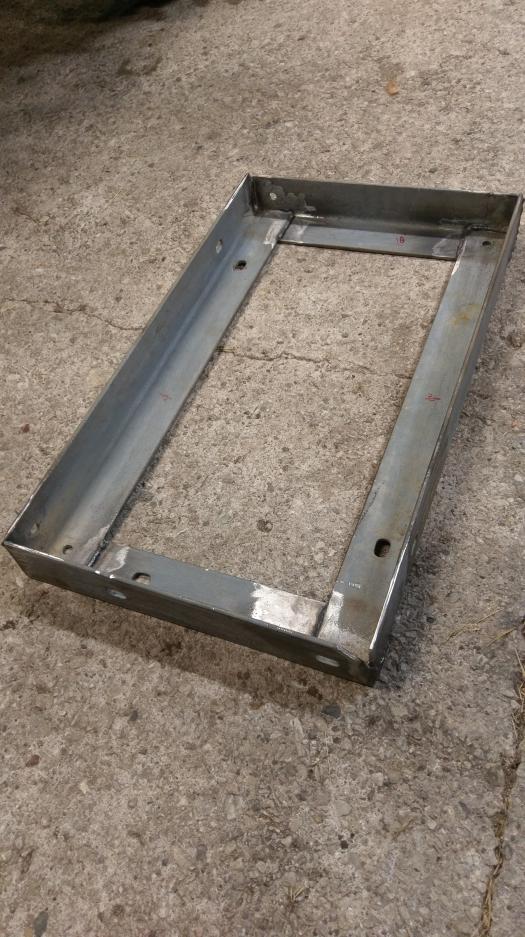

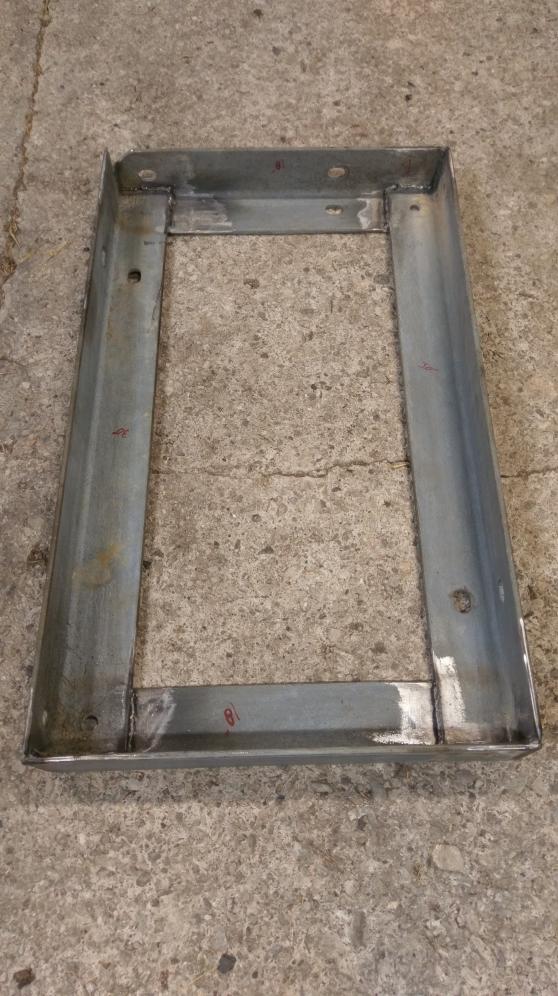

Finished the bottom section of the ballast box frame. There will be one identical to this for the top and then four uprights, one at each corner, all from the same angle steel.
Nothing special....
