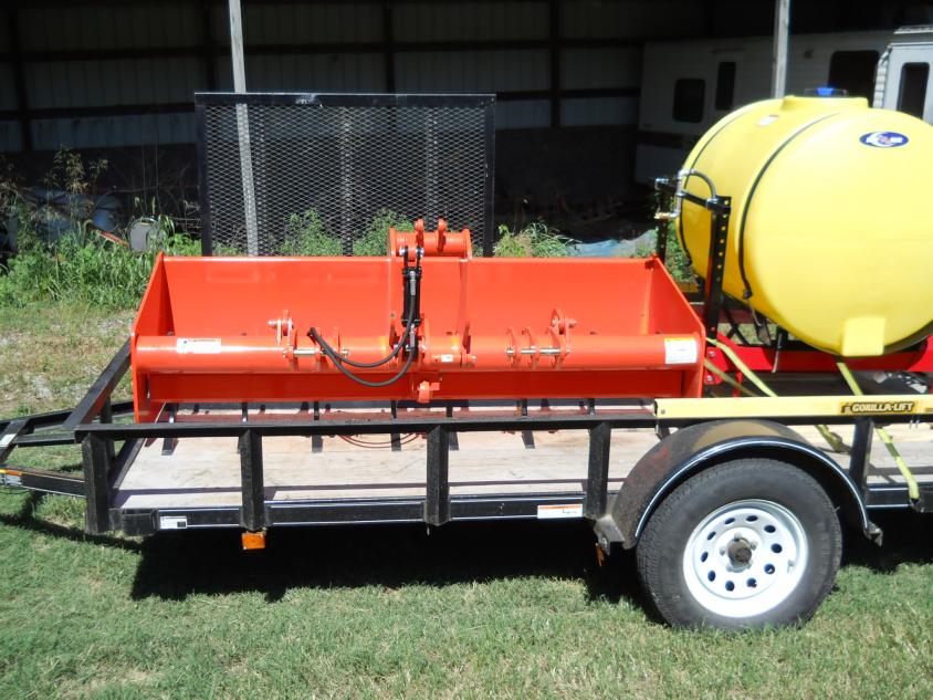

I think this is a great example of you get what you pay for. The grader I tried wouldn't move that much dirt if you drug it around for a hour.
I know you said it works forward or backwards. The pic of it sitting on the trailer it appears to have cutting edges on both sides, is that correct? The one I used only had them for going forward.
Thanks for the pics.
Cutting blades are only on one side. I use it to push dirt backwards though and it does it without digging in, which helps to level things that are loose.

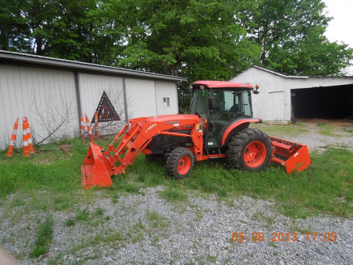

Sorry, poor or lazy use of nomenclature on my part, the cutting edge is not 24", the cutting edge is removable and reversible, but it transitions into the high back, so I didn't see a need to get too specific as the "cutting" part on any cutting instrument really isn't measured in inches, my mistake. Well maybe since it is 84" wide the cutting edge is 84".:)
I will attempt a picture or two. To the left, you can see my other one which is a Land Pride BB2584 with a weight of a little over 600 pounds; OK, but not heavy enough and I don't use it much except when I need both tractors going at the same time and then it goes on the L5740 and the HR3584 on the M8540.

Yes it is big, but if I could afford it, I would get a Woods HD24496HXD which is a foot wider and 200+ pounds heavier for the M8540.
We have some lighter weight ones at another farm, but we just use them mostly for driveway maintenance and te driveways out there are only a few hundred feet at the very most.
My dad used an old Ford 600 with a economically priced box blades to do house site prep in Mississippi; I'll never be as good as he was so I have to cheat with better equipment to even come close.:eek:
