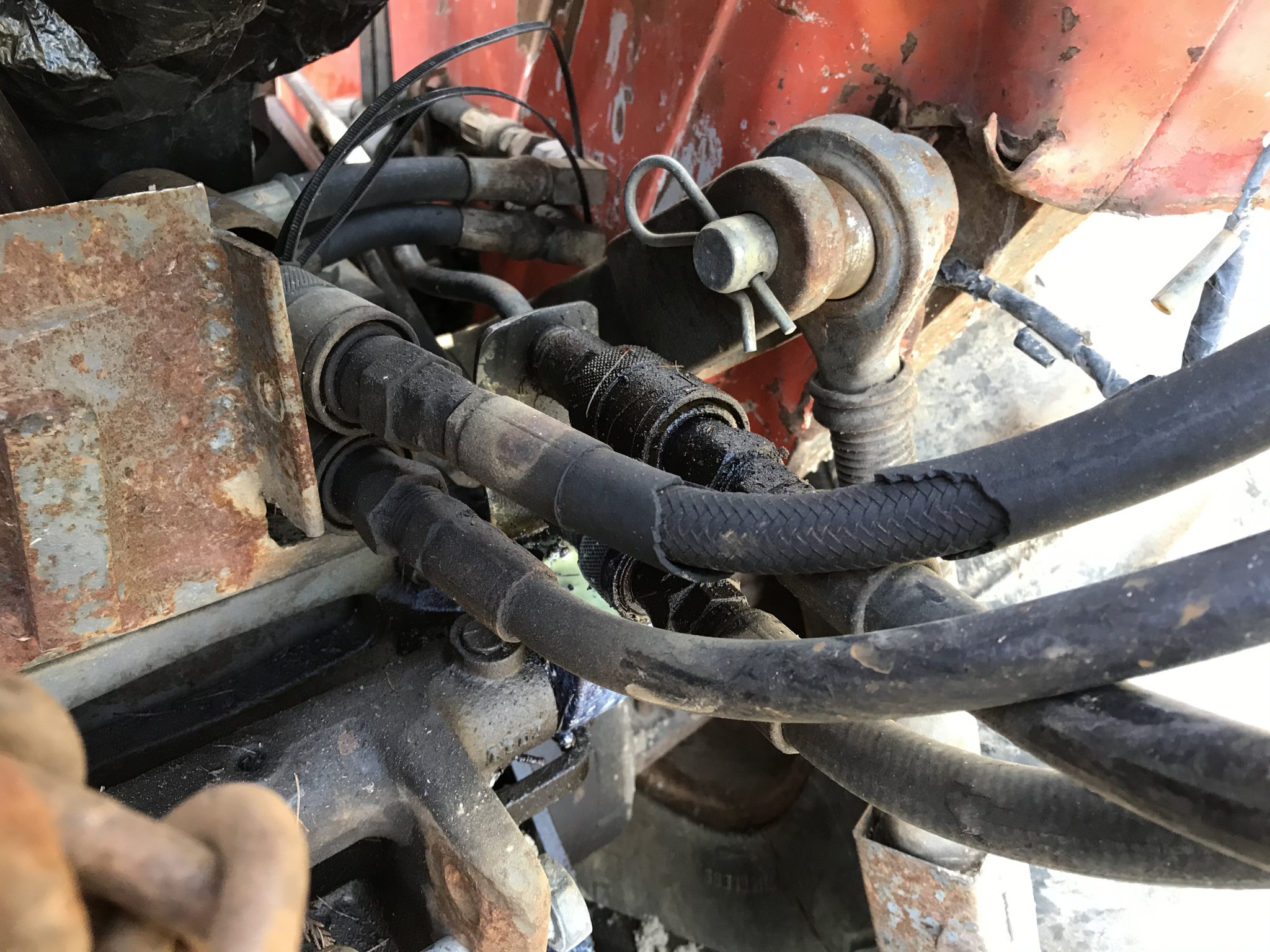

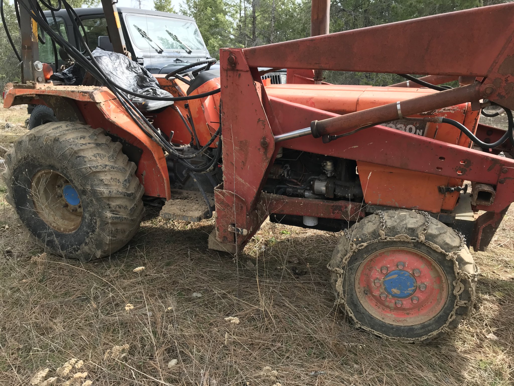

I have a late 80s early 90s m7030n 4wd. I recently lost power steering and the ability to raise the 3 point
someone told me a hydraulic filter or port could be blocked. Not sure where that filter is or port.
I do still have hydraulic power to the accessory ports on the rear which I have my bucket hooked to
thanks for any suggestions-in advance

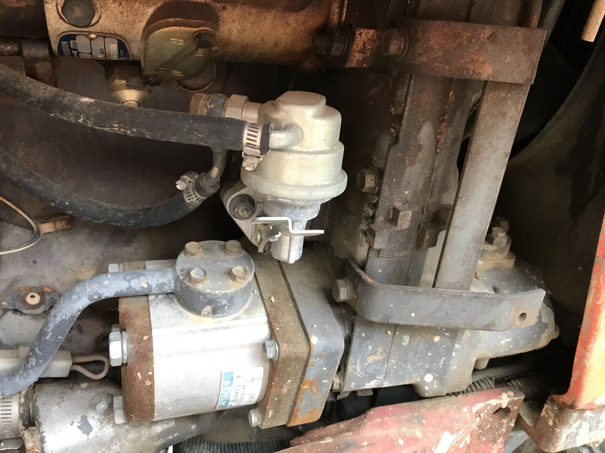

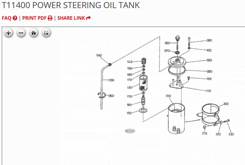

It appears like there is a separate system for the power steering.
It is possible the ps system has its own supply. I do not know but this is an educated guess.

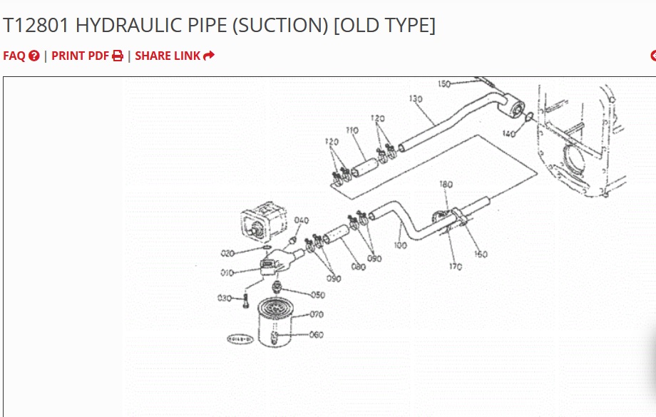

There is a hydraulic filter for the main system
These two illustrations should help you locate the filter. There are two possible systems.

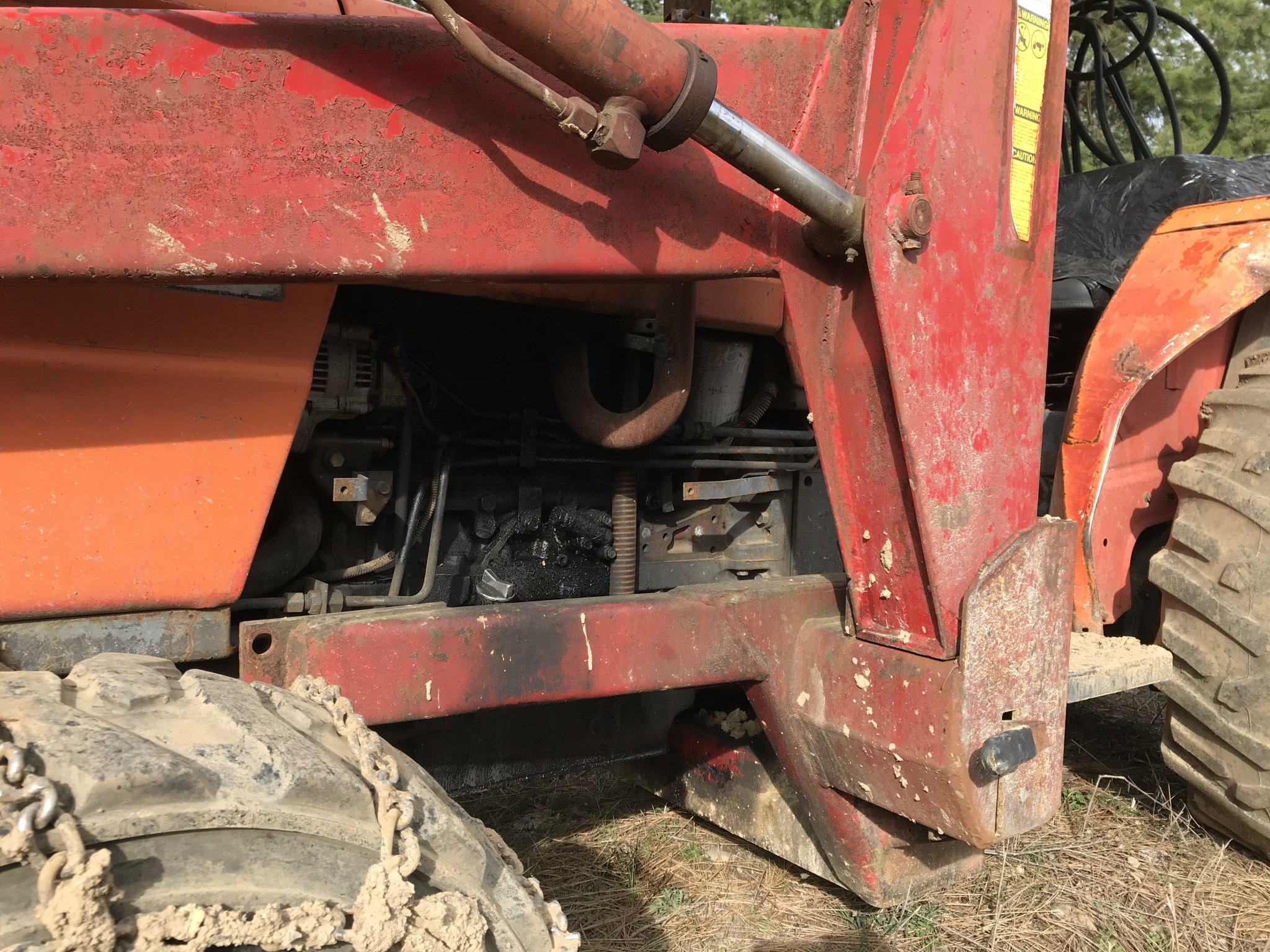

Is there a Kubota model number on your loader? M1880A perhaps.
When you mention bucket I just assume you meant a loader bucket.
Could you post a photo of the whole tractor please. I need to get a sense of what controls are present.

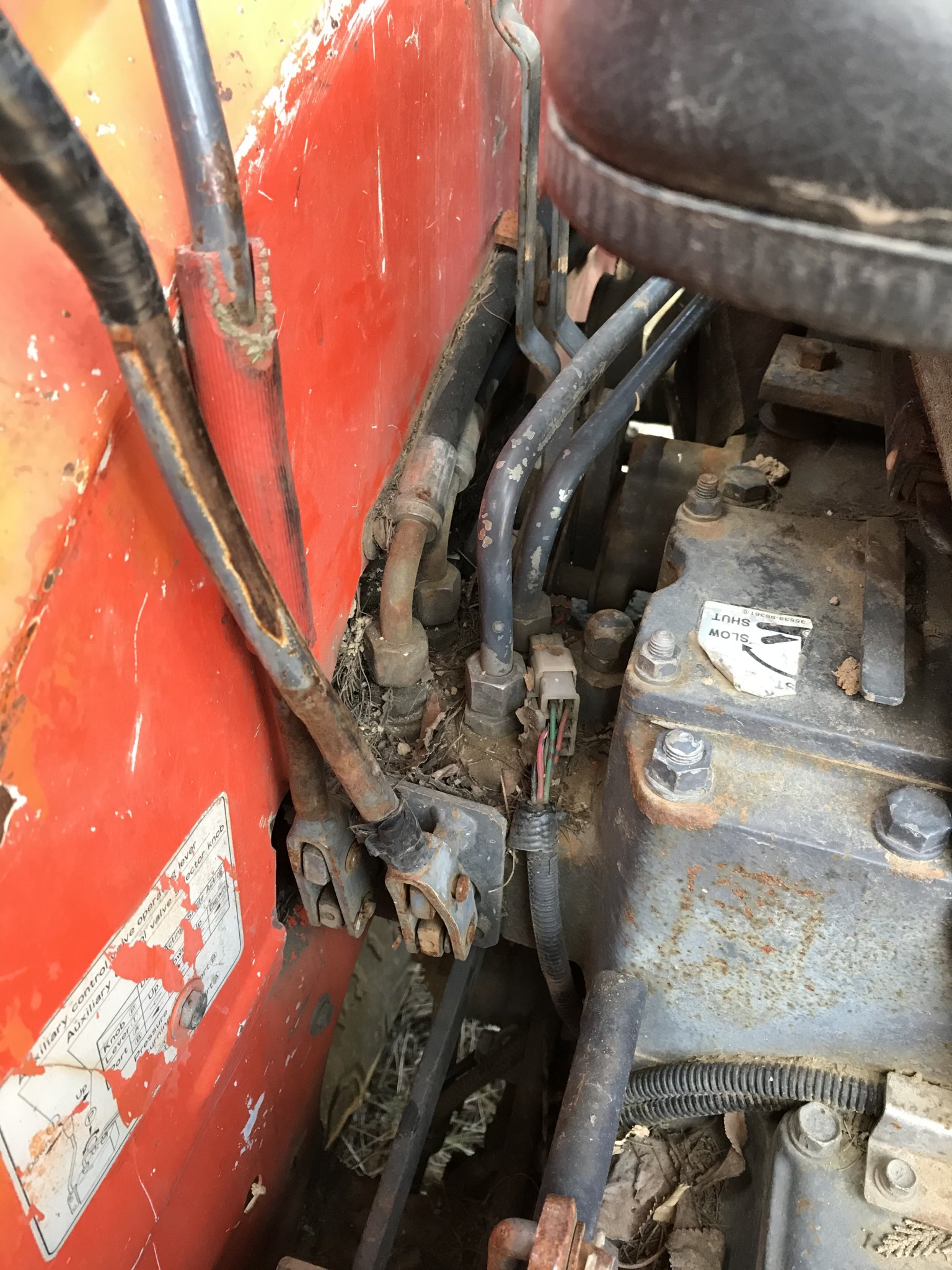

It looks from your two photos that your bucket is completely controlled by two pairs of rear remotes and not a true loader valve.
A true loader valve would have 4 lines for control of the loader. Two for the bucket and two for the lift arms.
A true loader valve would have an IN line from the hydraulic pump, a TANK line to return flow to the reservoir since the hydraulic system is an OPEN CENTER design. This setup totals the 6 lines I asked about. A 7th line, if present, would be a POWER BEYOND line to feed high pressure hydraulic oil to other users such as the 3 pt hitch and rear remotes.
Your photos show the bucket and lift arm hoses coming from the rear remotes.
If this is the setup you have, you are missing out on easy control of your loader and also eliminating rear remotes for other uses.
Were you able to check if the power steering has its own tank for oil?

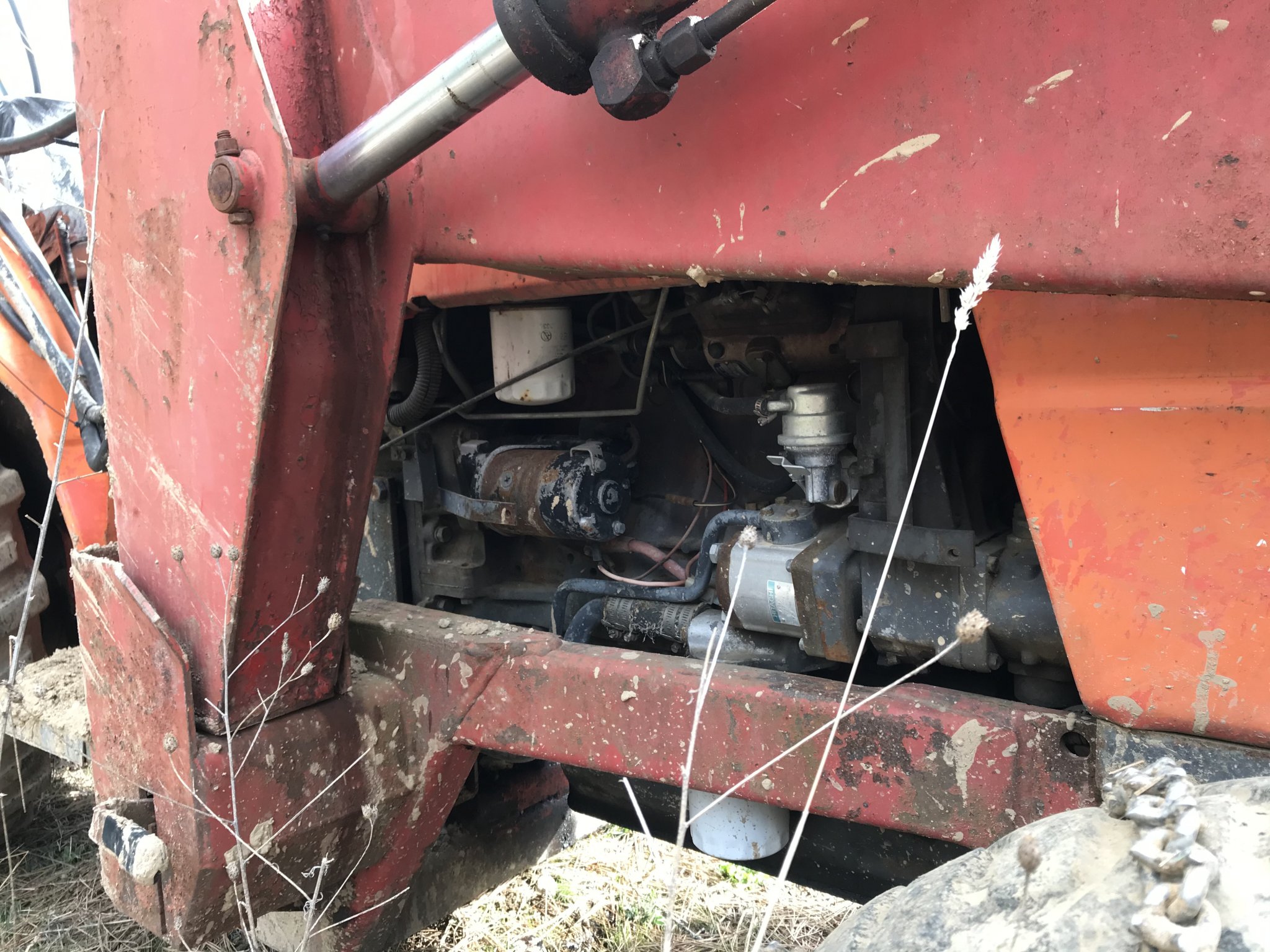

In looking at the latest photos one item jumped out at me......the diameter of the hydraulic cylinders on this repurposed loader.
They look far too big for a modern hydraulic system.
I saw this once before where an older tractor's loader was used on a newer tractor. The old tractor's hydraulic system was designed for 1,500 psi and to get a strong lift with the loader larger diameter cylinders were used.
When this loader was installed on a tractor with a 2,600 psi hydraulic system the owner was delighted as the loader was incredibly strong. He came to realize the loader was so strong it was destroying itself and his tractor.
I am only looking at photos and may have mis judged things but you know what tractor the loader was originally on and could double check the hydraulic pressure on that machine.
I would hate to see you break the engine bell housing or the front axle.

Thanks Dave the loader came off of a 70 HP Massey Ferguson. I don’t know about the pressure difference. It was from a similar vintage tractor is all I know. I have had it on my tractor for about 5 years without issue till now.

First, the three point not working and the steering no working are 2 separate issues, as the 2 systems on that model are not tied together at all.
The steering can be a multitude of things, like low oil in the reservoir, or blown steering cylinder seals, or a bad controller.
