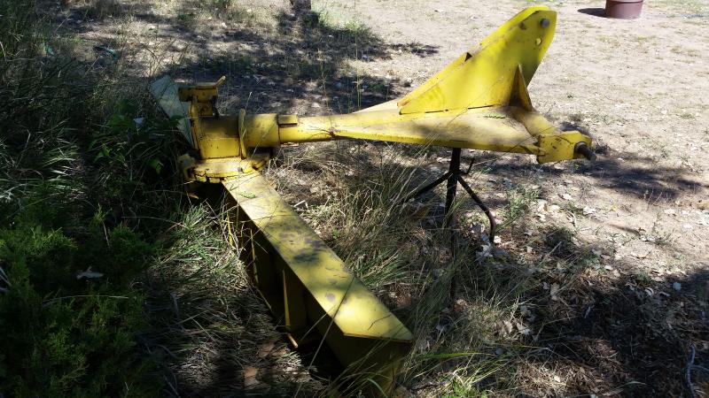

Ok, I dont want to sound dumb, but I sure feel that way at the moment. I have a 6' Industrial tilt/pivoting scraper blade that weighs in the neighborhood of 350-400lbs. Easy enough for my M8560HD to handle though. Problem is, when I hook it up to the 3 point and attempt to raise the unit off of the ground, I run into these two scenarios:
If the top link is long, the lift arms rotate under the top link rotating the blade inward as the lift arms go up, the top link does not raise.
If the top link is shortened, the unit is off the ground and the lift arms will not allow the unit to touch the ground, it appears the top link keeps the lift arms from completely lowering.
I have been adjusting the top link manually in order to use the blade which has worked, but lifting and lowering that chunk of steel manually is a major pain in the $&%^&!!
I dont believe I need a hydraulic top link, as I have seen numerous other large blades on tractors and all have had standard 3 point attachments.
I know I am missing something, and its probably some lever or knob on my new tractor that I am unaware of! A little help would be greatly appreciated!!

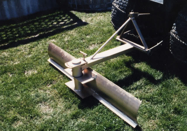

this is a picture I snagged off the net.....
can you shoot us a picture so everyone can see?:)

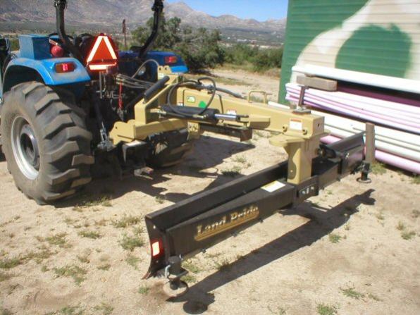

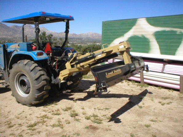

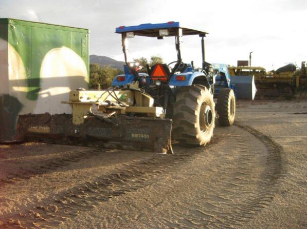

If you still have problems, then get back to us. By the way, you really need one of these for a rear blade to run behind your M8560.
It's what I have behind mine and would not want anything less. ;)

Well, mine definitely isnt that big! but the blade is most definitely a cat 2 blade, with cat 2 pins etc, and its 8' not 6' (didnt have my glasses on!). When I refer to industrial, I am speaking of DOT spec equipment. This blade is way over-built with two large horizontal gussets along the back of the blade, and 5 vertical gussets between the two horizontal gussets to reinforce the blade. All manual tilt/pivot.
85Hokie: If the top link is disconnected the lift arms do continue to drop to their lowest point
MtnViewRanch: Am I to assume that a blade is only designed to be lifted a very short distance off of the ground? In order to get up and over obstacles and drag uneven surfaces, I definitely need a decent amount of travel.
One thing I noticed and should mention; This DOT blade appears to have an extremely short distance between the lift pins and the top link, I am talking 14.5 inches. Simple geometry now tells me that the closer these hook-ups are, the greater chance of a blade doing exactly what mine is doing....more thoughts? Isnt the standard distance in the neighborhood of 24" for a cat 2 set-up?

MtnViewRanch and Wolfman you are both absolutely correct, and I humbly apologize for my ignorance! Apparently when I was sold this scraper as a Cat2 implement I was deceived! They installed Cat2 lift pins and enlarged the top link hole for Cat2 hookups, but failed to realize that the lift pin/top link pin height on a Cat1 implement is 18", and the lift pin/top link height on a Cat2 hookup is 24".
The worst part is that the lift pin/top link height on this scraper is only 14.5 inches! That's half an inch lower than the lowest pin setting on a Cat1 implement!!
Looks like I will be breaking out the welder and getting this to the proper height before selling it and getting a true Cat2 scraper (not like yours MtnViewRanch! I only have 45 acres, not 45000 acres to maintain!!)
Thanks all, you were a great help. I just couldnt see the forest for the trees!!
