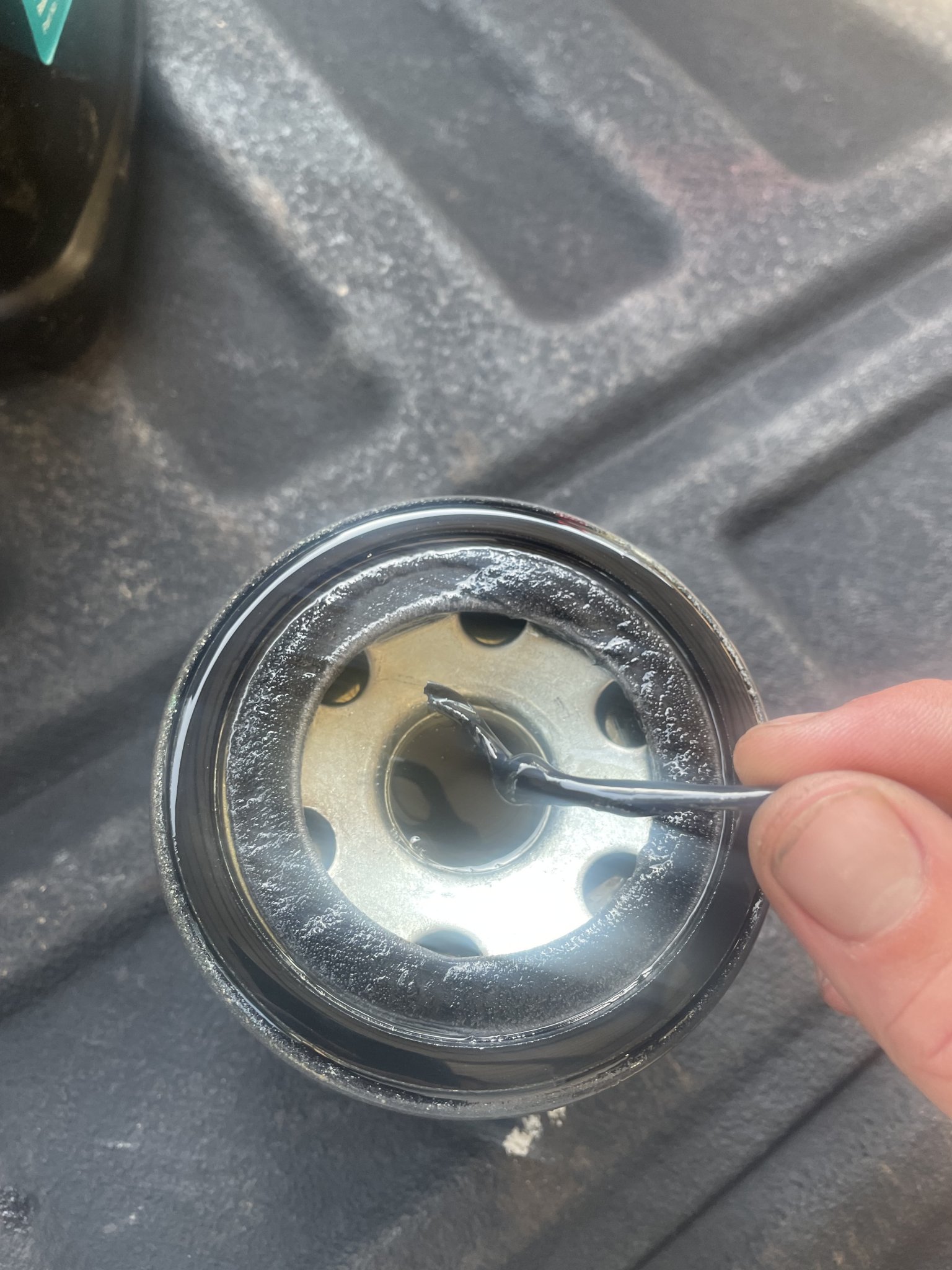

I just did the 50 hour service on my L3901 and when I replaced the HST filter with the magnetic ring on it I found a rubber piece sitting in the filter when I took it off. It is pictured below. Anyone know what it may be?

The new filter I put on had the magnet on it. Didn't lose but about a quart of fluid. I just was shocked by the rubber piece. It seemed like a piece of caulk.
Perhaps it's a bit of silicone from the assembly process?
Don't think I'd be concerned.
Good Luck!
6,468
3,860
Finding particles in a factory-installed filter doesn’t mean much. Those are from the manufacturing processes. That’s the reason they want it replaced at 50 hrs.
What would be concerning is finding shavings in subsequent filters.

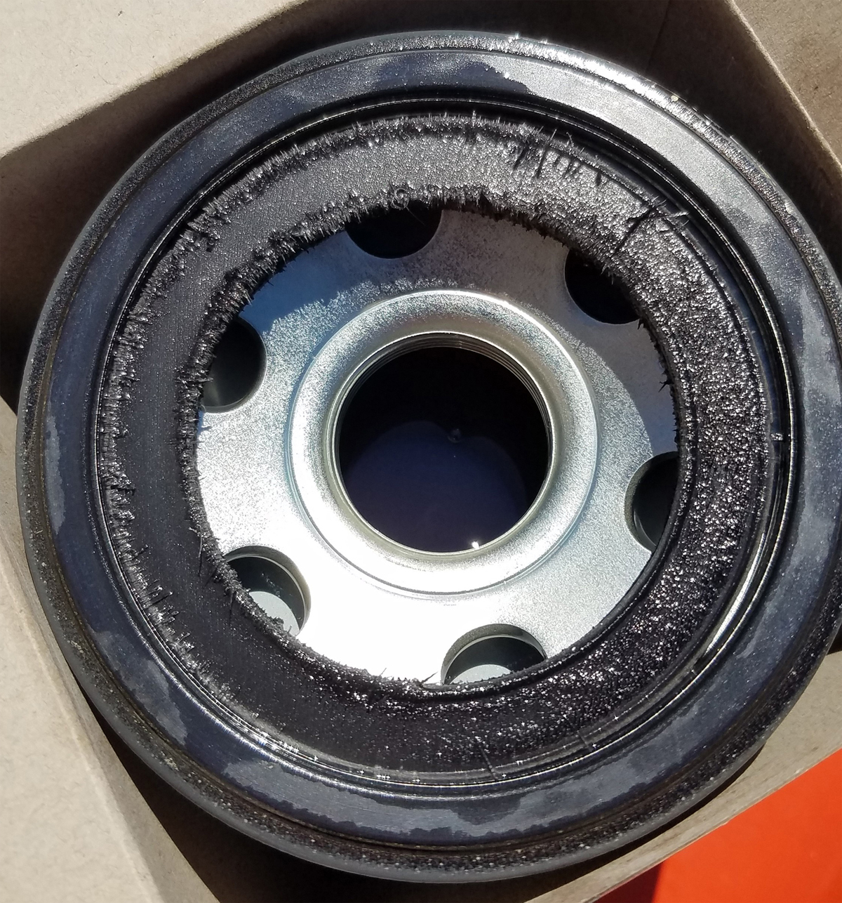

I understand the "peace of mind" approach to changing the hydraulic oil at 50 hours but I haven't done that on either MX, just all three filters. This is how the hydraulic filters looked at the 50 hour mark. I asked the local dealer about changing the hydraulic oil at 50 hours and they don't even change the filter at that service interval.
