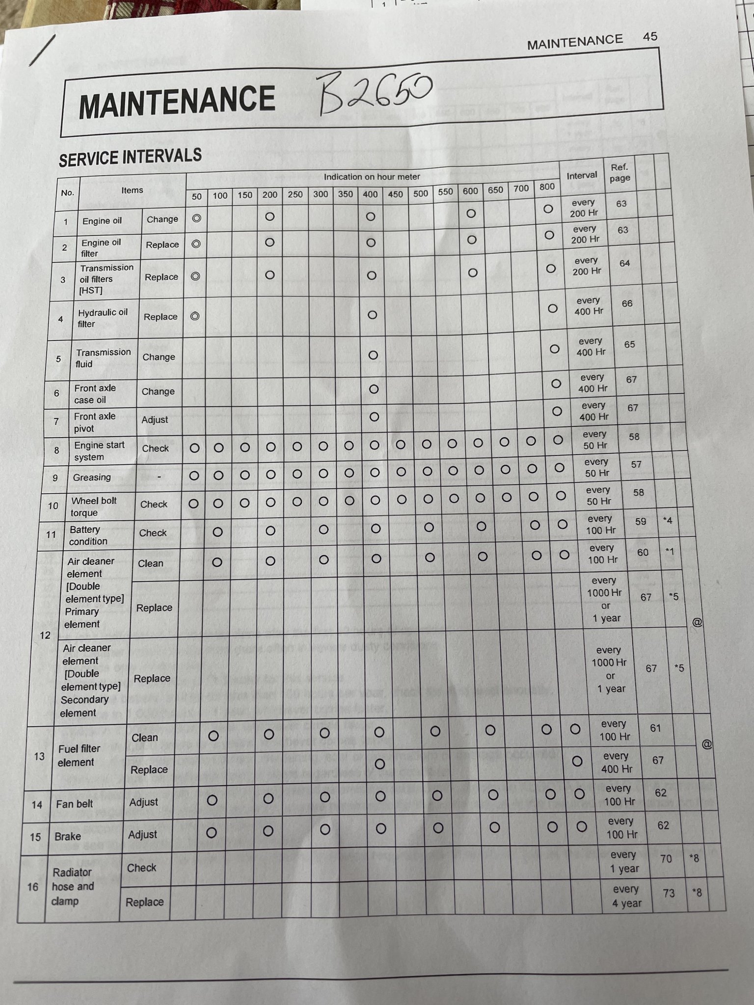

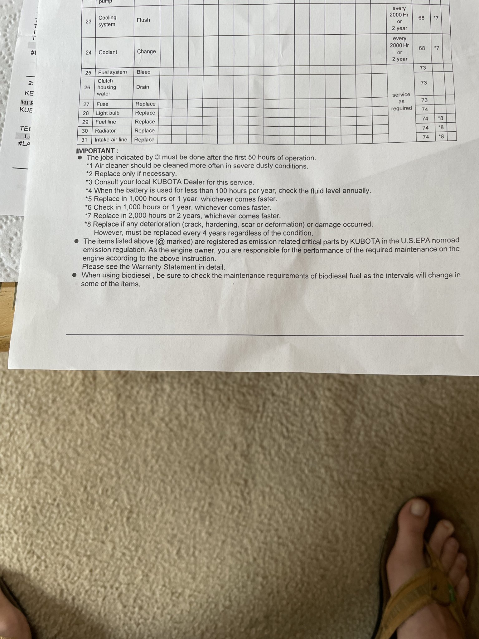

I am not sure what is right or wrong, but this is my understanding for the B and MX. the double circle says ‘must’. (There is a second page for both not attached but regarding the oil and filters you can see the reference. I don’t think it would hurt anything to do more than the minimum recommendation.

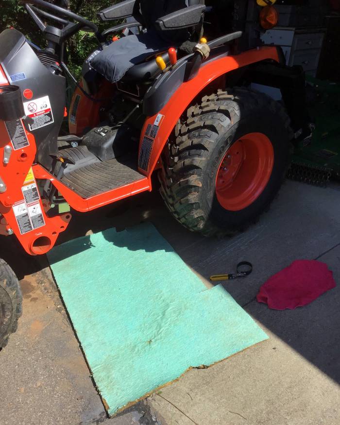

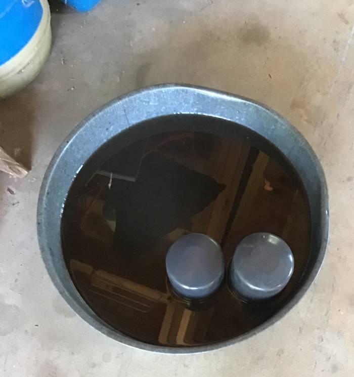

Did the HST and hydraulic filters this morning. Parked on the ramp into the carriage house with the rear up for gravity to help reduce oil loss. Didn't help much. The HST (#670) on right still gushed a lot of oil. The hydraulic filter, not so much. Ended up losing 3 qts, just what I had left in my UDT2 container. One picture shows the drain pan holding the filters and the 3 qts. I used my smaller oil filter wrench on both. Used my old NAPA one on the engine oil filter since it has a tighter fit.

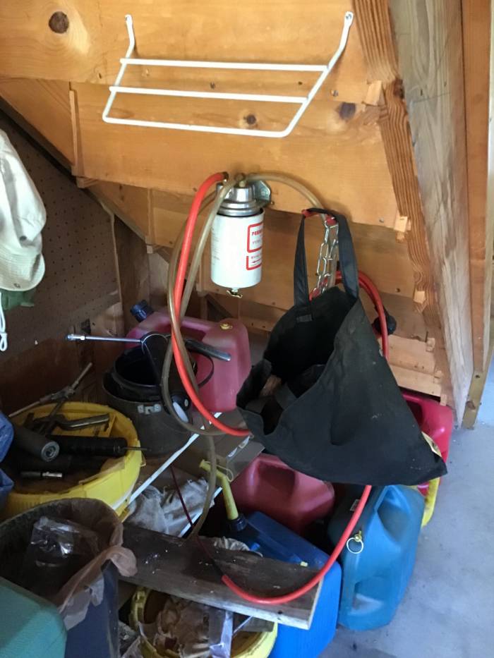

Another picture shows a rig I bought with the 1st tractor to filter diesel or oil. Don't think I ever used it before. Checked it and found it full of pretty good oil. Didn't muck with it this time since I had enough fresh fluid to top off.

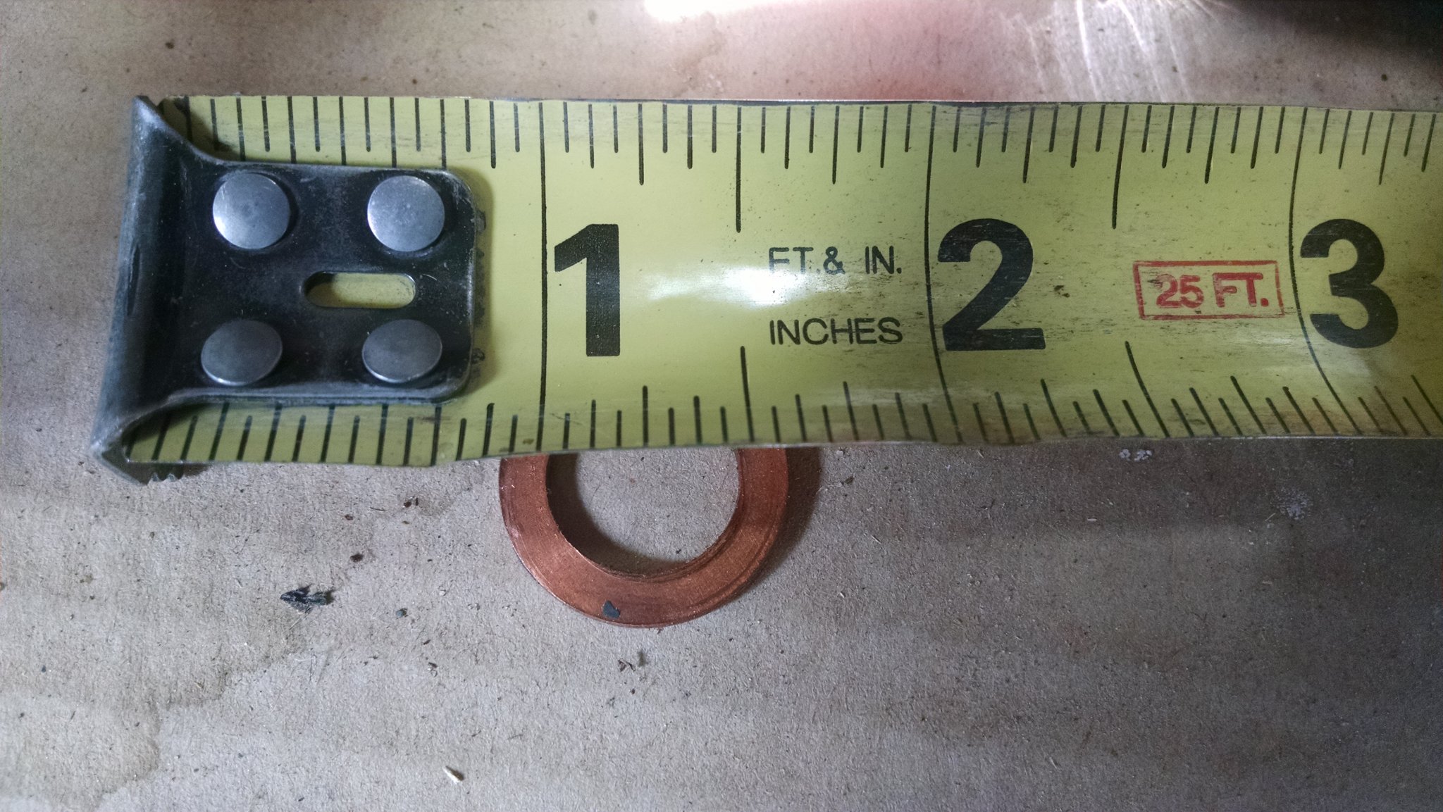

I had a couple drips on one of the oil drain plugs , my last oil change I replaced the brass washer thing. It was clearly the wrong size from factory. I change the engine oil once a year regardless of hrs. Past 3 have been 50 to 60 hrs.
