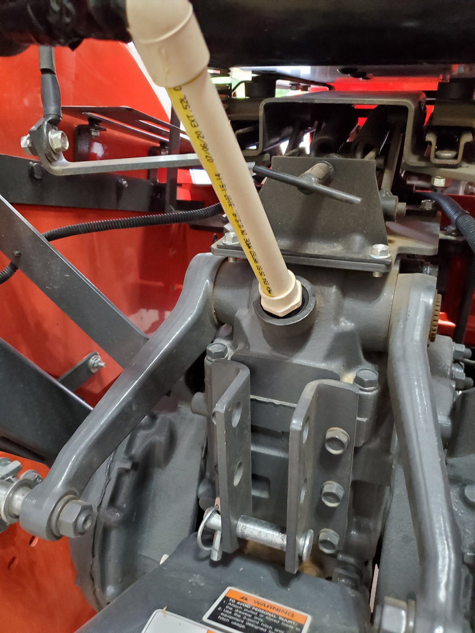

I also used the shop vac trick, used a piece of pvc to fit to the oil fill. Worked like a charm, lost about 4 drops.

Could just be that it's a Sunday night and I'm a bit fried but what is the shop vac. trick...?
THX

Just saw ontheridges post & pic. I infer that you use it to pull neg pressure on the sump?
Exactly, I used the pvc pipe in case the fluid rose up some, so it did not get in my shop vac. Attach it, turn it on, pull filter, no leakage.

Nice - thanks for the clarification. I have been working on old cars and in that hobby for many years and never heard of this.
The dealer just told me to drive the tractor up on a 2x6 board on the side of the filter to tilt it slightly away from the filter. He said that works as well as the vacuum method and it’s simplier.
