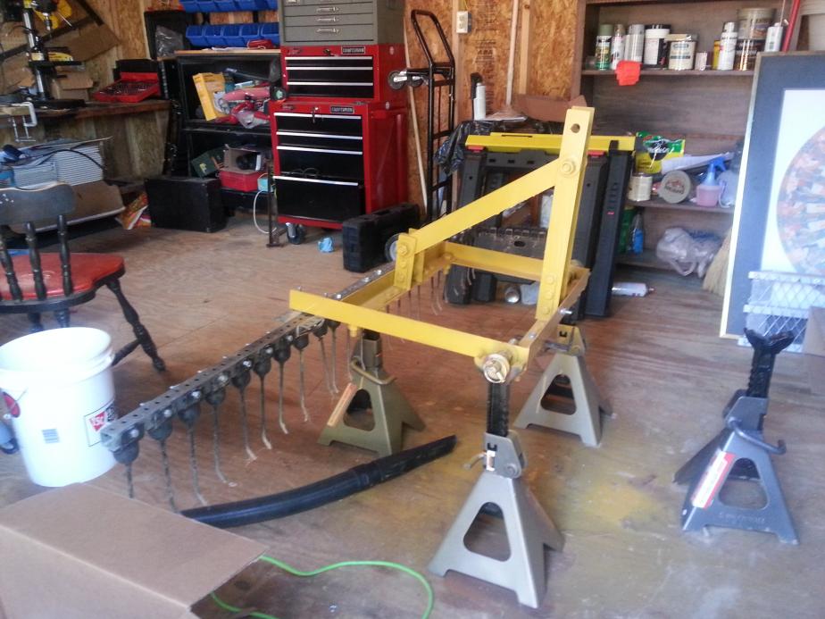

I made this rake to get up pine needles. The rake teeth have a little bit too much distance for pine cones however.

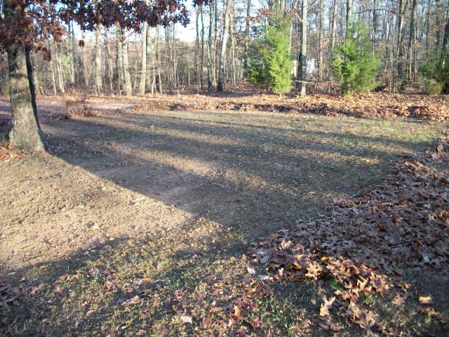

I purchased my Pine Straw Rake from Everything Attachments for leaf removal, very pleased with the results.
Thats pretty impressive. How many passes with the pine straw rake did it take to get all the leaves up?
