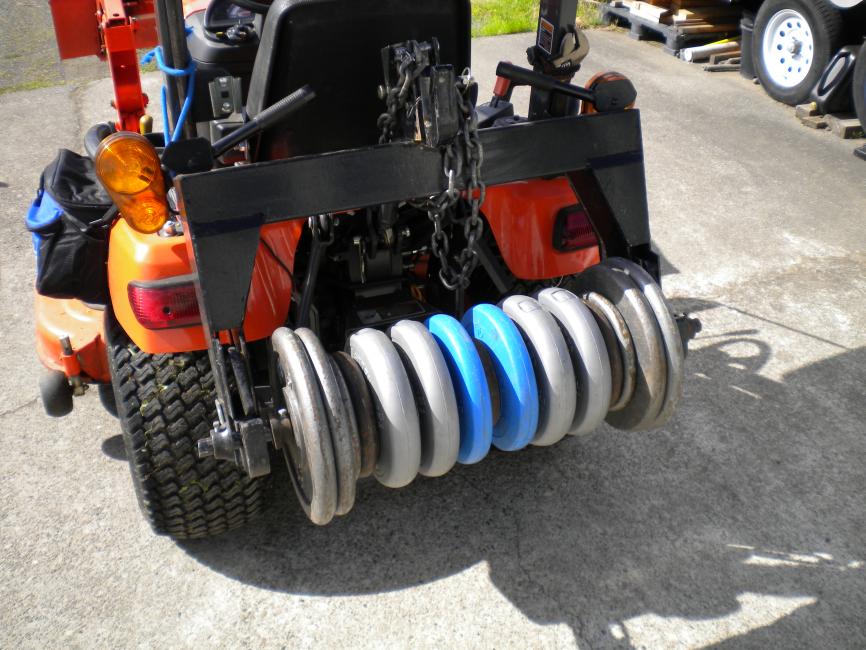

You could buy a quick hitch from Harbor Freight for about $75 and add bar bell weights like in the attached picture. Mine has 230 pounds on it but if you could put a lot more on it if you have the weights.
