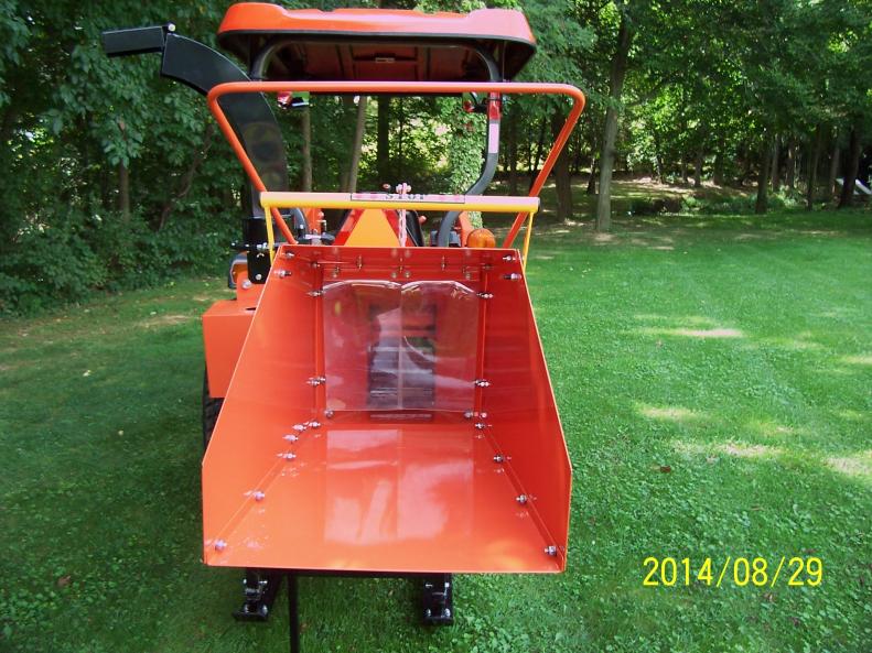

Well, after trying to see all the pros and cons and seeing that a Wally is the choice of many, price tag made me shy away. I think I got the best bang for a buck with the WoodMaxx. Gave it a workout after putting it together on a pretty large pile of, up to 3½", very dry and hard limbs from last fall. Knowing that dried wood is harder on keeping a good edge, they still needed to be chipped. Very impressed with the results.
Ron
