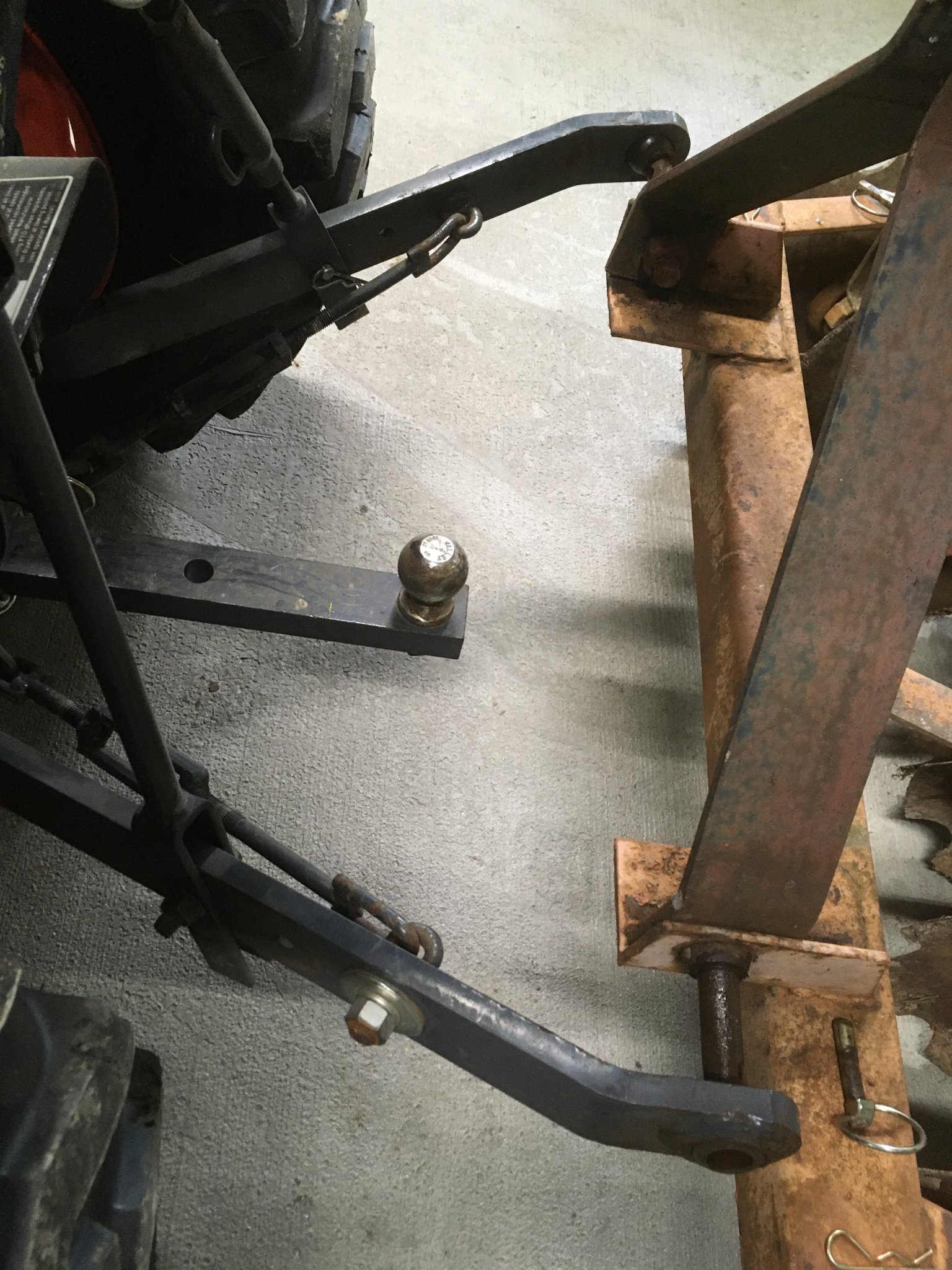

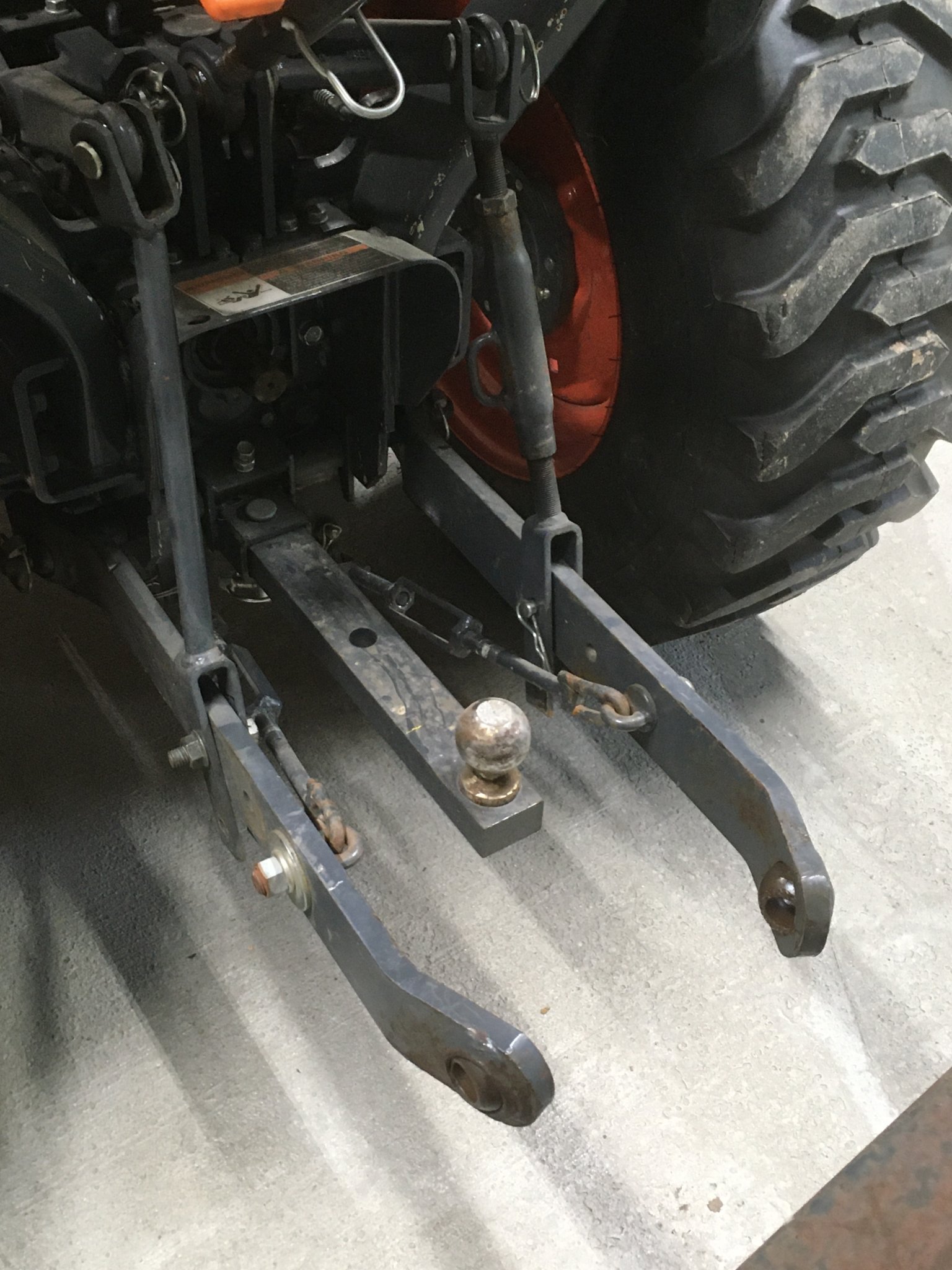

hello newbie here to this forum, I have a B2320 and my lower link arms will not stay separated but fall together almost hitting each other and that makes it difficult hooking up to the 3 pt what can i do the prevent this from happening or is it as simple as putting a board in between them?

You should have either turnbuckles or a sliding bar with pins on both arms. You can adjust them to hold the arms wider than needed until you are in position to attach the implement. Another tip: buy a 6’ digging bar to use to lever your implement into position for attachment.

thankyou for your reply, those turnbuckles you mention are all the way loose, if tightened it would bring the arms closer together. With the turnbuckles loose - the arms just fall back to center when I let go. There is that little weight on the tractor end of those turnbuckles that seem to be pulling the arms inward when that weight falls down??? I may have to use bungy cords to hold the arms apart?
6,424
2,056
You can just hold the arms apart with bungie cords or a board.
Be careful the arms can’t get into contact with the rear wheels and damage the arm, tire or tractor

Your B2320 has turnbuckles, inside the lift arms. You need telescoping stabilizers to keep the arms stationary.

Telescoping stabilizers will accomplish what the board is doing. They are rigid mount, vs turnbuckles. You can adjust the arms wide and pin them.
It isn't necessary for your arms to be spread wide, past the link pins, to hook up an implement. Lower your arms to just below the frame/link pins, and back up until the arm ends line up. You can then spread the arms and manually lift them onto the pins. You can definitely hook implements up that way. With telescoping stabilizers on my tractor, that's still how I do it.

Id like to thank all posters for your help and input. Looks like i will just have to use bungi cords or the spacer board to hold the lower arms apart when hooking up to 3 pt. I will also look into getting the HF quick hitch. With the quick hitch, is the top link still adjustable to tilt implements?
