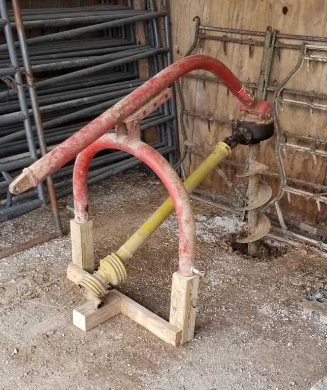

Here is an example of what I did for a post hole digger. I made a platform on a pallet for my gravel/snow blade, and all my other implements are on pallets. I have pallet forks and can move everything around to get it into position. Food for thought pallet forks are awesome.
