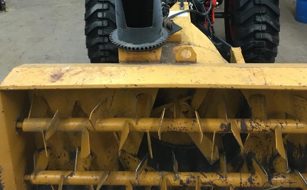

Here's an idea to ponder. My Lorenz is made in the way you're planning or thinking about. Instead of spiral auger/s mounted and rotating there are offset metal paddles angled to pull the snow to the center. Those individual paddles really chop, bust up, and break up hard packed snow or most anything that gets in front of it. Instead of scraping snow to pull it to the center the angled paddles will bust the snow into small chunks and move it to the center. It really does a fantastic job in that regard.
You might modify your augers like your thinking, with something similar. Or you could think about fabricating two new augers to take their place. Just an idea an food for thought. Here's a pic I found and cropped to show the business end. If you'd like something better I'd happily take something better for you.
