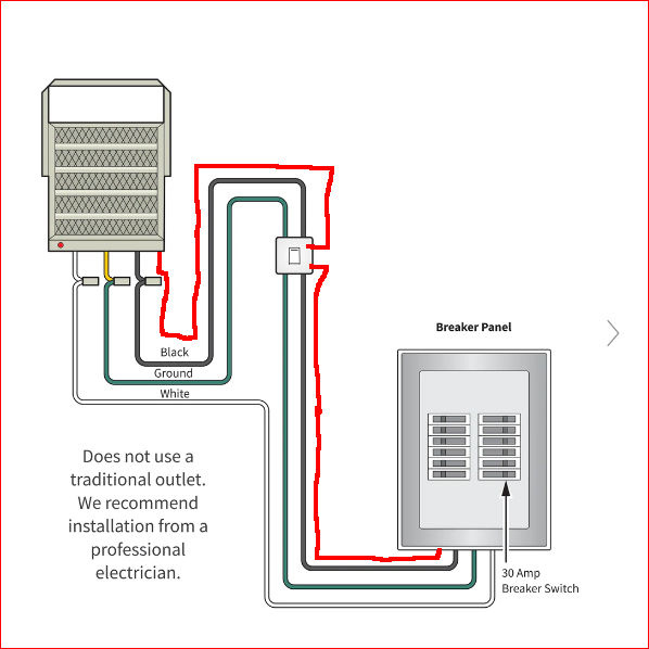

You will need 2 separate 30 amp circuits. Each will have a double pole 30 amp breaker - in your case with 4 wires, you will have a neutral and a ground. Much like a new dryer.
Here is a little more info - but it shows 3 wires,
Your plug will typically have the red where the white is in the above diagram..... and the white will be the neutral,,,, green the ground.
Open the back panel and see what left to feed the cord.
O - and yes 10-3 wg is a must.

This would be a 220V Wiring diagram
And here is the switch you want:

85Hokie hit the nail on the head. You are going to need a 2pole 30amp breaker and 10/3 wire with ground for each heater. Breakers and fuses are typically designed to be loaded at 80% for continuous duty. A single 5000 watt heater will draw approximately 20.8 amps at 240 volts. Hopefully this helps answer your questions a bit.
