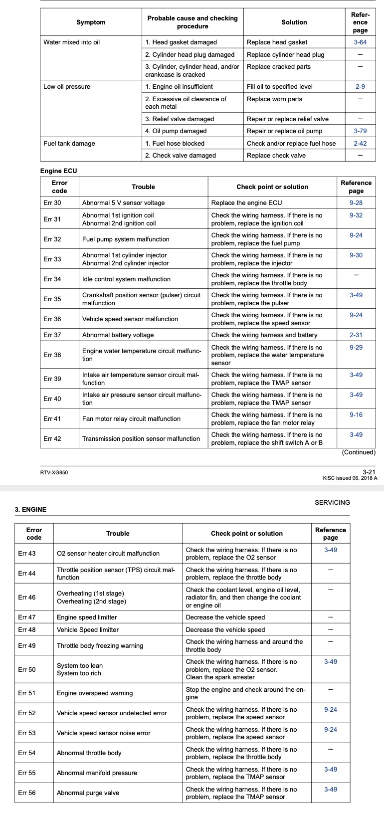

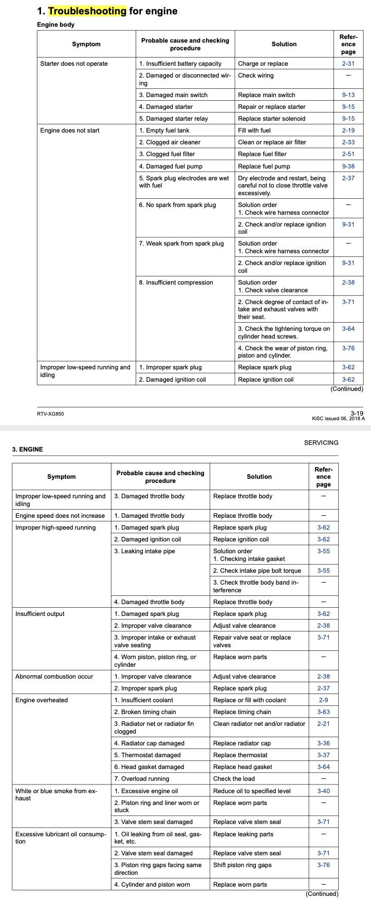

Are you getting spark on both plugs?
Out of curiosity try pulling one plug wire and see if it runs any different. Then plug back and try the other one.
My daughter's car with coil over plugs started doing that intermittently. Was a bad coil, would work for a while then suddenly lose power and run rough.
Hopefully these are readable
