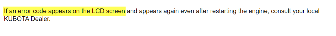

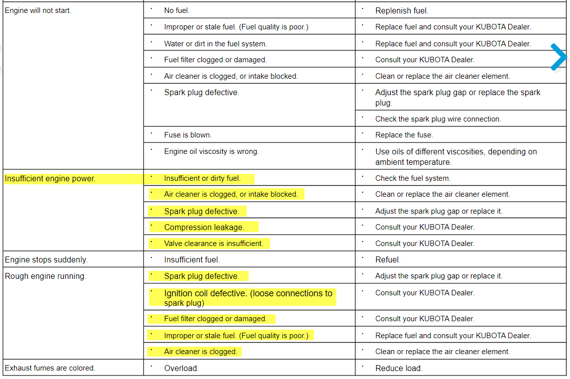

From the manual:
Are you getting any codes?
Only thing on this list that wasnt mentioned already is the fuel filter. I dont know if you have an external filter or just the sock on the bottom of the pump. I dont see an inline in the parts diagram.
Tests I mentioned earlier helps narrow this down. You should be able to get an inline spark tester that works fine with that coil. They are like $5 at harbor freight.
Your air intake repair wouldnt have caused your issue, by chance? I dont know what you repaired.
