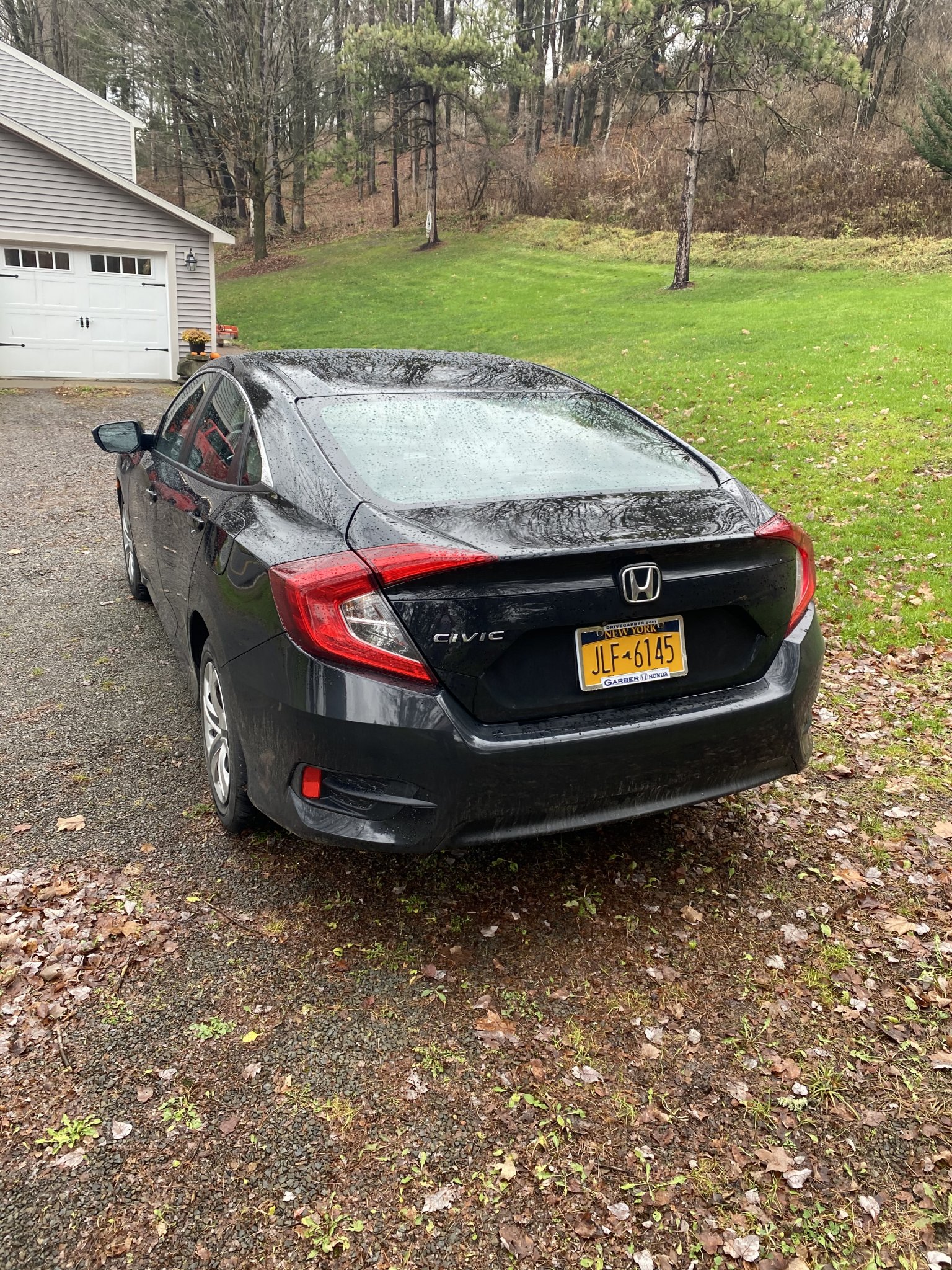

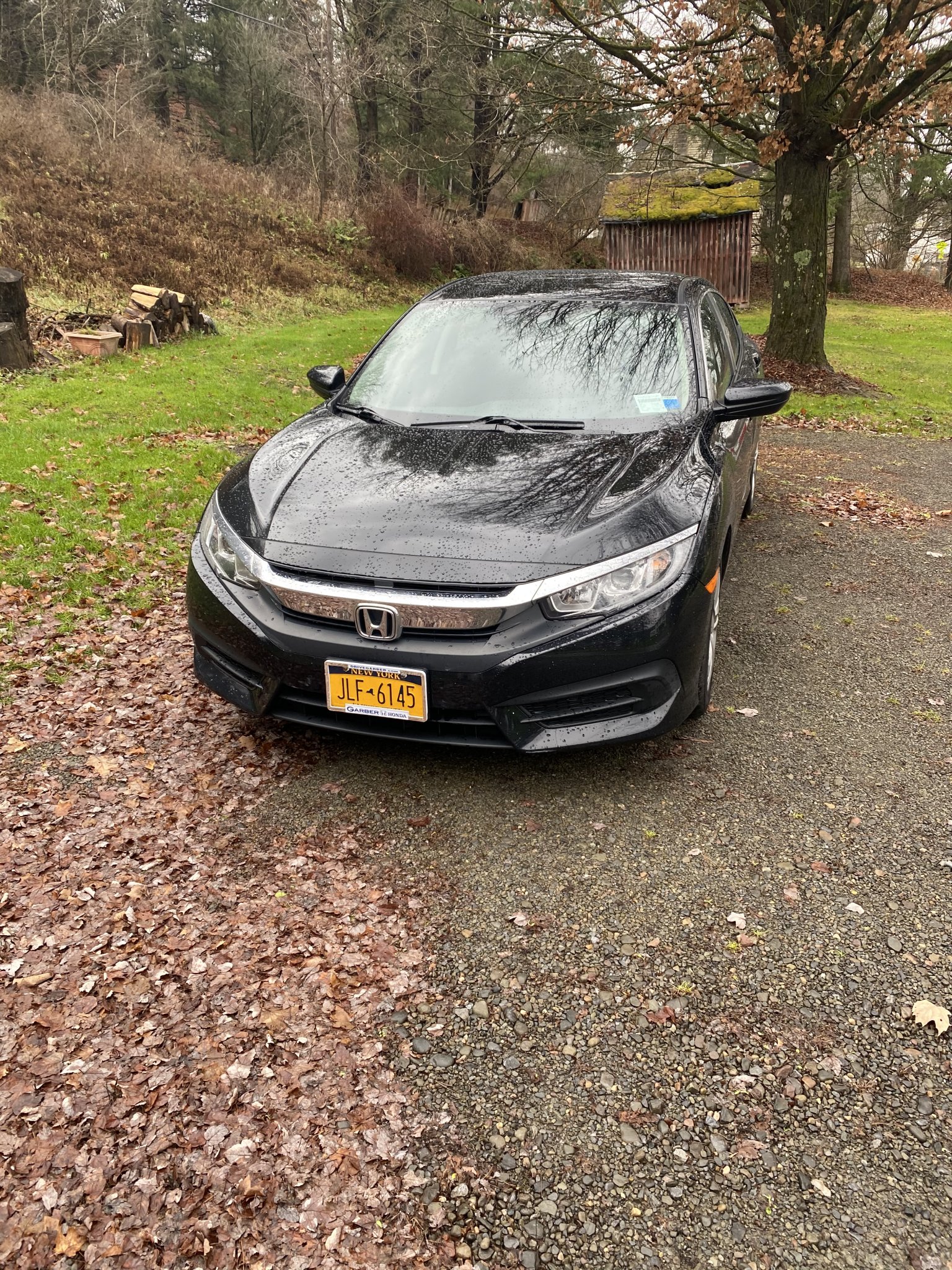

Yeah. One of his housemates is a Ford tech, but not “The” Fordtech we know. ;) He helped a lot.
My son was home a couple days...just got the replacement Honda the other day. . Been dinking around with it a while.
Not sure I'd fit in it, and he's 6' 5", but he says it's comfortable.

Nice car, you can't go wrong with Honda or Toyota, both are pretty much bullet proof.

Fitting in it isn't the issue. The seats go back to where you or I are driving from the back seat 😁😁😁😁😁
It's getting out and being able to keep the knees on your pants clean thats the issue 😳😳😳😳😳
Wifes old Mazda 3 sat low like the civics. I had to roll out of the car after a long drive. Then stand up.

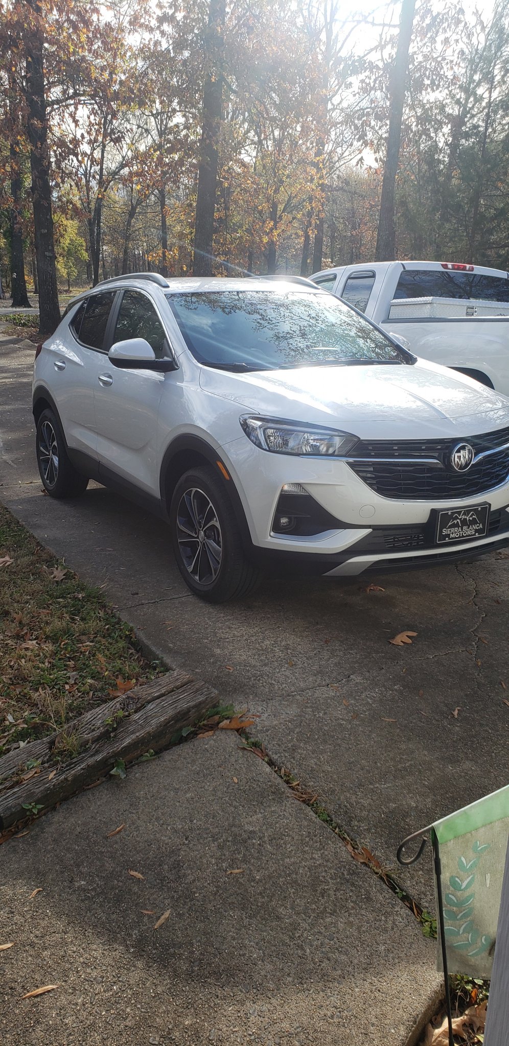

Beth got a brand new Buick Encore GX for my birthday 😁😁😁😁 It's about the same size as the Rogue.
