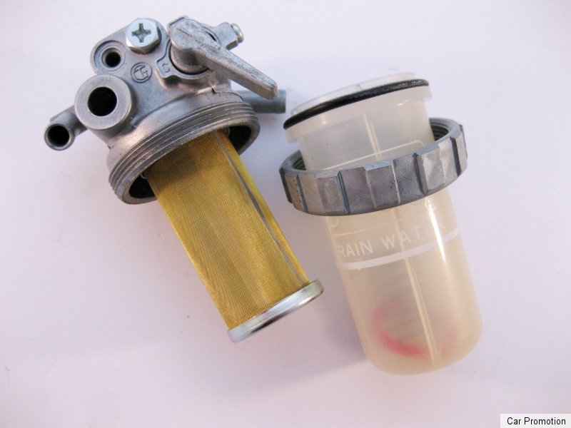

Thanks Nicksacco.....I'll leave that to others. I already have too much to do. But the protective adds are really necessary to protect all of those rods, cables, hydraulic lines and filters, gas tank if you run through rough stuff bush hogging old pastures. Clean pastures, plowing, etc. probably doesn't require any protection. I'm missing the O ring on top of the plastic separator. Very likely that is where the air leakage is. 1917
I have had that style filter fail several times. Try to turn the inlet and outlet fittings and see if they move easily. If they do, fill around the base of the fittings and the filter housing with JB Weld, let it set up and see if it will run. If the problem goes away, replace the whole thing. It will vibrate loose and do it again. The symptoms you describe are similar.

There should be an o-ring on top of the water separator cup that seals it to the metal housing, there's nothing between the cup and the spin-on collar.
THIS^^^^
I suspect your entire lack of fuel to the pump and fuel pressure downstream is because it’s sucking AIR due to no O-ring at the separator.
<edit> Ooops.… I see you’ve followed tigers’ advice.… I posted reply before reading all the way thru.<>

I did that very thing GeoHorn except I used irrigation pipe glue....it is really thick and sets up very quickly yet remains a bit pliable. There is no way it can be sucked into the fuel system.....but, the missing O ring was the problem. And I had tightened the metal band tight....flat blade screwdriver and hammer to tap it tight. Still didn't work. The O ring works perfectly and only requires hand tightening. I guess I had dropped it some previous time and didn't notice. Sure would be helpful if the dealer would suggest a few things like the O ring when a customer comes in explaining the problems and purchasing new and expensive parts. Again, thanks for all the good ideas everyone. 1917
