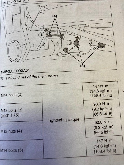

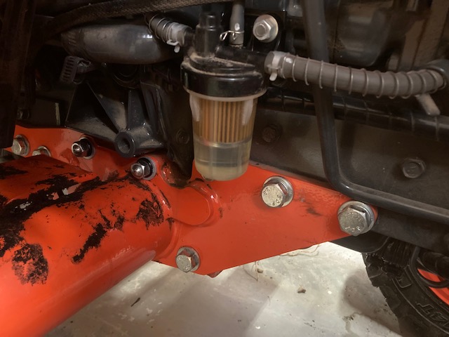

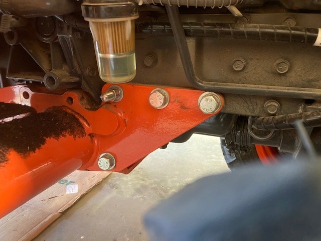

I guess I'll round this off. I regret that this thread's subject line reflects where I started—learning to use a torque wrench—and not where it went: discovering a missing bolt, having the dealer install that bolt, and finding the new bolt loose.
Today I checked all the loader subframe bolts, about half of which seemed fine and the rest loose. The new bolt and the one they moved next to it, farther to the rear, are real bears to work on (see middle photo, below).
The farthest rearward bolt, the one that wasn't tightened at all but at least now exists, is crowded by a bracket. It is impossible to get my torque wrench between the nut and the bracket. I had to lie on my back and use a regular wrench to tighten it. Maybe this is why the tech didn't tighten it.
The bolt in front of that one is right above the big round tube that's the bottom of the loader subframe. My torque wrench can be used but it contacts the tube. I doubt this enables an accurate torque reading. So I just got that one tight too and let it go.
The first photo shows my loader manual for the location. Next is the fix with the new rearward bolts that are hard to work on. The bottom is what I initially found.
