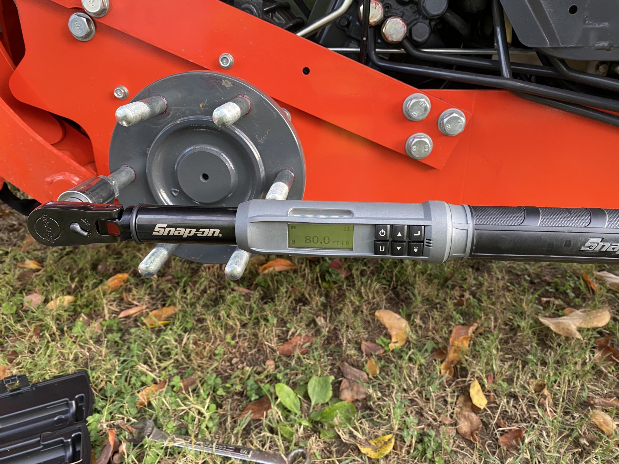

3BF23086-984F-44B7-AD39-9ECE34F0BEBF.jpeg Love mine. Just have to remember to take the batteries out every time in done with it. Ever have that issue yet?

View attachment 69507 Love mine. Just have to remember to take the batteries out every time in done with it. Ever have that issue yet?
No I haven’t, I take the batteries out of them every time I put them away. Only issue I had was with the original Snap on one, the battery cap and handle was a crap design and the battery cap would come off under high load. They updated it on the one you have. I did trade out the original one for the newer version.

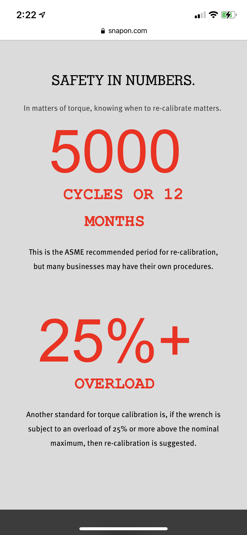

This is right off the snap on website, and you can also check it for calibration any time you go into one of the trucks. Where i live i see Multiple trucks a day, so it’s not bad 011D61E1-39C3-4E5F-BFC6-A6BC21821AE5.png
6,964
4,294
