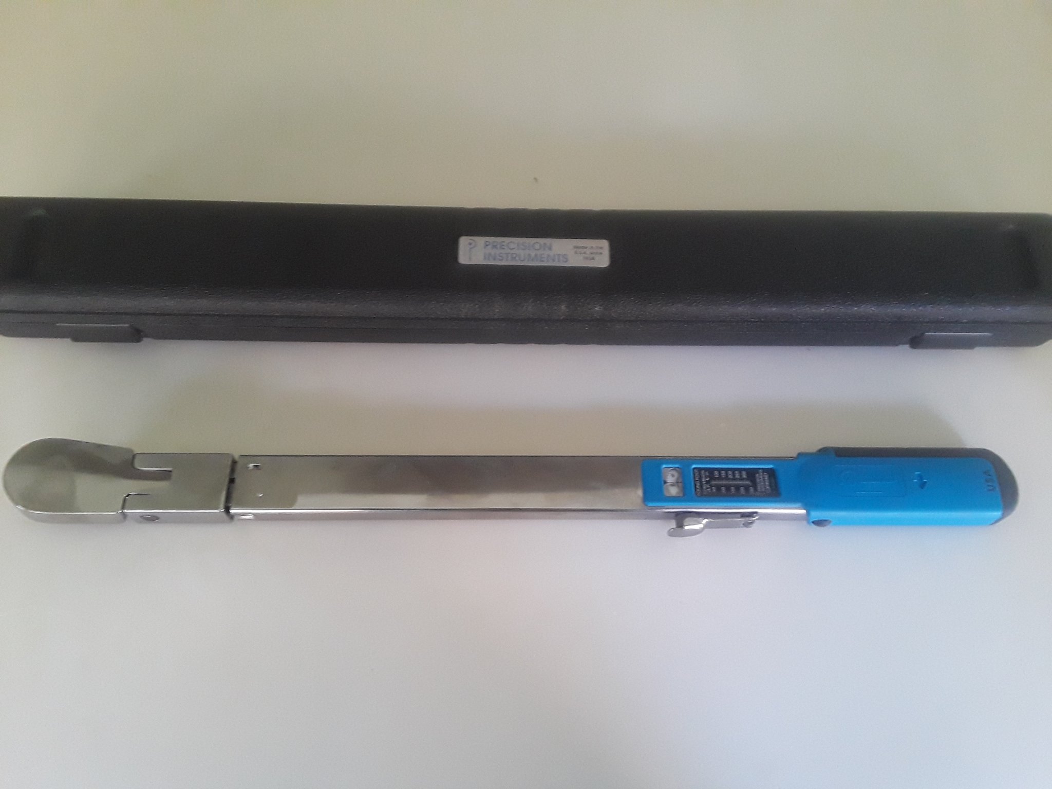

I own three torque wrenches and they get scant use. One is a 3/8" beam Pep Boys wrench, the second an old 1/2" micrometer Craftsman clicker that is a piece of junk, and this one. It is a "premium" split beam wrench made by CDI (aka SnapOn). It only works for tightening and has a torque range of 40-250 lb-ft and an accuracy of +/- 4% over the range 50-250. I seldom use it - engine building and alloy wheel lugnuts being the main use. It has no spring and maintains calibration well. You can store it set anywhere in the range. It is worth every penny I paid for it.

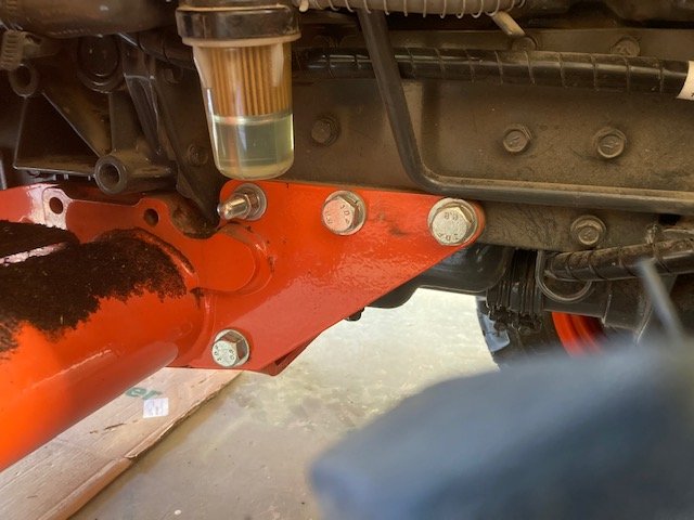

I got my torque wrench and checked wheel and loader bolts, discovering that there's a missing bolt on the right side of my loader frame. My dealer said the forward stud, which in the photo looks just below the fuel filter, is also out of place and should be further aft.
This is the third setup issue with my tractor and by far the most serious. These are loader frame bolts that attach to the tractor's frame! Thankfully my local dealer immediately came and got my tractor—their headquarters store a couple hours north sold and did setup.
The other thing I found is that all of the rear wheel bolts and most of the front wheel bolts would not budge. So they are tight but apparently over-tightened. I don't know what, if anything, to do about this.
