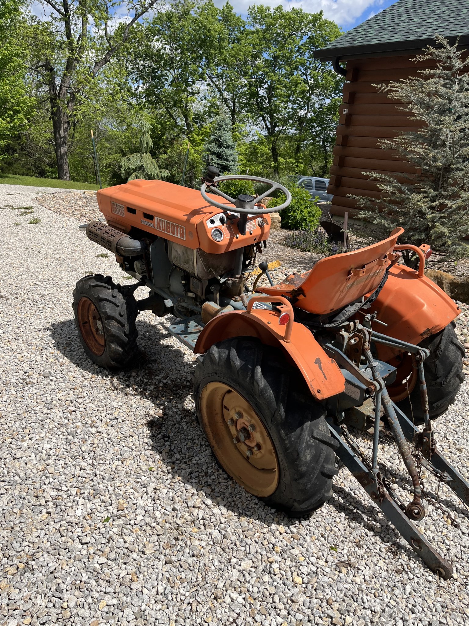

I have recently purchased a 1980 B6100 4x4. She needs a little TLC but this is what I enjoy doing. I'd like to find a loader and rear wheel weights. A rotor tiller would be good too. I'm in the Kansas City area but can travel for the right price/items. Thx for reading my ad.

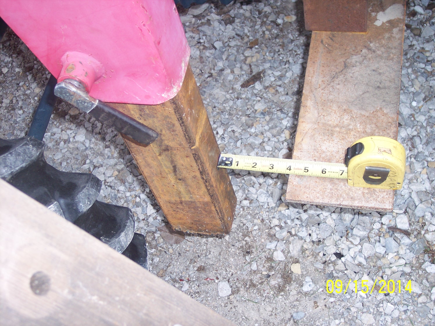

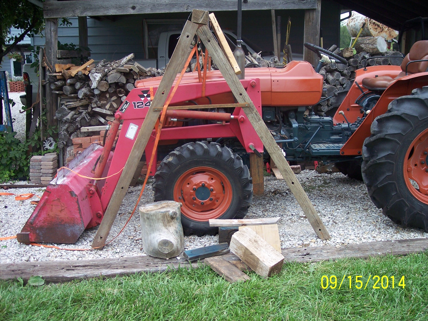

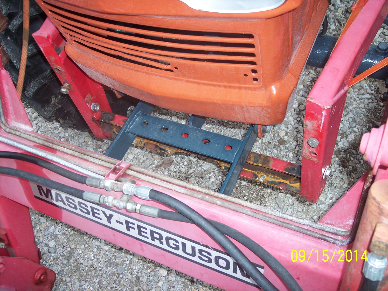

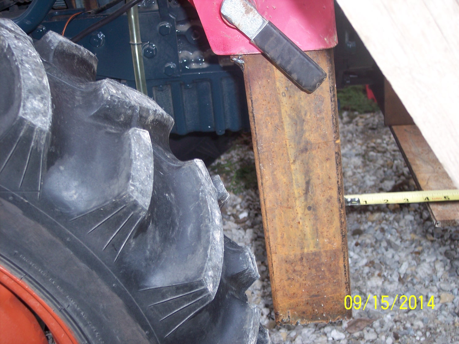

I bought a loader for a Massey and adopted it to an L305 a few years back. I had to build the entire mounting hardware.
You have to find a loader that has the width between the loader arms that are not too narrow and not too wide then start making parts. I remember the metric bolts used for attaching the frame to the tractor were over $125 back then.

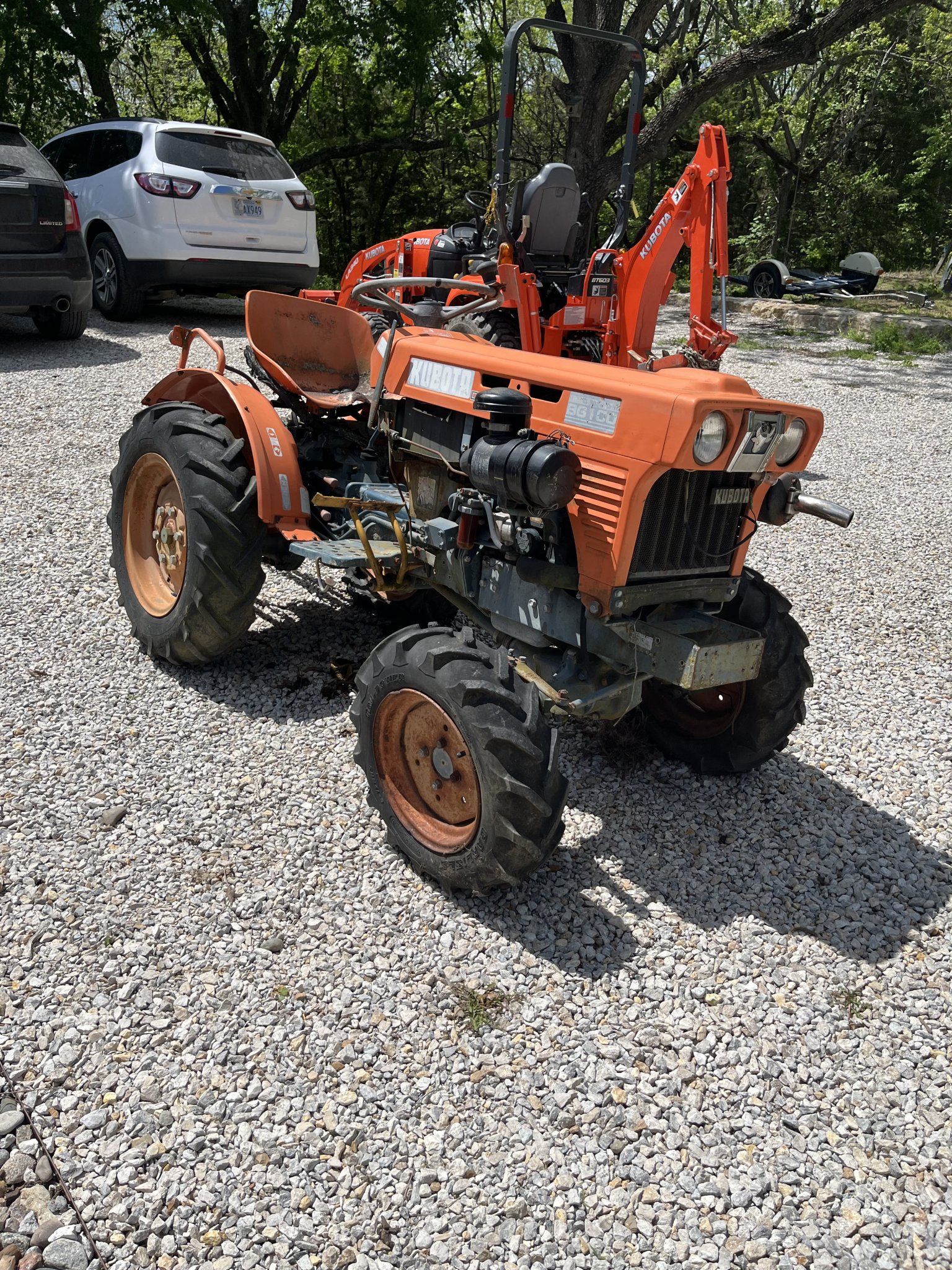

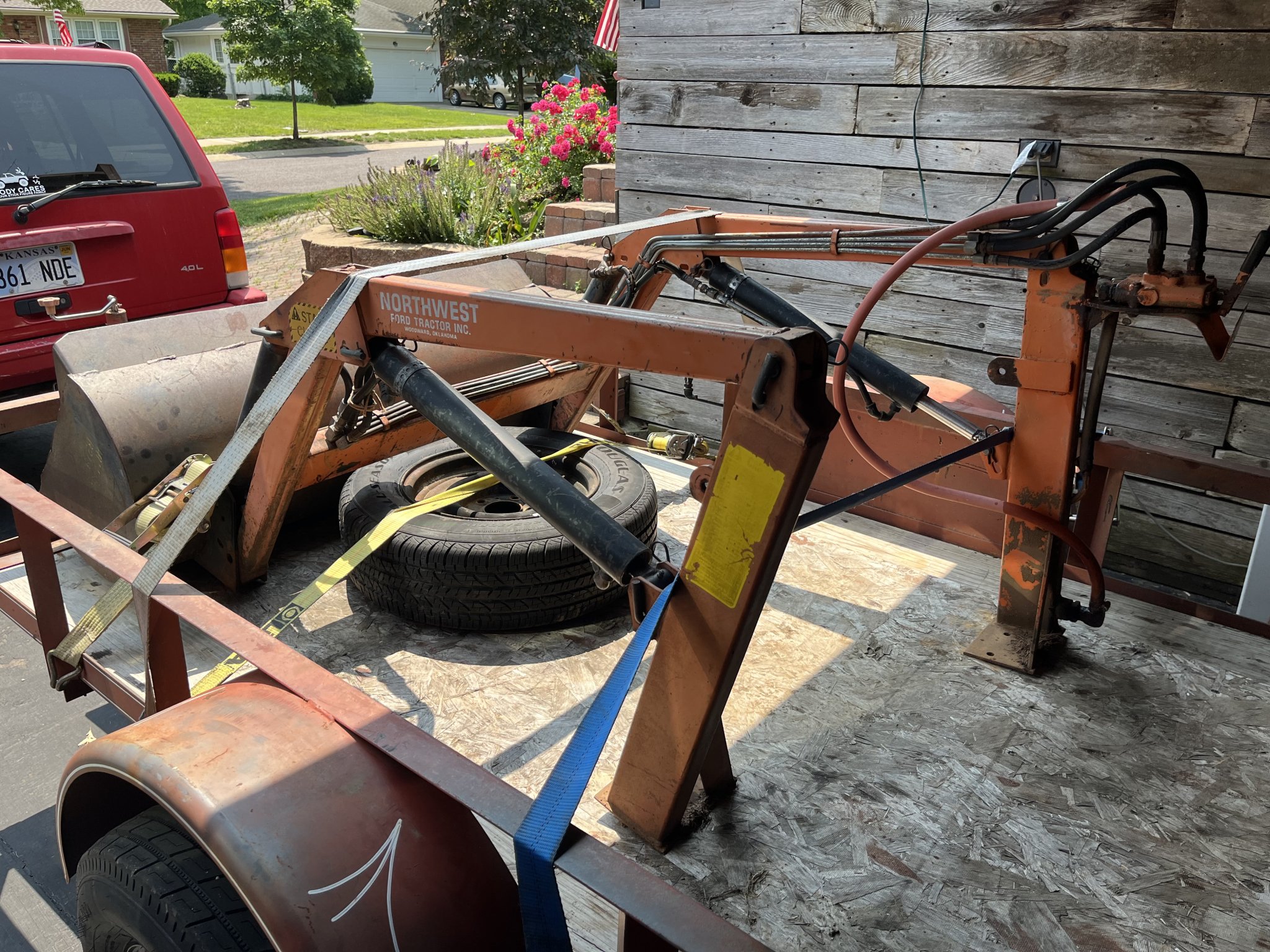

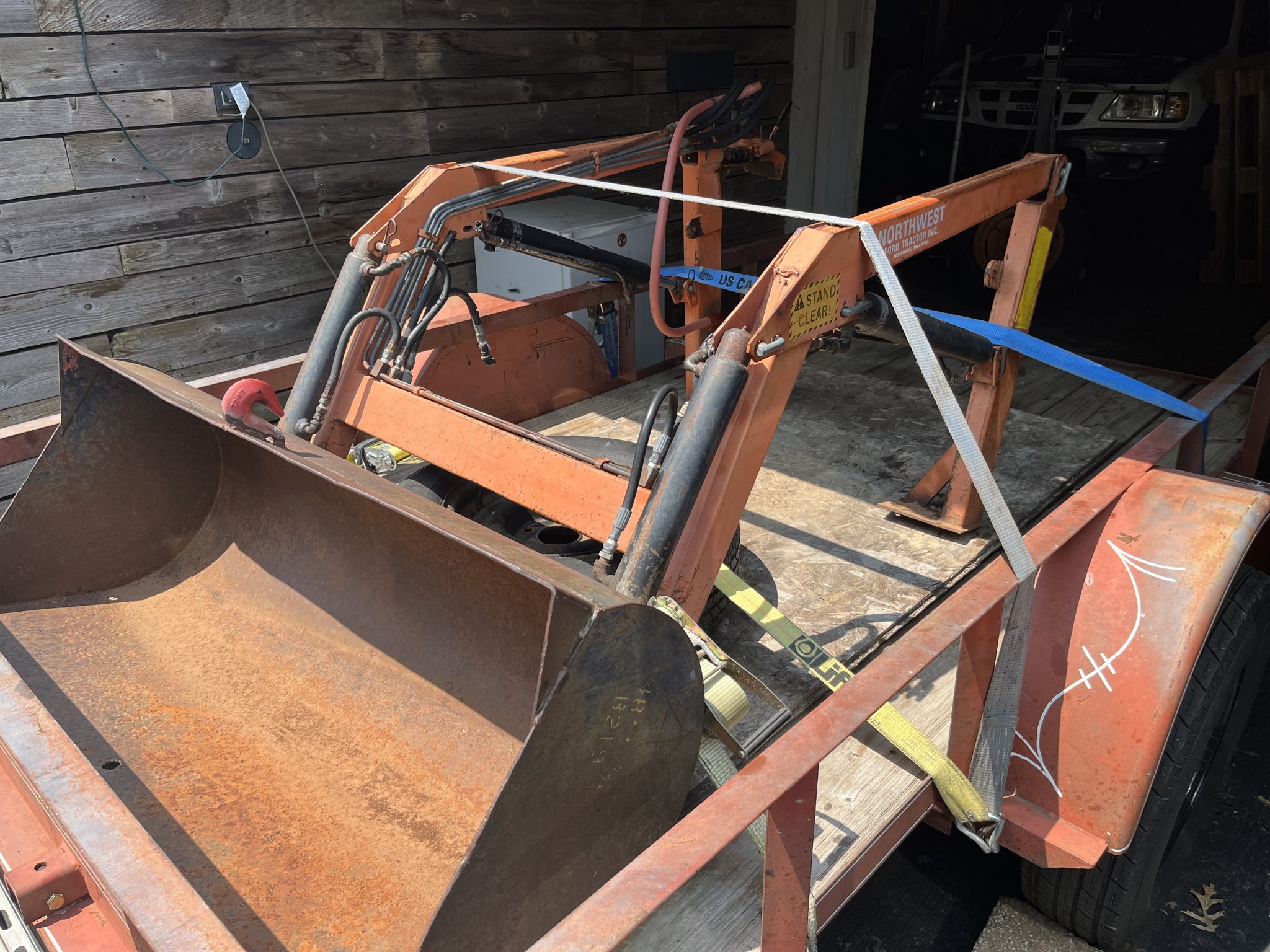

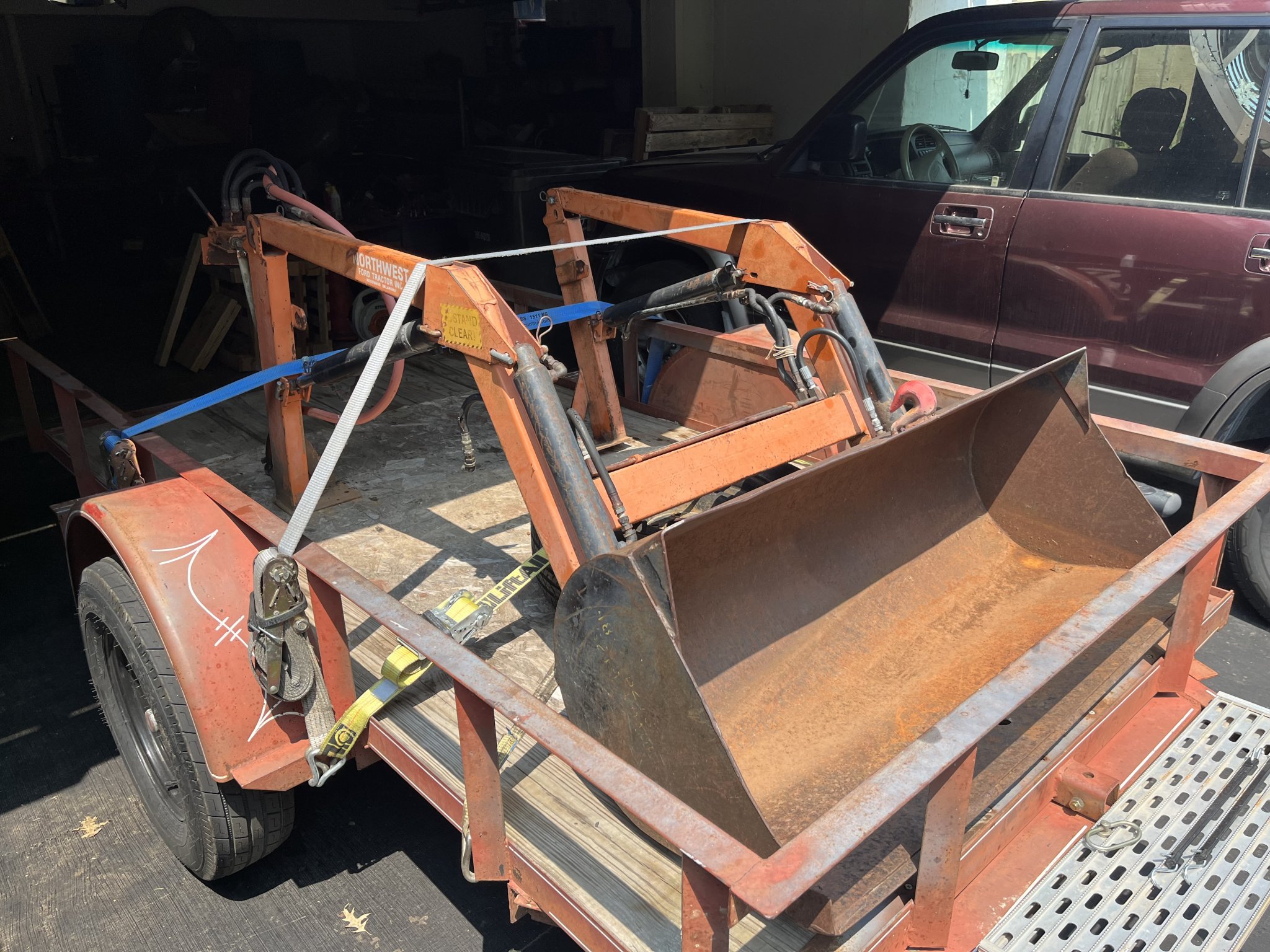

Found a real nice shape Kubota B219 loader in Oklahoma. Brought it home yesterday. Will build a subframe and re-hose the loader with a pressure gauge and return filter as well. The front spline drive for the pump is in great shape. I found a vendor for the drive attachment and pump. Will also be replacing the 2 lever system with a single 2 spool joy stick for easier operation. Things are looking up around here. 👍

Glad you found your loader and looking forward to seeing your build and progress.
Good on you for forging ahead despite the real or perceived obstacles expressed here. (y)
7,833
3,061
Congrats on your find, nice shape, not beat up at all!

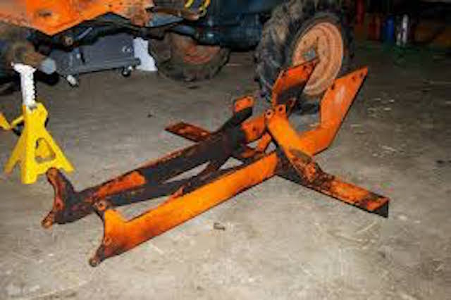

For reference, here's a pic of the B7100 subframe.

Appreciate the comments. I’m not detoured by nay sayers. Most that are like that have a high opinion of themselves and deflect downward to others ideas and suggestions. I’m the guy who is ready to prove them wrong. This is just another one of those times. 👍
Thank you. I’ll post pics as I move thru the process.

Congrats for sure! How far did you travel to get that loader?
I drove 380 miles each way. Yup, 760 miles which turned out to be a 17 hour day. Broke a brake line on my old Jeep which the seller helped me repair. Couldn’t ask for a better bunch of folks to deal with. But in the end I have a B219 loader that is in the back excellent condition. 👍
