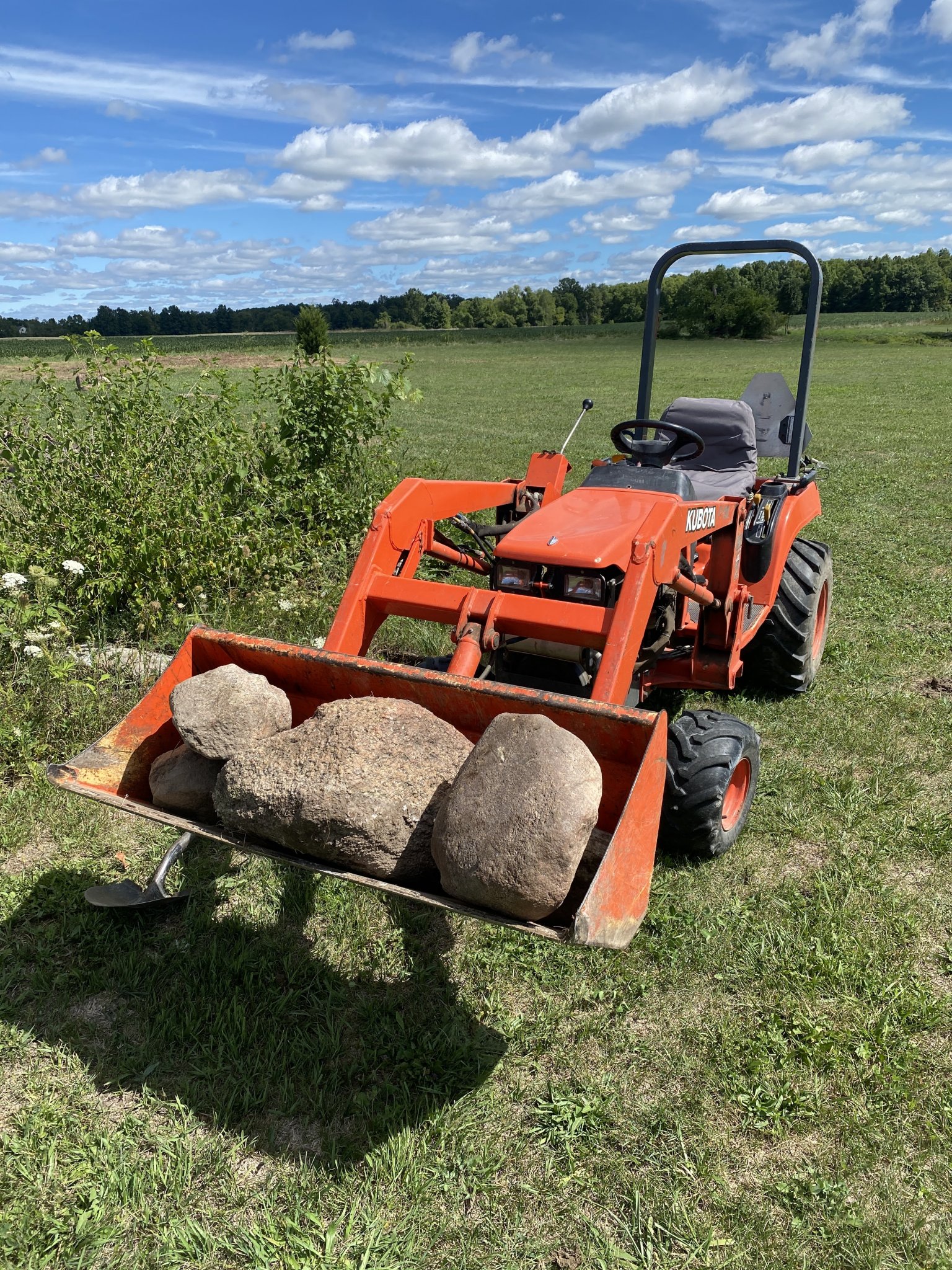

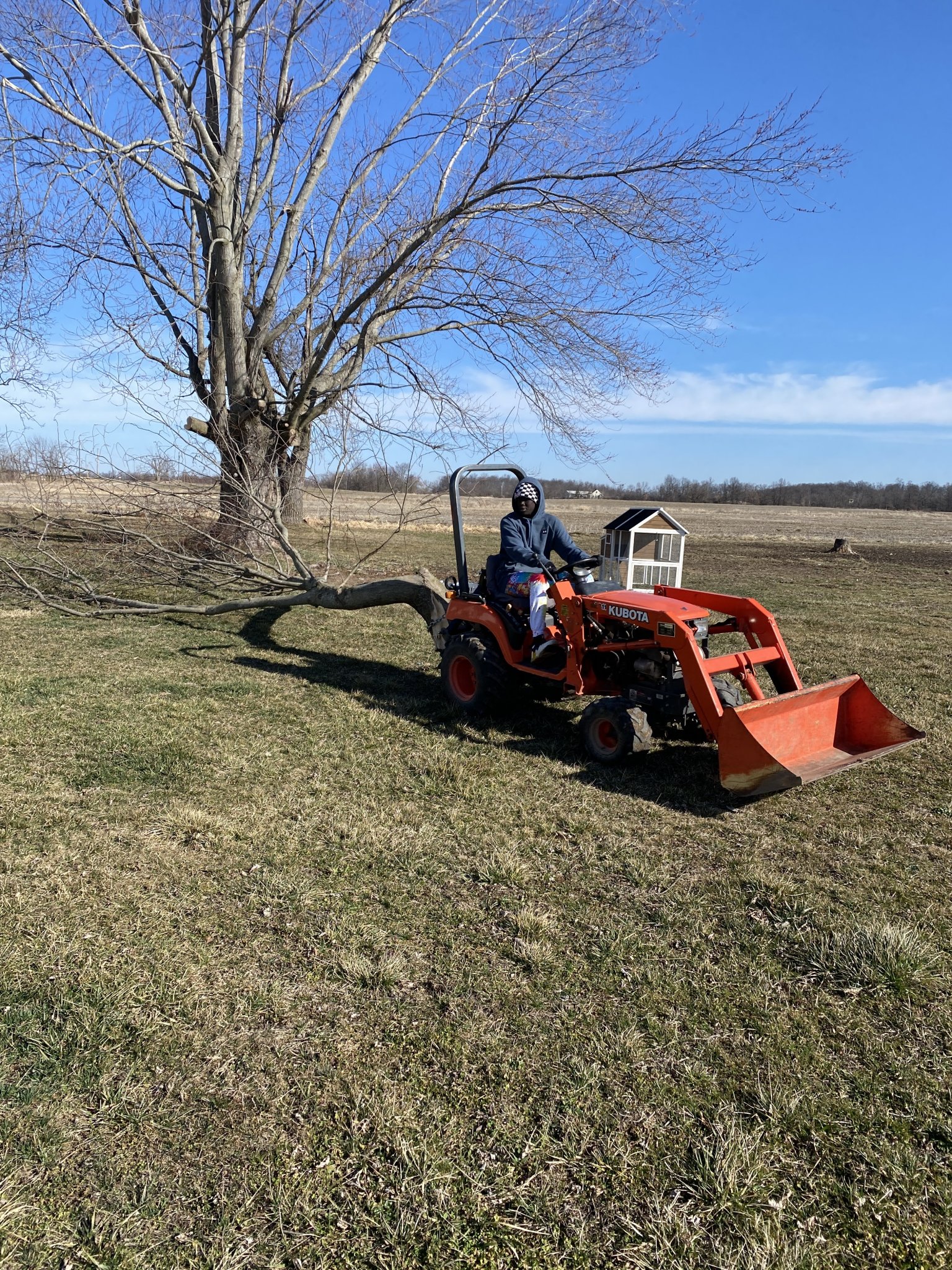

To give you an idea of work I have done with the BX. I have a lot more not listed.
My hillbilly dump trailer. Previous owner drilled a hole in the bucket lip. I use it to mount a trailer ball so I can move my trailers around and to make it easier to unload rocks and dirt. Just have to watch the weight on the trailer so I dont bend the bucket.
Spread 20 tons of topsoil with the tractor. Alot of it in the garden. Also used the tractor to clear the area (covered in brush), level the area (box blade), till it and drive the t-posts in with the FEL.
Bucket hooks to move/lift stuff

Just illustrating a lot of ways even a small BX can make life easier.....even on a small piece of property. Just depends on what your projects are.
Winter plowing area
Digging up an old stump. The FEL is not the best tool for the job, but I was able to expose the roots enough to powerwash the dirt out and cut them and then get it out.
Hauling a good sized tree limb that I cut out to the burn pile. The limb was hanging over the roof. Used the bucket hooks, chain and a strap thrown over a higher branch to secure the limb and have it swing out from over the roof when I cut it.
With it being old farm ground there are some areas with tons of big rocks piled up. FEL makes moving them around a lot easier.
