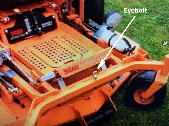

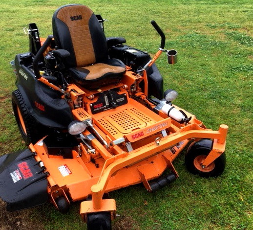

I use an engine hoist to lift the front of my Scag and just change the blades that way.
Just hook onto an eye-bolt I installed and lift it.

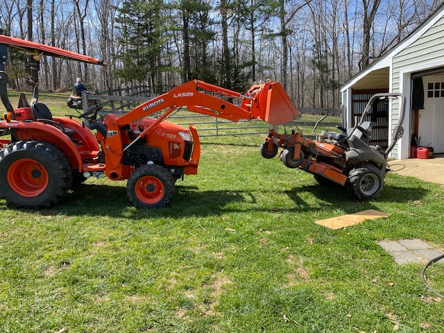

I have used a loader several times at the farm to do exactly that. I raise it up until the rear bumper is about on the ground. I rotate the spindles to get a feel for any problems with the bearings first.
Then swap the blades quickly without exposing myself to possible chain or loader failure.

Chain, battery impact wrench and two jack stands and I am done in a few minutes.
Great picture. That is about the same angle I lift my Scag using an engine hoist. Easy access to the blades. I don't give 'Blade Changes' any thought....since it can be accomplished in less than 10 minutes.
