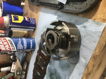

***129300; so here is the truth. I am in this machine for 2000. Motor runs great, but that alone won’t cut my grass. I can source a pump that Was working and is in a machine being parted out. Should I buy that disassemble inspect etc. it is like 500 bucks vs 1900 for the new.
I also need a charge pump and a back case plate as the shavings quickly destroyed the charge pump
Soooo..

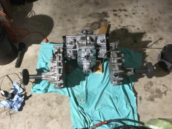

Are you recommending I dissembled the wheel drives of both sides and the HST on both sides?
This was my thought
Dissemble. Clean with brake cleaner get all shavings out. Are the bearings ok so long as they are spinning freely without wear?
Blow everything out with compressed air. Relube with Super UDT and then re assemble.
What is a good running zd 28 worth? This one has a pro deck and only 500hrs. I think I may be upside down on this project already. Should I just abandon ship and part this thing out?

If you try repairing it without replacing both sides with updated HST units you will soon have $3000 or $4000 invested and still have a non-functioning or crippled machine! If you put new HST units on there you will have a great zero-turn lawnmower for $6000- $6500 which isn't such a bad deal provided the rest of it is in great condition.

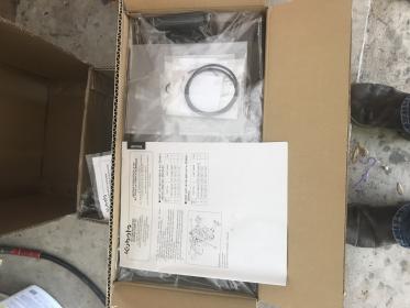

Ok so stopped into dealer today and asked what the cost for a new kit is. He said new charge pump, trans case, and hydro gears for both sides was $2200 in parts.
That seems to cheap to me? I ordered it and it should arrive beginning of next week so we shall see. It would replace all of the high pressure side hydraulics. Only leaving the final drive units, which do not share hydraulic fluid, and the hydraulic lift lever and piston which do share fluid.
Anybody done this repair? Does this price cost seem correct. I even asked the guy if I was hearing him right that 1 hydro motor is $1900 and that the complete transmission case with both side hydro motors is $2200. He said yes.

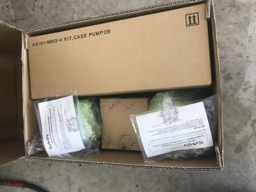

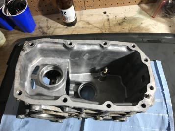

Well it arrived. With 2.5 gallons of super UDt and a new filter I won’t need the total kit cost me $2216.00

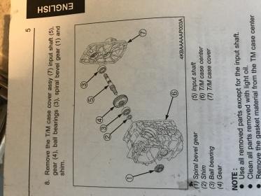

There are no bearings in the kit, but there is a new engine input shaft. Do you think it is necessary to replace this? My old one appears ok. The bearings inside the transmission case seem very tight. Co not spin freely. Is this normal? I can turn them by hand but they will not “spin” with an aggressive attempt.
Thoughts
Thoughts
They didn't send you a new shaft just for fun, replace everything that came with the kit. I would replace any bearings that you take out to. They are a small investment relative to the rest of the kit and then you are sure about it. Nothing would piss you off more than one of those bearings to fail in the middle of the summer!

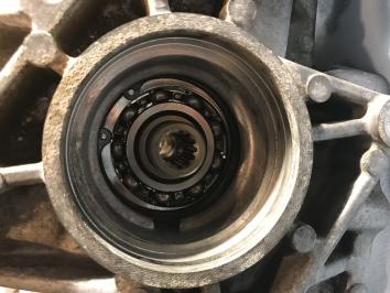

After cleaning everything up extremely well and adding back some Siper UDT to the bearings they are spinning well no grinding. No noise, no movement. I am replacing the input shaft. If the bearings seem tight and clean. Still replace?
99% chance they will be just fine! If it were my own I would likely use them, if a customers probably I'd replace them.

I just finished rebuilding my transmission and mine did not have the shim installed from the factory either. Mine had very little backlash so I did not put a shim in. Keep in mind the backlash limit is less than half a millimeter.
I replaced all of my bearings and seals in the transmission housing and being you have a new housing, for no more than what it costs, most certainly do it. Whatever went on inside your HST that broke the shaft was severe and who knows what kind of shock the bearings took. I know the job is like a giant money vac but you're doing it right. Once you get the center section together, you should be able to turn the input shaft pretty easily and have no roughness, tight spots, noise, etc. The PTO shaft will not be able to be turned by hand as it has a PTO brake. I was pretty concerned about it as I was a bit unsure of how it worked so I hooked up a manual pump to the PTO oil inlet. As soon as I put some pressure on the line, I could turn it easily. Good luck.
