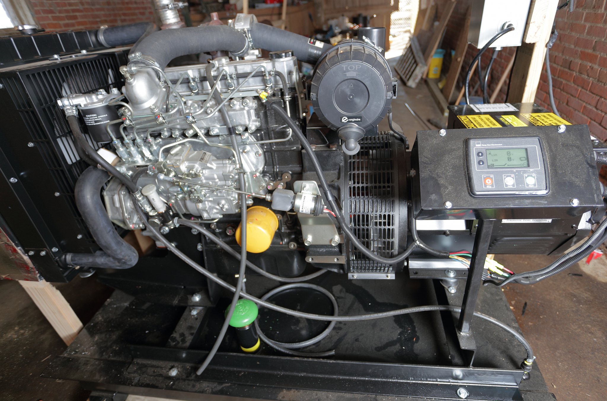

My 40 KW diesel standby generator uses an auto-start engine controller made by Deep Sea Enterprises. It handles the startup sequence including fuel pressurization and glow plug timer followed by a start command and then monitors engine parameters while it is running in case it needs to do a shutdown including temperature, oil pressure, RPM, fuel tank level, runtime hours, etc. and monitors generator current, voltage and frequency.
It is a neat little box that does a lot and retail is under $300 USD for the controller. It does make that expensive and simple combination box seem horribly over-priced.
