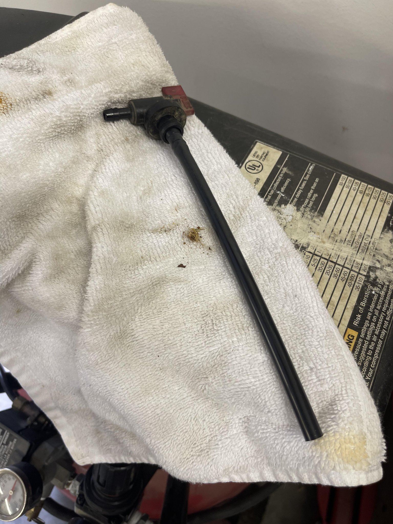

Remove the hose from the shut-off valve on top of the tank, pull the shut-off, and standpipe from the tank. The rubber grommet may come with it, no problem.
Blow backwards thru the valve, preferably with compressed air. It probably has grass debris in it.
To reinstall, remove the rubber grommet from the valve and insert it into the tank, then push the valve back thru it. It will snap into place, it's easier with a little lube at the valve. Reinstall hose and go mow.
Sure enough, I had a little wad of crap come out as well. Was fighting what I thought was an overheating issue as it was losing power/dying under heavy load (dynamic turning, mowing quickly, etc.). A little more googling found me here and after a 10 minute fix we seem to be in business running better than ever!

I saw the tip about removing a tube and using a compressor to blow it out. I would like to try that but I don't know enough about my mower. Can someone be more specific with instructions? Thanks so much!!
Lift up your seat to expose your fuel tank. At the rear find the fuel pickup which has a red shut-off valve on it (see photo in post above of part). Remove hose from barbed end then pull assembly out of the tank. Blow compressed air backward through the tube and you'll probably get a little wad of grass/gunk/etc. Put the grommet back into the tank, then put the tube back into the grommet. Reinstall fuel line and you're done.
Would you happen to know the part number for this and/or the grommet? I can't seem to find a diagram with this, but it is definitely the problem! My grommet disintegrated!
