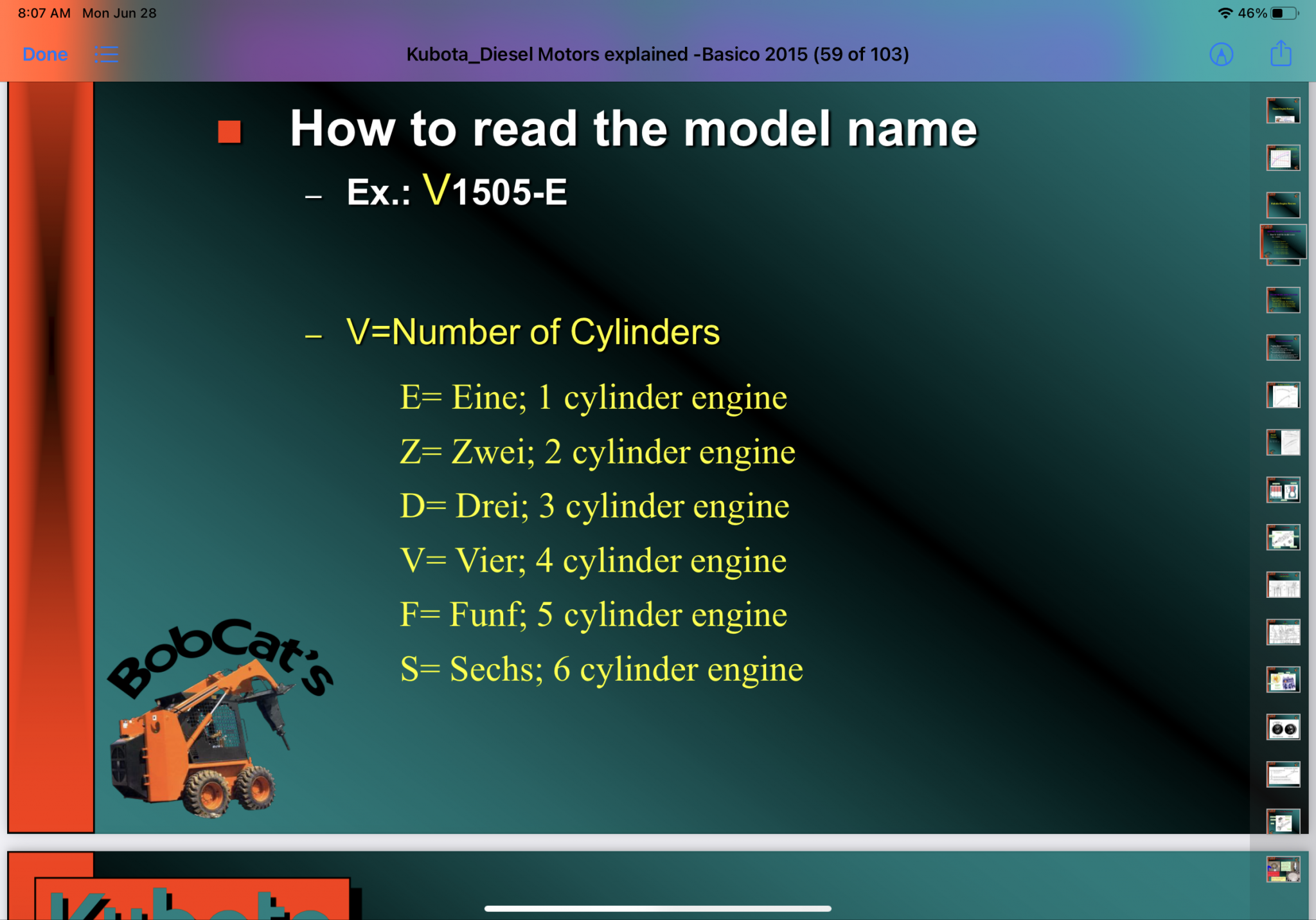

It may be helpful to know that Kubota engine models are based upon German Numeral-Terminology:
(Japan and Germany have historical and engineering-background connections):
