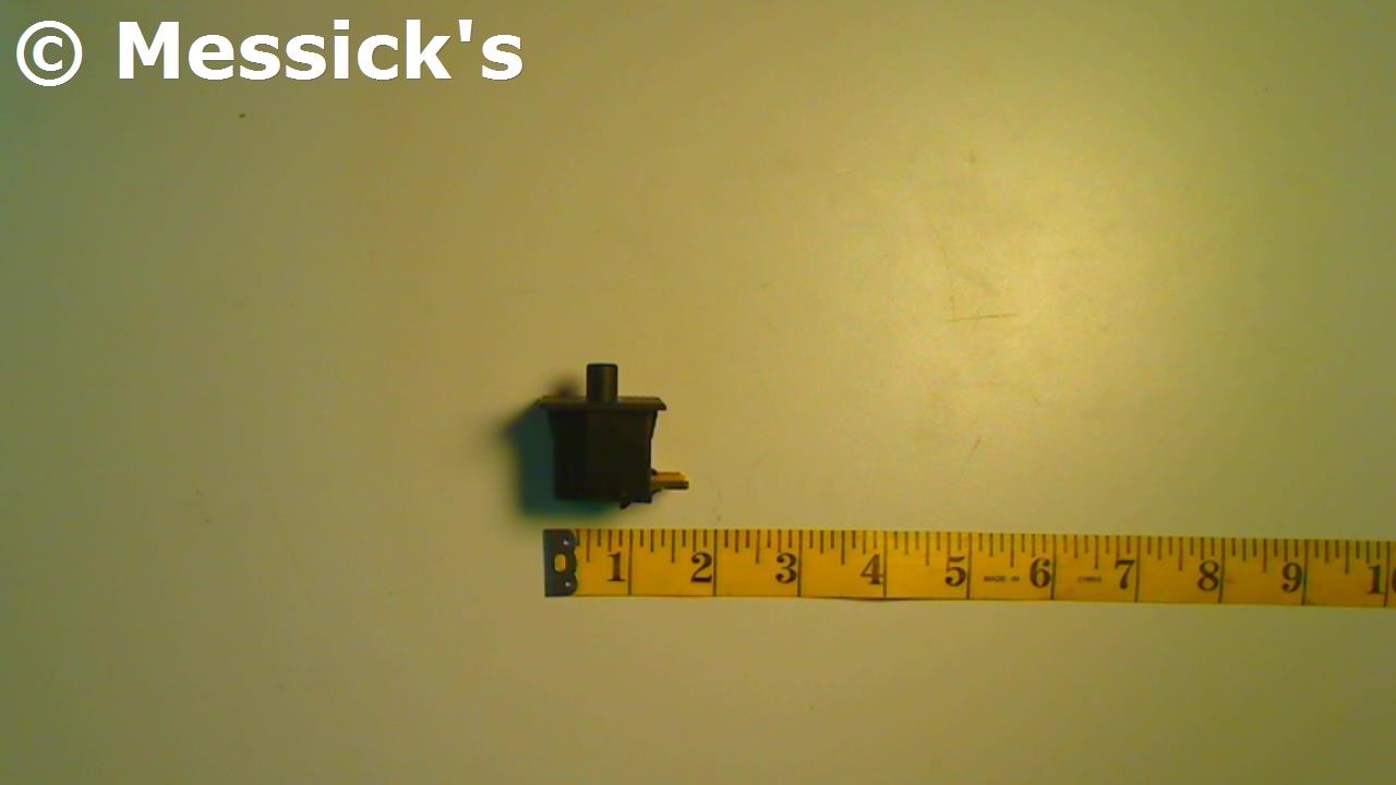

There appear to be two different models: Z421KWT , Z421KWT-3.
However, both appear to have the same simple seat switch that is not built into the seat

If you look carefully at the bottom of the seat, most of these switches can be removed easily for replacement.

The seat safety switch is readily available separate from the seat and very simple to replace.
