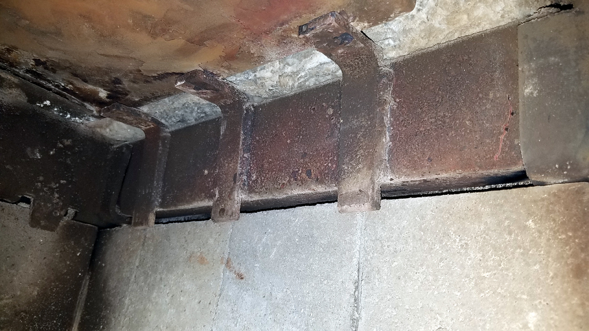

I burn wood in a Pacific Energy (Canadian company) wood burning stove over the winter months to heat the entire house. I've been in this house for a little over 8 years, and the first year had to replace the baffle in the stove since it was in very bad shape. The local fireplace store told me that the original owner had been running the stove way too hot which had damaged the baffle. It was around $350 for a new stainless steel baffle if I remember correctly.
Last winter I was aware that the baffle/brick supports on either side of the fire box were in bad shape too so once again I called the local fireplace store and left a message to request a call back with pricing and availability. After two weeks I hadn't heard from them so stopped by the store. The attitude of the "workers" there was so bad that I was already regretting the decision to go to the store. I was told that new parts were made of stainless steel sheet metal, and that with shipping I'd be looking at $300 or so, and that the parts would take a while to show up, and they would only order the supports if I paid in advance. I told the employee that I would make my own supports and walked out. That was last winter.

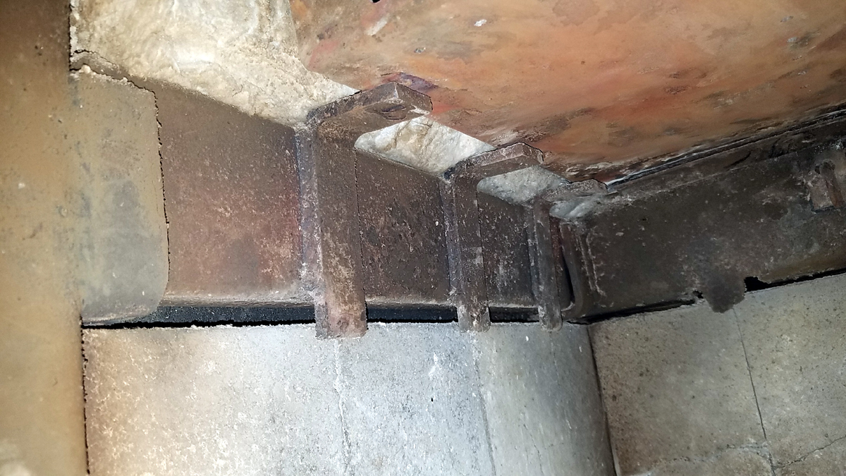

So this past week it's started to get cold and my Heeler likes a nice fire so I finally got around to making some new supports. I used scrap material that I had on hand and it took all of 30 minutes to make up the new supports shown. I looked at the original brackets and figured out what they were doing and why they were made the way they were and decided to go in a different direction, one that would allow me to make these up cheaply and quickly every year if necessary.
I now have a nice fire going and my Heeler is happy. If these supports last the season that'd be great. If it looks like I need to modify the brackets for next year I'll do that in the spring, unless there's a catastrophic failure this winter. :LOL:
Old supports with new supports ... it's kind of obvious which are which.
Fireplace back together.
Nice fire going!

Good for you! Looking at the pictures the old ones look like regular steel? Nice looking welds btw!
Thanks, and I think you're right. The rectangular tubing I used is a bit on the thin side so if I have to revisit this I'll upgrade to some thicker tubing.
I worked as a welder (coded/certified) for many years, and although I've lost much of the skill I had developed over those years, I can still put down a good weld when the conditions are in my favor.

It's been close to a year since I started this thread. Last night I had the first fire of the winter season, but before I did I removed the baffle, checked the flue and inspected the baffle supports that I welded up last year. I had a fire going almost 24/7 for four months last winter so around 2,880 hours of burning. The pieces I made look great with hardly any loss of material. They should last at least another five years and maybe more.

The metal from the burnt out parts look like cheap, thin material to start with. Reminds me of what comes to the US on a boat! Your fabbed up piece has enough metal to last several years. Wonder what the weight difference between your and the factory one (new) would be?
I don't know if the supports I show in the first post are original, but if they are, they lasted 20 years or so.
The replacement parts that the local fireplace wanted over $300 for were stainless sheet metal and if my memory serves maybe 10 or 12 gauge. I'm confident that the pieces I made up are quite a bit heavier than the "upgraded" stainless parts.
The back piece that supports the rear of the baffle could be replaced, but it's not in terrible shape and actually looks better currently than it did in the first photo that I posted.
