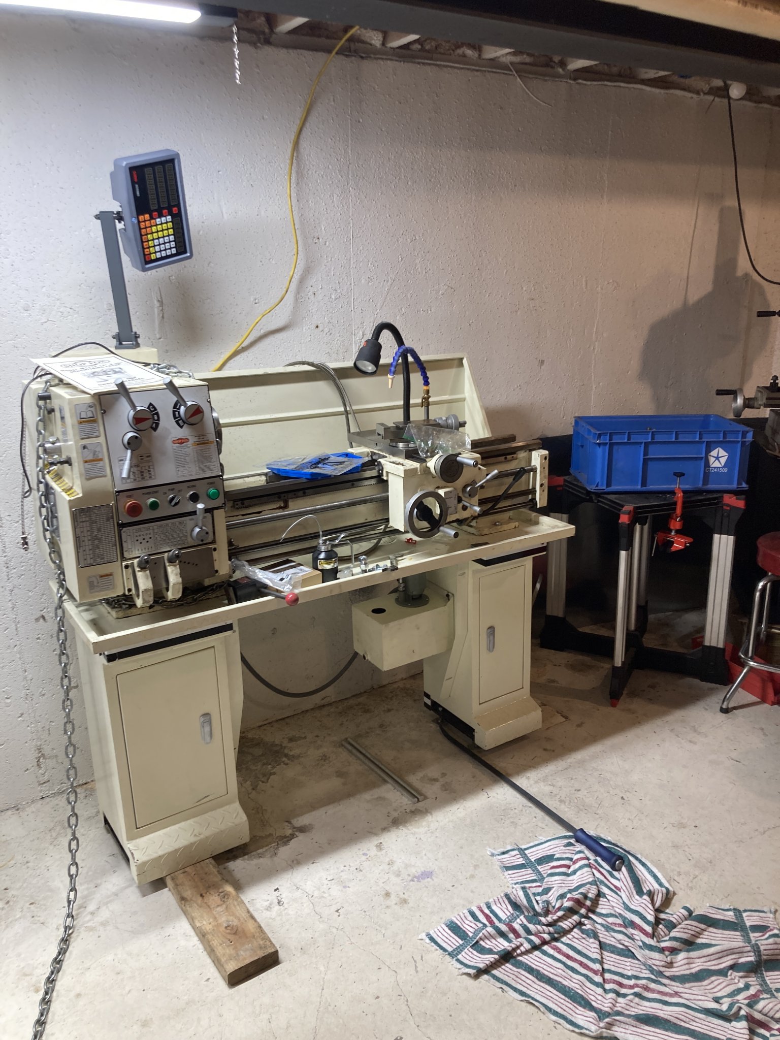

I finally got around to moving the lathe into place, but as you can see its kind of dark and the old "curly Q" light bulbs kinda suck. I think they get worse as they age, but it's one of those things that get worse "incrementally" so its hard to notice.
I did start to replace the "curly Q" style with the newer LED style below.
But even that was only marginally better.

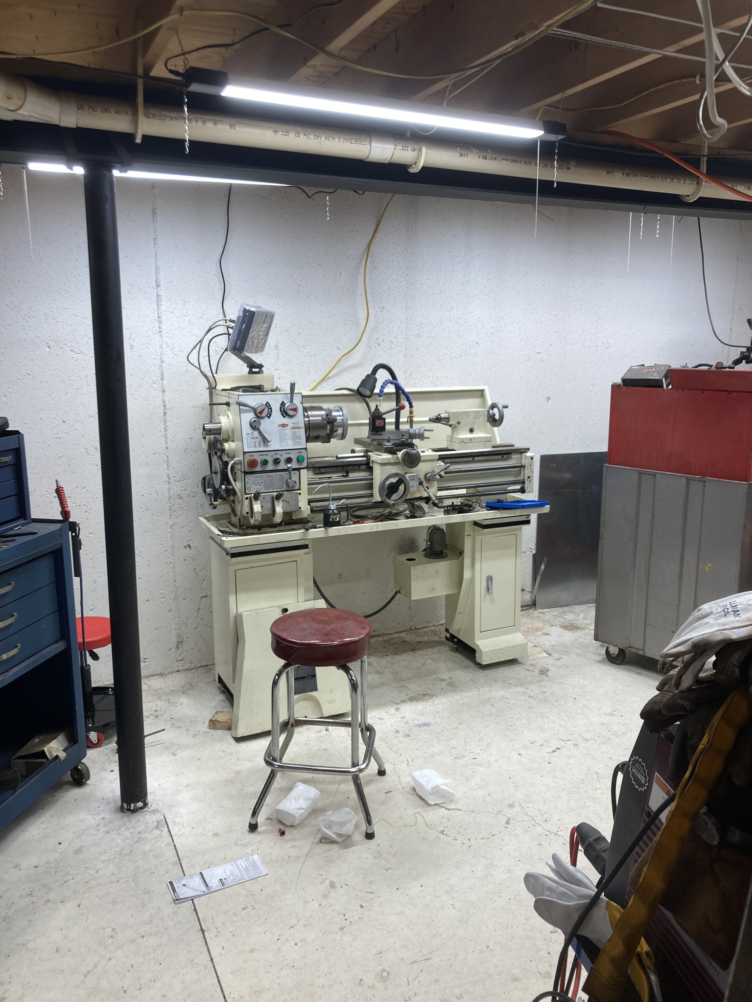

I decide to go get a "few every month" and "the main shop area" got the upgrade last week.
Even though that light is out you can tell there is a Yuge difference.

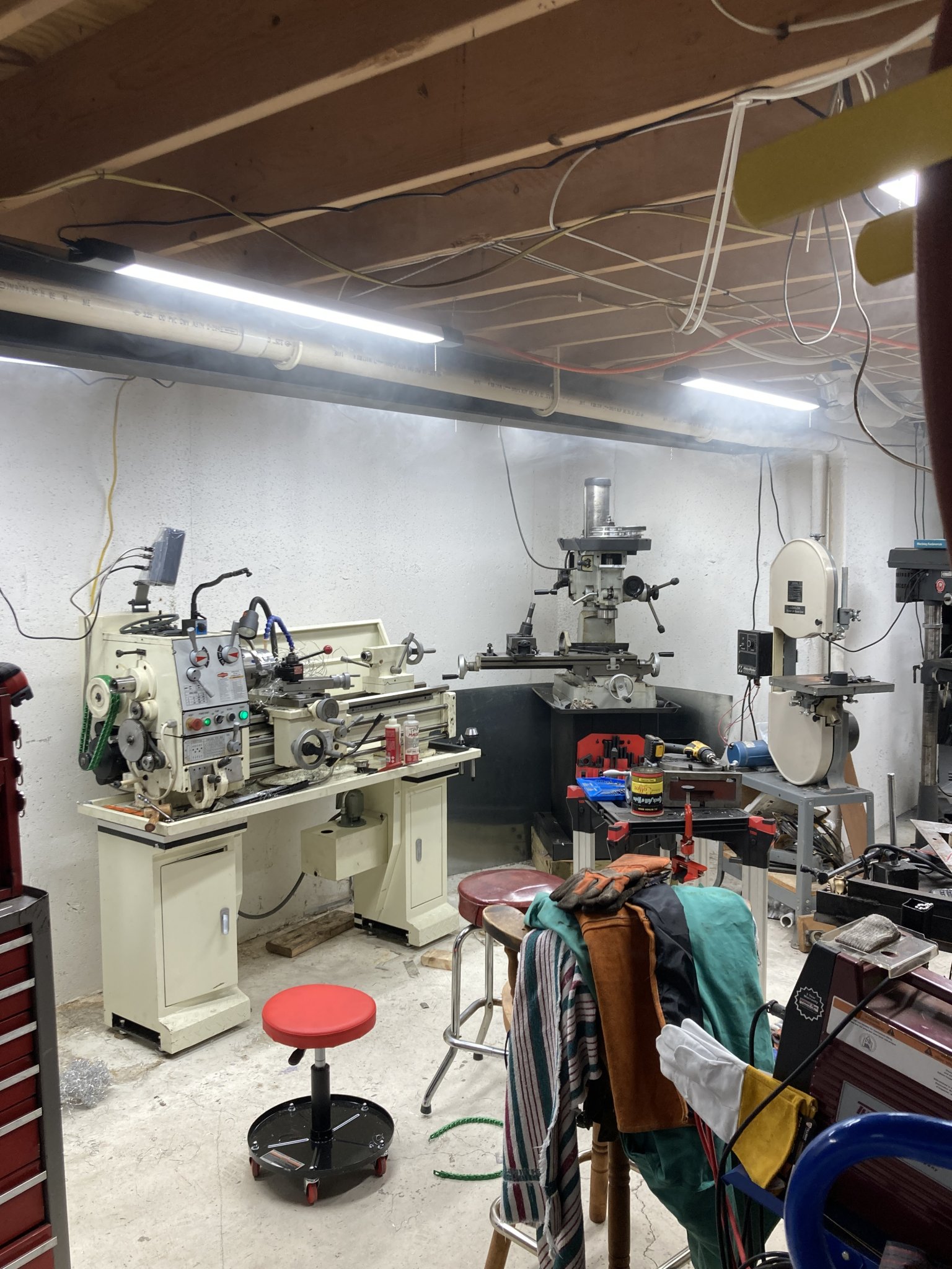

After I got them all installed, I was really quite pleased with the results.

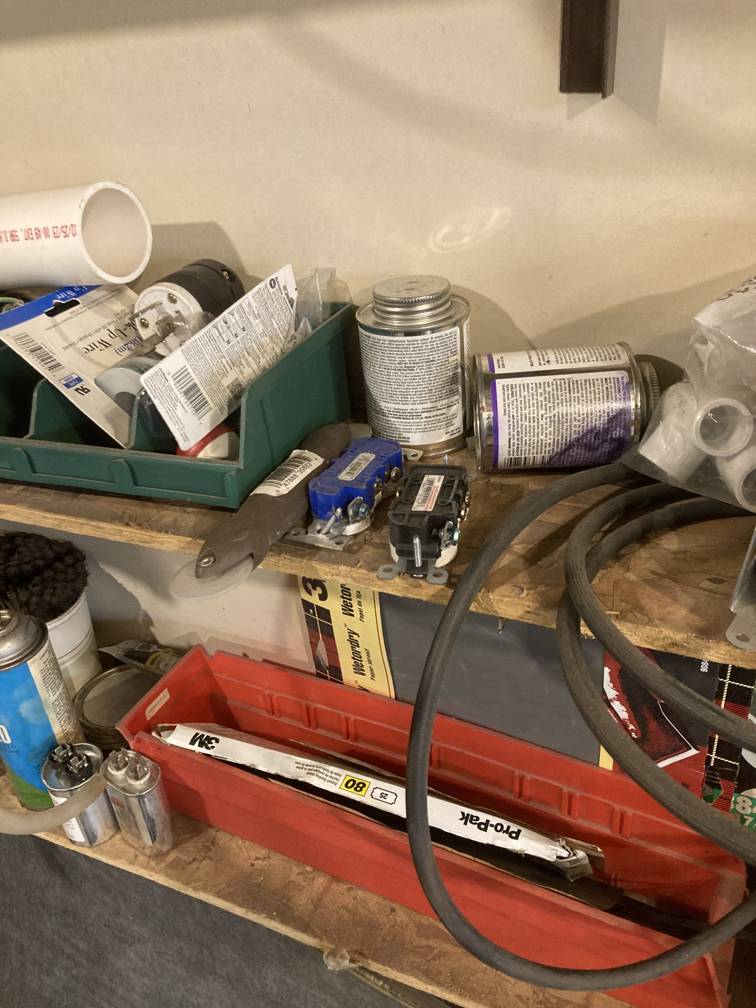

I was going to just use those "screw in outlets" in the already existing bases, but found 3 or 4 "donor outlets" on the shelfs.
And this is exactly why almost all of my shelving is only 5 or 6 inches deep.
There is no way in hell I would have found them by "digging around" ....

Well now that I can see a bit better its time to "get at" the lathe and start making some chips.........
I did go around and trim off al the dangling attachment chains and "pull cords".

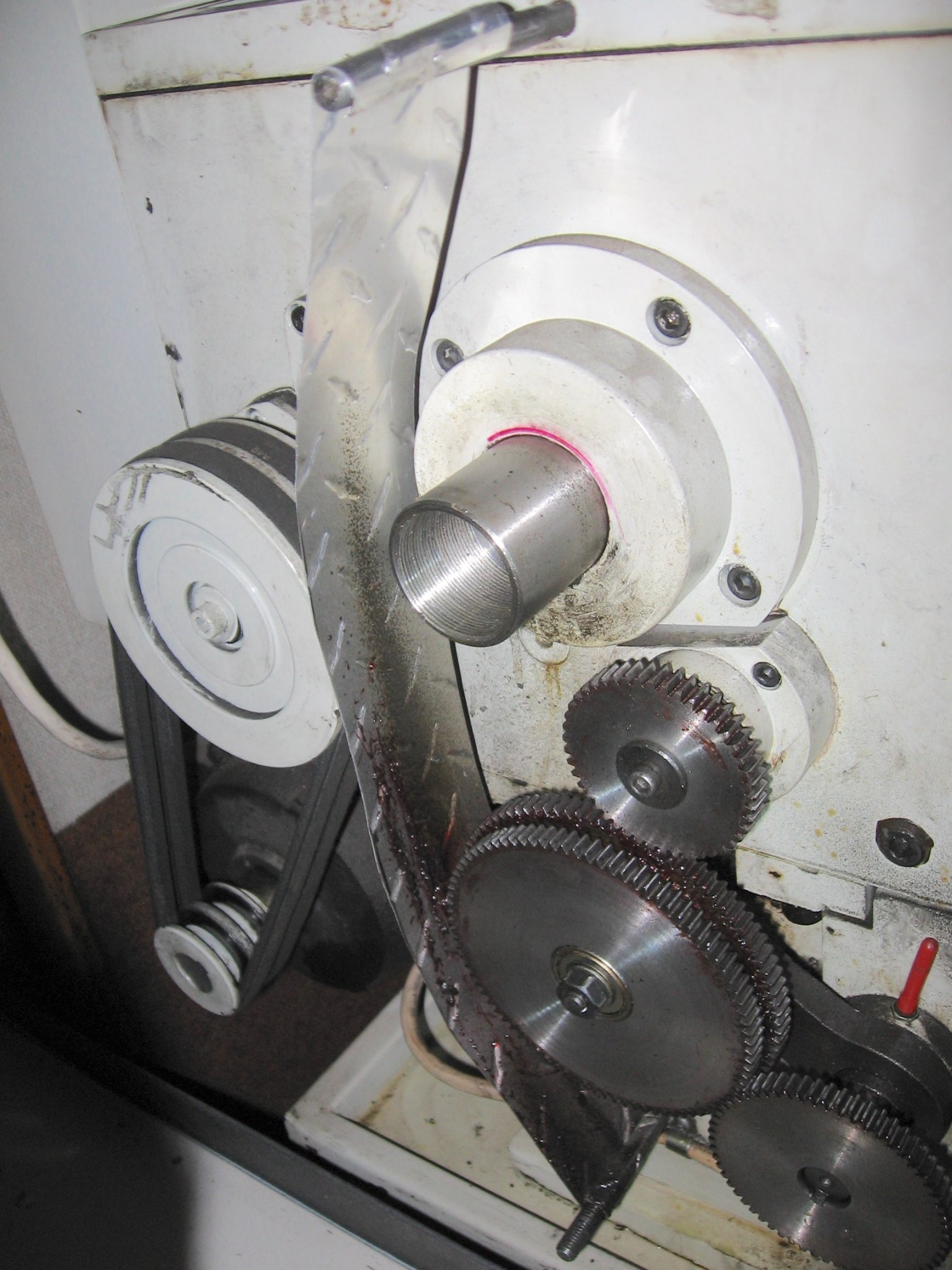

Ok this requires some more investigation........so i pop off the "gear cover" and the words "What the Fork?" (not fork though) came dribbling out......
Apparently the previous owner, for whatever reason, tried to "gear down" the lathe so it would spin slower.......I have no idea why or what reason.....but I am feeling "better" now that I have have a "obvious reason" that seems to be fixable.......and easily "un-done".....
Heres video showing how "Loosey Goosey" the belt was
https://rumble.com/v66gaj4-lathe-surprise-3-problem-found........html
Now I just need new belts.......Hopefully.....

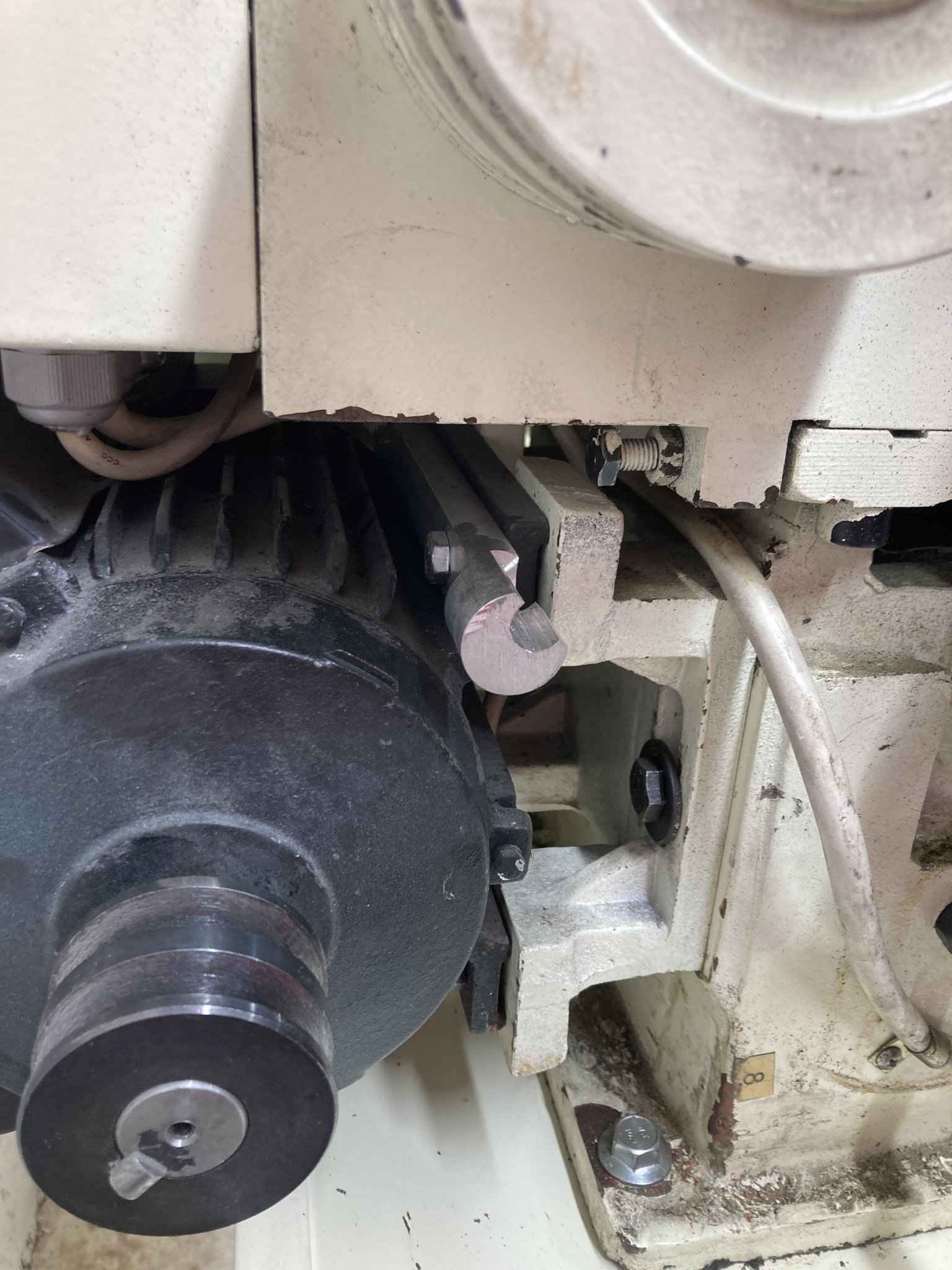

I removed the "Mickey Mouse gearing" and installed my new "linked belt"
then the 2nd one.
Now to tighten her up.

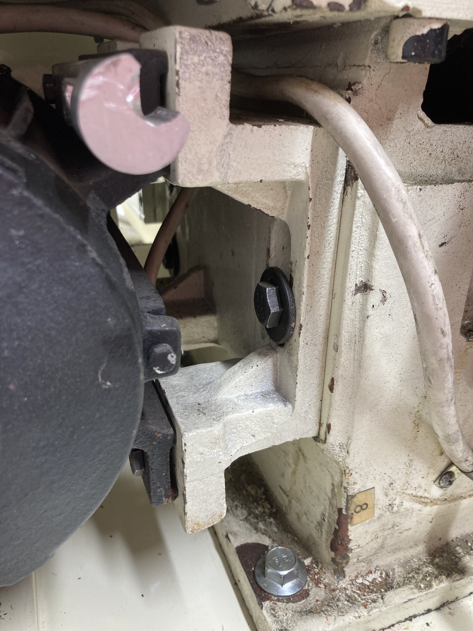

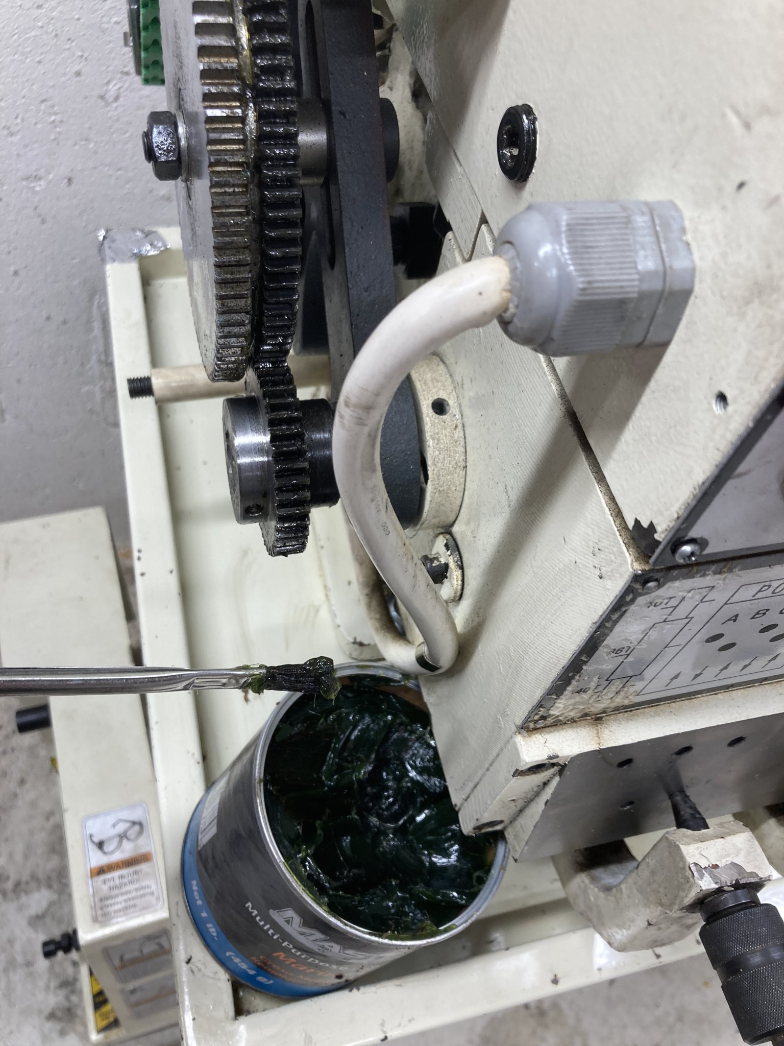

The "flat rate mechanic" in me, always tries to remove as little as possible whenever I do basically anything, but these adjustment bolts are well buried.
So I try to reach them through the hole I cut for the splash guard
What the hell am I doing?
I mean really man, its 2 screws and Bam its open and easily accessed.
Ok now it's time to make sure the belt is "aligned".....at least the best I can do for now.
So I grab out my "precision level" LOL....JK but its the best I have for now.
I figure it should be good enough to test for now.
so I measure the "main pulley's angle"
Then the motor pulley.
after some "jockeying" I get it "good nuf" for testing the lathe......again.

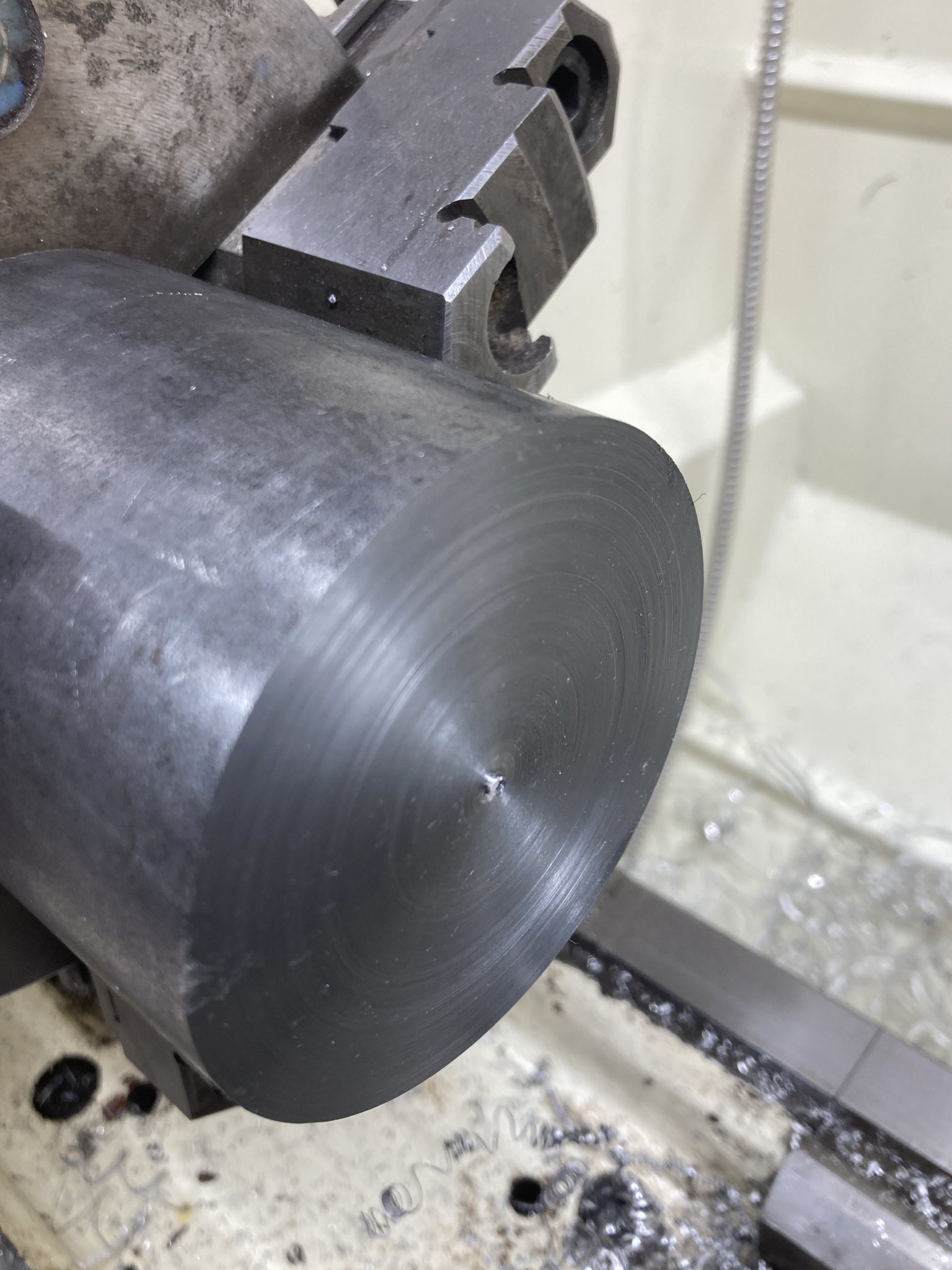

OMG, this thing is awesome!!!!!!!!
This is my 1st facing cut and it's almost 'mirror' smooth.
Then I start 'testing"
I kept increasing the depth of cut and speed until the finish got worse.
I think this was at 1400 rpm and .070 DOC
This baby blows my Craftsman away!!!!!!

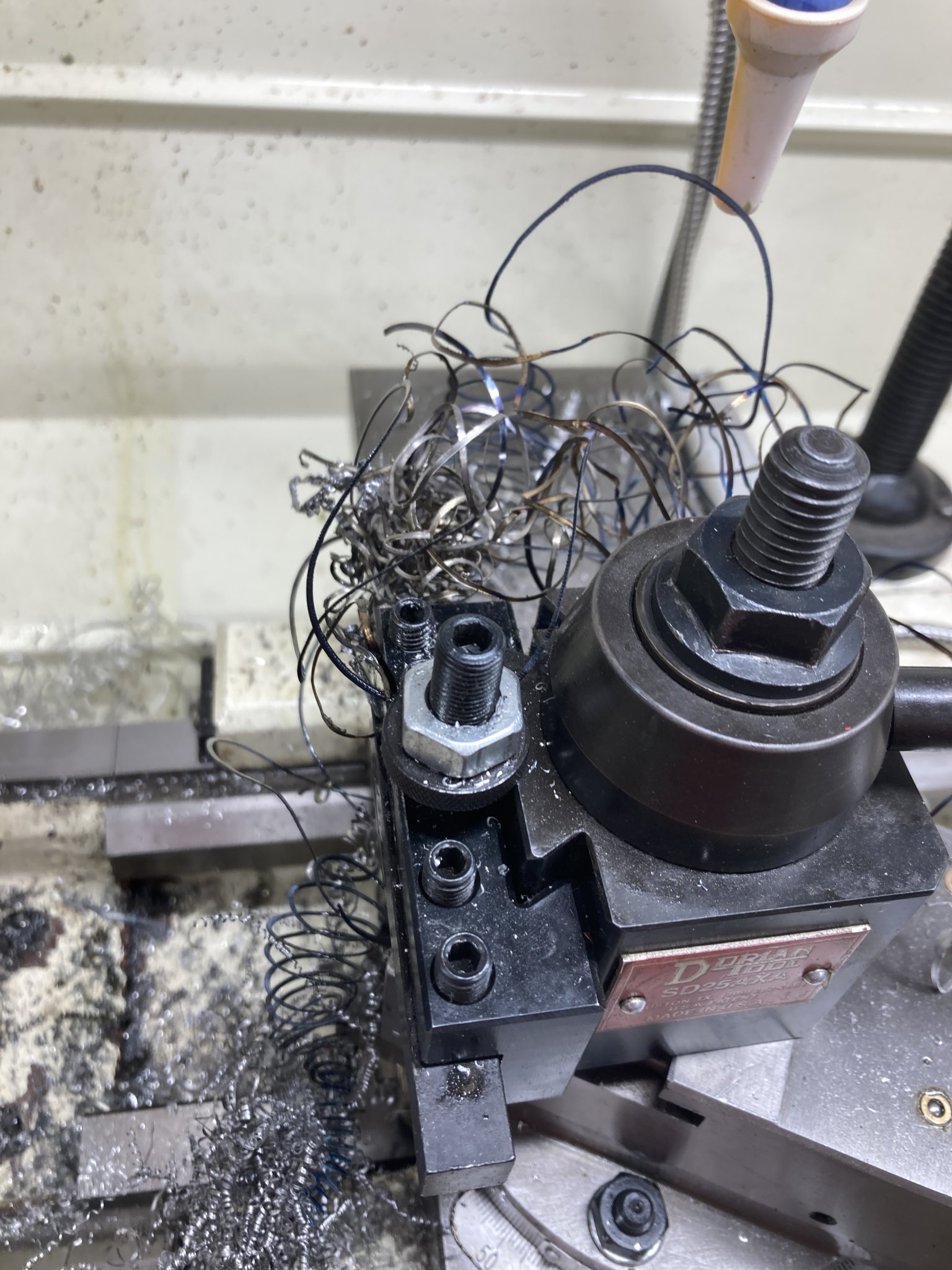

Now for some steel.
This is where things get tough.
According to my amazon account this is A36 CRS but I can't get a "really good" finish to save my life.
I keep trying to adjust my speeds, feeds and DOC, but I'll be damned if I can get a 'nice' finish.
At some point, I take a real deep cut with an aggressive feed rate; it generates a little smoke and stops the machine.
This is where it starts biting me in the a$$.
Now I stop, back it off, then hit the insert with a stone to "freshen" the cutting edge and go at it again; But for some reason I start "breaking HSS inserts" as soon as I touch the cutter to the piece.
I am not sure if what happened, but it appears as if I "work hardened" the test piece by taking too aggressive of a cut?
Anyone ever heard of that?

That stink will get up in the house and soon your wife will kick you out on the street. Once it absorbs into the wood it will never go away. Get a fume extractor so 2 months from now you don't wind up homeless 😬.
7,833
3,061
Glad your detective work paid off.
Mine would wind 1" rebar into a coil spring at 71 rpm.
I was stumped until you showed how loose the belt was, as cutting the speed in half should have made it more powerful, not less.
I'm guessing PO wanted to do some very large part or an imbalanced part or wanted to take a massive cut in something hard.
Maybe, if this was the result, that is why they sold it. (y)
On the plus side, your gear box is much quieter than mine.
As for work hardening, absolutely.
Depending on the material, heating or dwelling can absolutely cause work hardening, and sometimes hardening just in spots. (sounds like your symptoms)
When I worked in production machining, we had an alloy called Ni-Span-C Alloy 902 that would work harden if you took too light a cut, too heavy a cut, cut without coolant, or dwelled on the part. (or looked at it cross-eyed)
Once work hardened, it would eat diamond inserts.
The only way to proceed was to cut the material off & start over.

A mod you might consider:
Bend up a piece of light sheet metal to shield the belts from grease/oil slung off the gears. My belts were ruined when I got it, saturated with oil. It's an easy , cheap fix for a big return.
Glad you are making progress!
Thanks man!
I am pretty sure I "work hardend' it.
I was just playing around with the machine kind of "getting my bearings" type thing, but I need to look/study more closely about turning speed and feed rates.
That "grease protector' will be #1 priority this weekend. Great job and thanks for posting that.
The funny thing is that I put a dab of grease on my gears and experienced the same "slinging" phenomena.
Then I ran it for a few seconds......
Your "grease slinging protector" is a great idea.
I would like to add that my gear box was pretty loud after I got the belts installed, so I used a "trick" that I learned from watching that guy "Mr. Pete222" (aka Tubalcain) on YouTube.
If anyone is interested, he shows how he uses an "index card" to space his gears. I just used a piece of regular 8.5 x 11 piece of paper to shim mine. Its at about the 4:38 mark.
This is the 2nd time I have used this "trick", and it really does a nice job quieting the gear train down.

Work hardening is a rare phenomenon that is often used when a machinist is confused. My guess is that you are using cheap steel inserts and should be using carbide to get the speed and finish you are after.
Yep, that describes me pretty well.
