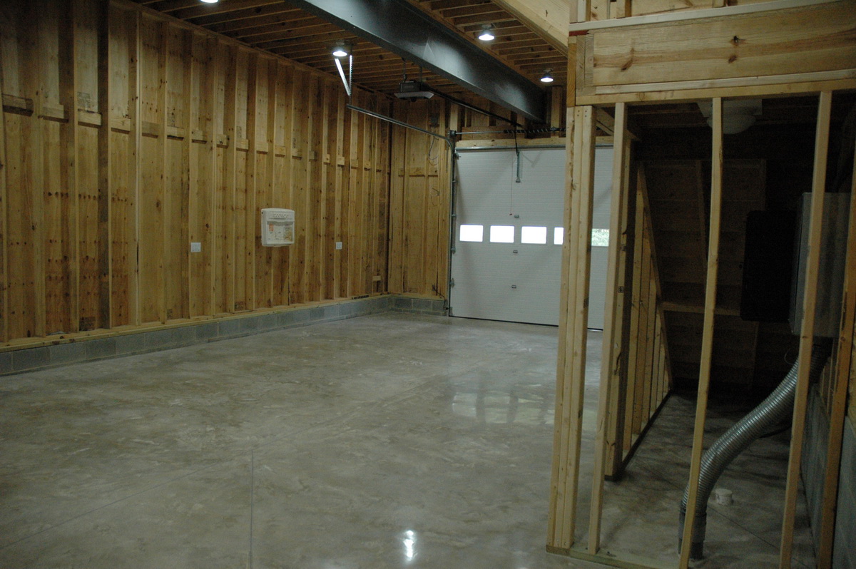

Dead flat polished concrete floor.Does take me five minutes to take off and two to put on use a dolly.
