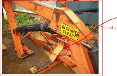

Now that I'm with the tractor, all my pics are at home. But I found this pic online:

Based on the advice of D2cat and Lil Foot, I beefed up the front bracing by adding a second 1" tube on each side and adding some 2-1/2" x 1/4" angle to the 3" x 3/8" flatbar bolted to the bumper. I think I screwed up though -- in retrospect, I think detaching the fell as a unit would be easier if the angle was flipped around the other way, with the horizontal flange above the bumper. I'll probably cut it off and flip it in the future. The grade 8 bolts attaching it to said bumper are just wound into tapped holes. I'll get some a bit longer and back the threads up with grade 8 nuts.
