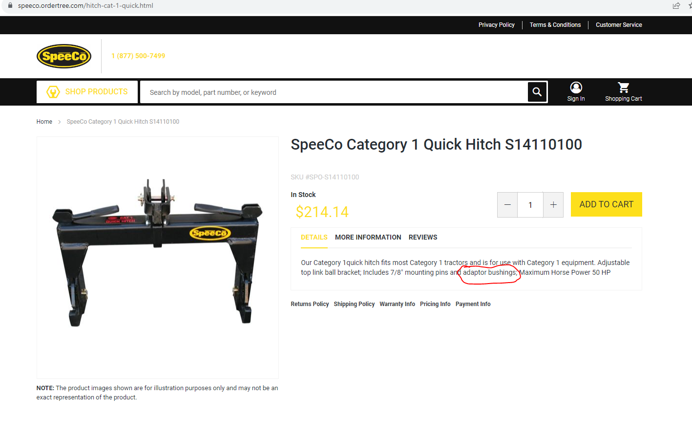

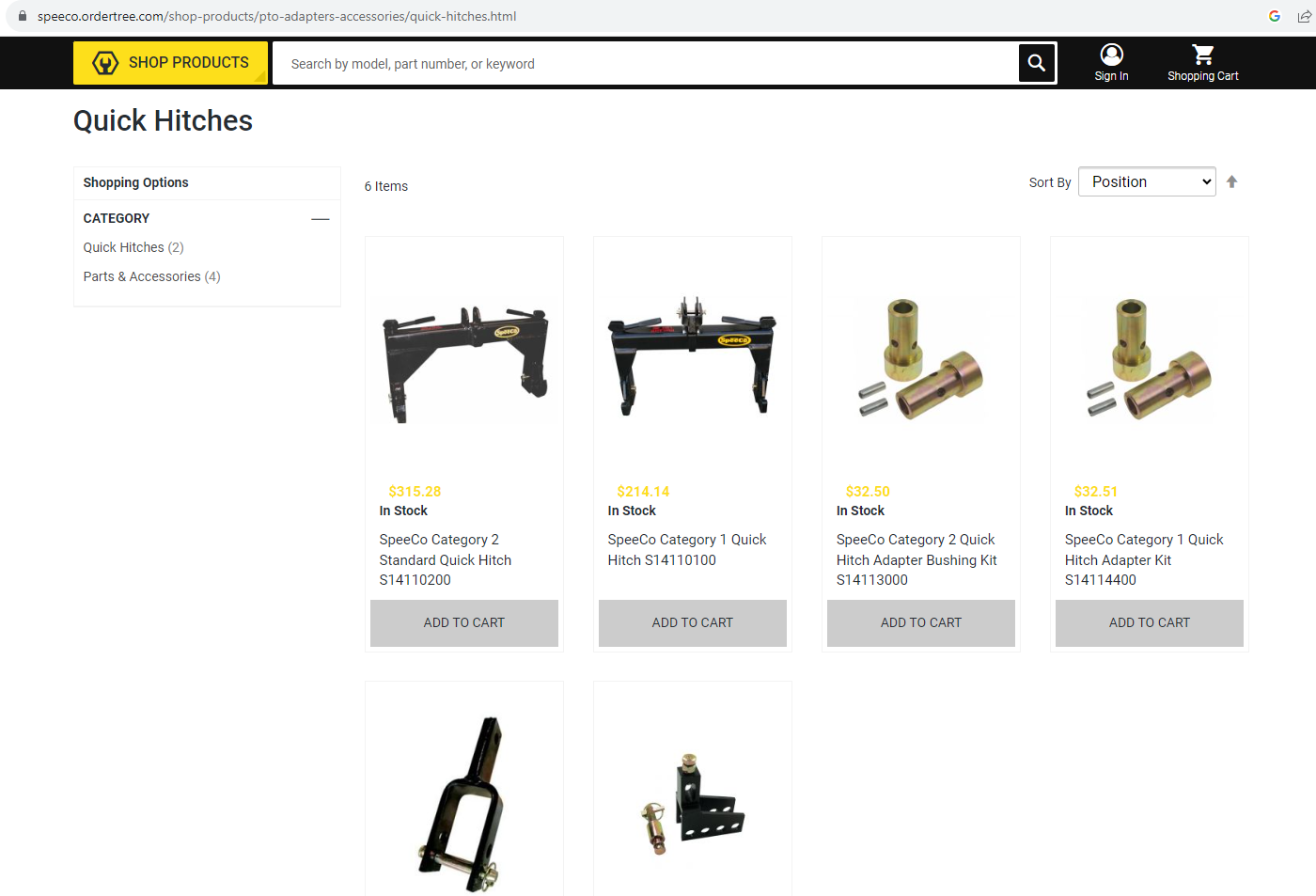

Some say they don't require bushings but their web site has the bushings for sale with the hitches??

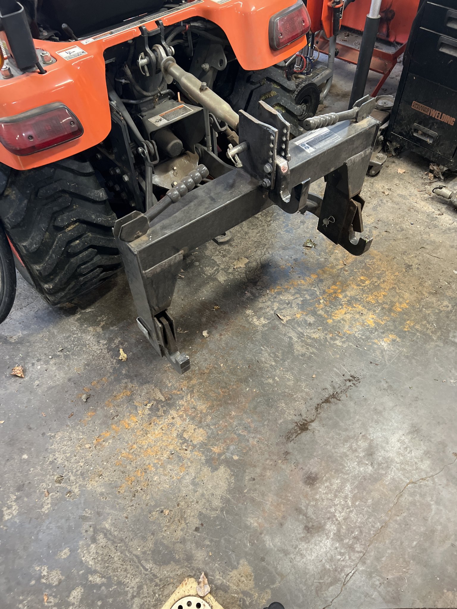

For what it’s worth I have a Harbor Freight QH. Had it for years at $80 with coupon.
I did do a couple alterations to it. Last year got @Kennyd4110 ‘s extended hook, which has been great! It would have fixed some of the clearance problems I had years ago.
Haven’t looked at them in years, but the HF QH looked remarkably similar to about half of the QH’s on the market at the time….
I have 4 3-PH implements. 3 are newer and all 3 fit the QH. I have an older box blade that I did have to redesign a little.
All fit on the QH as it sets, but I do have to adjust the top link a little depending on the implements I’m hooking to. It’s a 15 second adjustment.
